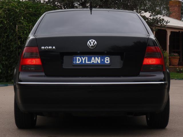

          Car: Bora 2lt FWD
          Front: 17x9 et20 (after 15mm adapter) 205/45/17
          Rear: 17x9.5 et19 (after 20mm adapter) 215/45/17
          Arch height to ground Front: 23.5"
          Arch height to ground Rear: 24.25"
          Fenders Rolled: Front only
          Fenders Pulled: No
          Camber: Front No / 1deg extra in rear (2.5deg in total)
          Comments: Less (none!!!) rubbing then the teledials due to more space on inside of wheel.
          want it a good .5" lower all round, but need to notch the front drivers side or get a smaller driveshaft first. Drivers side only has 5-7mm between the shaft and chassis, and Id say 3mm of that is because of self notch
          more pics soon

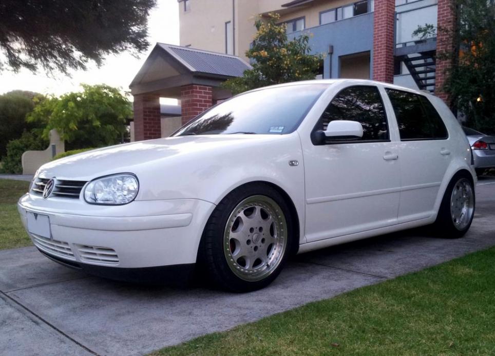

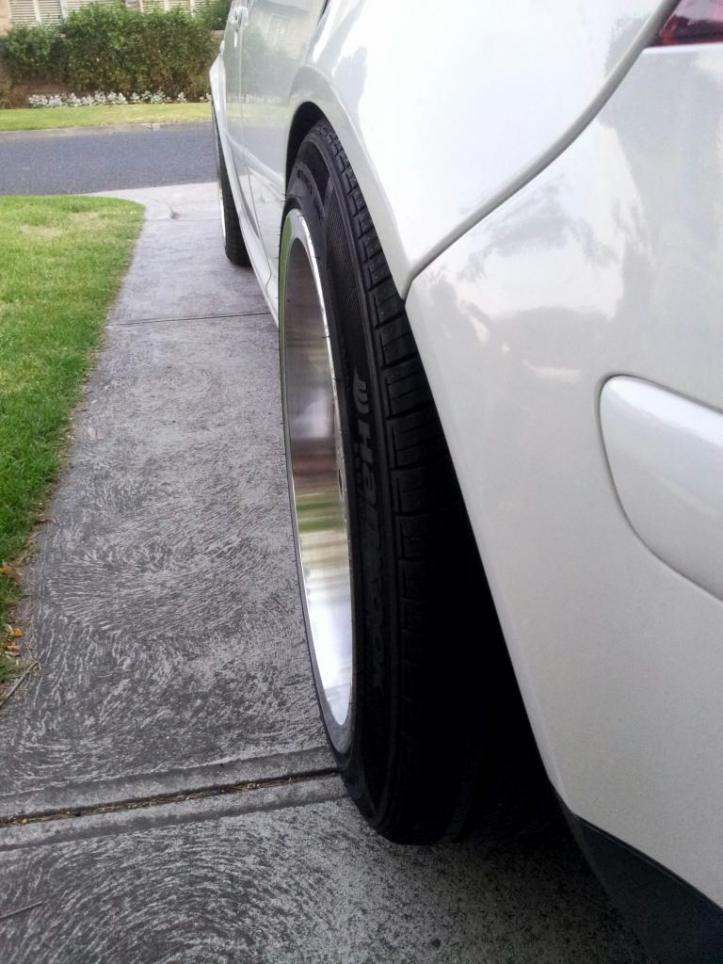

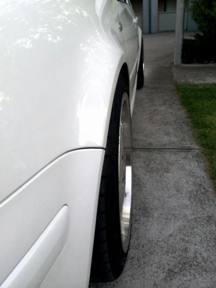

                  Finally here are the Supernovas I got from Dylan a while ago still need more more but they are on there way.
                  Car: FWD
                  Rims: Supernovas 5x114.3
                  Front: 17x8 et25 with 20mm adapter GT Radial 215/45/17
                  Rear: 17x9 et27 with 15mm adapter Hankook 225/45/17
                  Arch height front: 614mm
                  Arch height rear: 617mm
                  Front:
                  Rear:
                  The daily
                  White 2001 Mk4 GTI
                  GIAC stage 1 - ECS stage 1 clutch & 14lbs Flywheel - 42Draft/Remus Exhaust - APR R1 dv - N75J - K&N

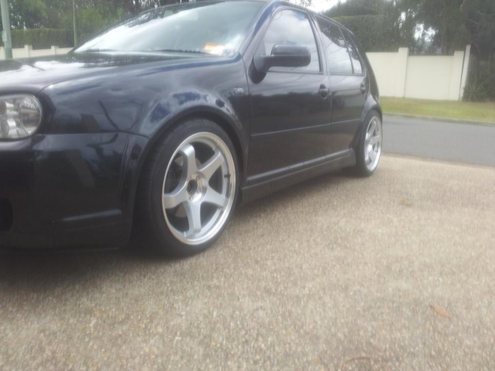

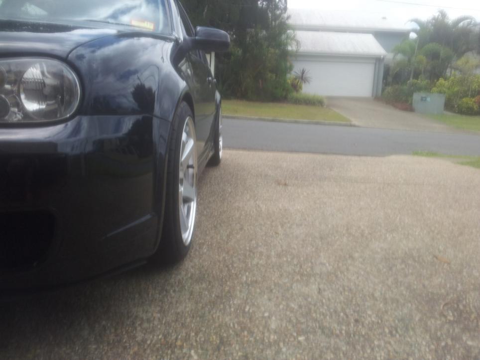

                        Car: FWD
                        Rims: Denvers 5x112
                        Front: 17x7.5 et51 with 25mm adaptec hub centric adapters
                        Rear: 17x7.5 et51 with 30mm adaptec hub centric adapters
                        Stock ride height (for now...)
                        CURRENT: DBP Mk4 Golf .:R34 no. 187 (WOOKY)
                        Mods: C2 Motorsport Custom Tune | 268/264 schrick cams | Eurospecsport forged rods | JE forged pistons | Miltec Headers back | Higher compression | Engine fully ported | polished balanced crank | Sach Motorsport clutch | Single mass flywheel | Wavetrack LSD | Shortened 4th/5th/6th | etc etc |
                        • #57
                          Fill out the template as others have done dude, otherwise its a bit pointless for the purpose of this thread.
                          Spot some Adaptec adapters :p
                          Bora gone
                          Vento VR6
                          MKIV GSW TDI
                          7P Touareg TDI
                          • #58
                            Done and done, yes thanks for the recommendation, very easy set up and the 25/30mm combo works great
                            I couldnt find specifics for torque ratings for the adapter so i torque'd them to 120Nm (90 ft lb), that sounds right???
