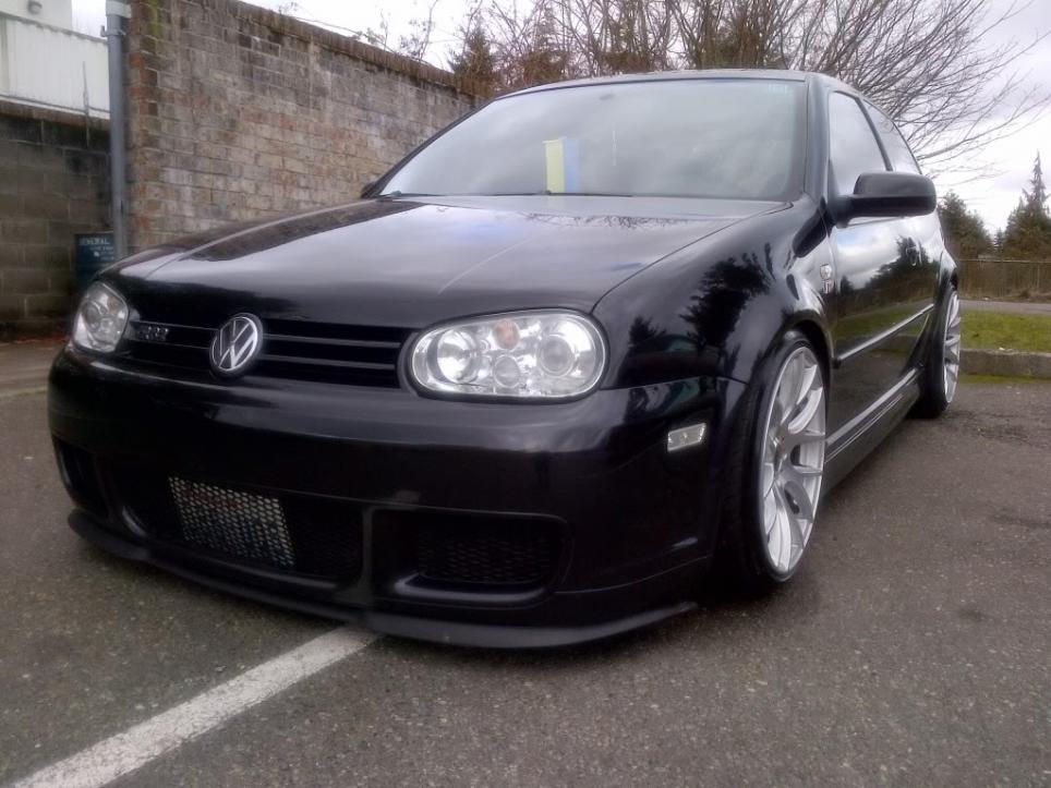

                    Does anyone know if the MKIV R32 has similar rear suspension setup to the Bora 4mo's?
                    This is a R32 with a 18x9.5" Miro 111 wheel and a 15mm spacer.

                    • Originally posted by JustCruisn View Post
                      ^^ wow I likes the rear but not the front.
                      Yeah love the rear fitament! I'm planning to buy those wheels in Matt black to suit my black Bora
                      If you look at it from the front, I don't think it looks bad.
                      This guy has used a 18x9.5" wheel on the back with an offset +35. A 5mm spacer should help me achieve that?
                      I'm guessing being a non-4wd Golf the back end probably has more space than a Bora 4mo?

                        no point in comparing it to a FWD, completely different game out back.
                        Front would be better with a small spacer and maybe a little bit higher. Could do with a wider tyre as well imho.
                        R32 is the same so of clearances as a 4mo bora.
                        no point looking at other cars unless you know the suspension setup and how low they are.
                        most of the above will be lower, so geometry has changed so much it becomes irrelevant.
                        put your other wheels back on, use a offset calculator and a ruler and should be able to easily work out if itll work.
                        Simons can fit the 9.5et40 due to his car being a bit higher (not sure where yours is at) and his control arms fix any camber, there for giving more room on the inside of the wheel.
                        check some of the other 4mo guys on here. thestu and kapowww arent running adjustable control arms from memory which will make it similar to yours depending on height

                        • Originally posted by RubAVeeDubDub View Post
                          the rear track on a 4mo is about 10mm less each side then a FWD car.
                          9.5et35 looks about right on the rear of that.
