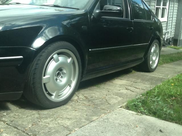

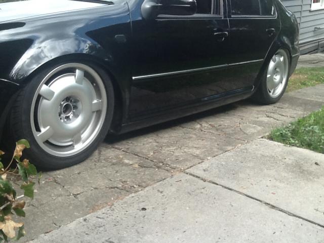

              • Iv done two to show the difference between heights and how much difference it can make even over a 2.5-3" drop
                excuse the photos. measurements were taken on level ground, not enough room to take pictures there.
                Car: Bora FWD 2lt, aired out
                Front: 17x7.5et30 215/45/17 good year
                Rear: 17x7.5et30 215/45/17 pirelli
                Arch height to ground Front: 21.75"
                Arch height to ground Rear: 22"
                Fenders Rolled: Front only
                Fenders Pulled: No
                Camber: Front 1deg, but due to being pulled from the bottom it makes offsets more aggressive (approx the same as running a 10mm spacer/ 1deg extra in rear
                Car: Bora FWD 2lt, approx ride height
                Arch height to ground Front: 24.5"
                Arch height to ground Rear: 25"
                Fenders Pulled: No
                as you can see front cambers out, but sucks in the lower it goes
                Rear stays about the same due to the fixed beam, it just rolls forward into the guards
