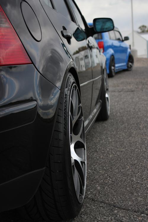

                    • I will be investing in a set of camber adjustable arms. Especially since I'd like to go lower. But before I go low, I'll need to get tension adjustable coilovers as my car compresses too much over driveways/speedhumps and i'm finding the back exhaust tips smashing against my expensive Oettinger rear valance (already has 3 massive cracks around the exhaust).
                      Back to getting a set of the overly commom Miro Type 111's. Not going to get the 9.5" ET40 due to it being a potentially very tight fit.
                      Planning to get a set of 4x 18x8.5" ET35 wheels instead.
                      Off my calculation, with an approx 5mm spacer my fitament should be similar looking to this:
                      ↑ That is a 18x9 ET30 with 225/40 tyre.
                      Compared to fitting a 18x8.5" ET35 on my bora 4mo -the wheel in the picture has 1/2" more width (12mm approx), and tucks in 5mm deeper with a ET30 offset versus my ET35, totalling 17mm difference. Dylan you said the rear track of the 4mo pushes wheels out 10mm more than a standard fwd bora so I'd end up with 7mm deeper than the wheel in the picture. Add a 5mm spacer and we're only talking 2mm's difference.
                      Is my thinking right?
                      Thanks again everyone for your help! Legends!

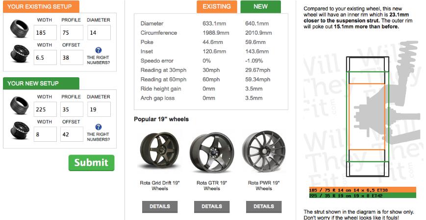

                            • Hi guys just after some thoughts on a set of wheels I've found and was wondering if they will fit my MK4 1.6L Golf.
                              They're Lenso LS5 19x8 in Hyperblack with a 5x100 Stud Pattern and +42 offset.
                              I found them today and they are at a price that is worth thinking about.
                              Yes i also know i will capture some unwanted attention with these being a p plater.
                              Lowering will be on the agenda in the near future.
                              Heres the fitment details of what i can gather.. with me currently running stock 14s at stock height.
                              Cheers,
                              Nathan
                              __________________________________________________ ______
                              MK4 GTI - Reflex Silver - <<<Click for Build!<<<
                              -Previously Owned a MK4 1.6L Golf - Reflex Silver
                              • They'll fit on the car Nathan, but not sure if they'll clear coilovers (if you're running them) with that offset. Also, the ride on 19's can be a nightmare and unless the car is low they can look silly big
