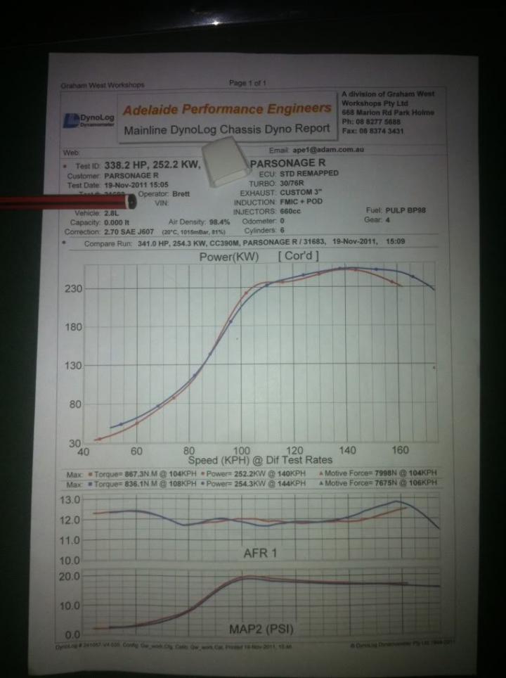

                                Anyway not much has changed at all really but i did chuck it on a 4wd dyno at a recent dyno day here in Adelaide. What i found surprising is that there is really bugger all difference between the power output in AWD and FWD. The Graph below has the AWD run in RED and the FWD run in Blue.
                                I suppose realistically when the fuse is pulled and the car's in FWD the transfer case, tailshaft and some of the haldex componentry is still spinning thus the only extra losses in AWD would be from rolling resistance of the rear tires + the rear diff and haldex components.
                                I was hoping to run more boost however i'm having some issues with either getting my boost controller tuned in right or the wastegate spring seems to be failing as can be noted by the gradual boost fall off. Either way i've been content with the power output so havent really bothered to tweak anything lately! Was interesting this time on the dyno as the torque hits so hard we had to re-strap the car down several times to prevent it wheelspinning
