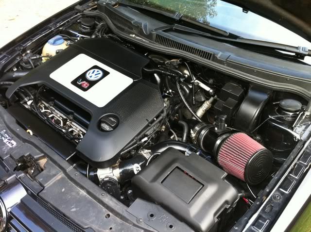

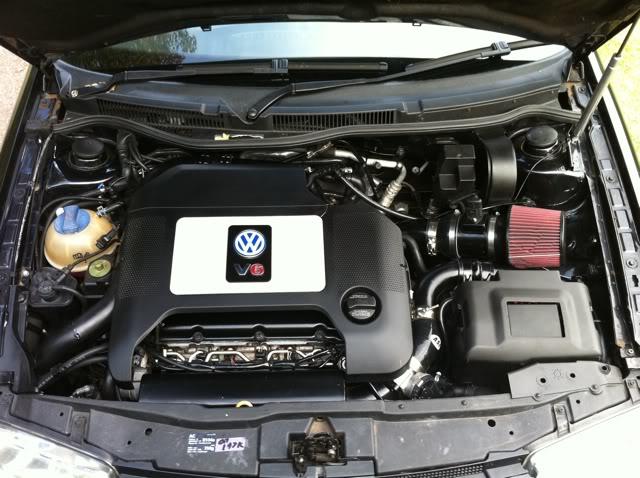

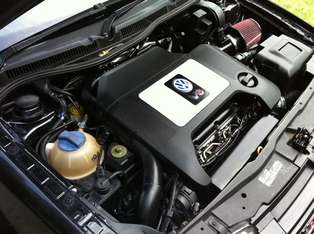

    • Gave the engine bay a quick clean today
      • Originally posted by WhO View Post
        I love how stealth your install is - a real inspiration.
        • Man, absolutely top shelf. The engine bay looks schmick as, complete sleeper. Also the the guy videoing is doing a great job to hold the camera steady under boost. Oh and it sounds unreal you lucky bastard
          Audi S3-White Lightning
          • Such a clean install! Words cannot describe how good that is.
            • Ok so now that you've got it working, Unbolt it all, put it in a box and ship it too me, Thaaanks (no not kidding)
              God damn that is beautiful and perfect. Absolutely how i want mine to look like. If you didn't know much about cars you wouldn't even be able to tell. Basically looks OEM. Only weird thing is the engine cover haha

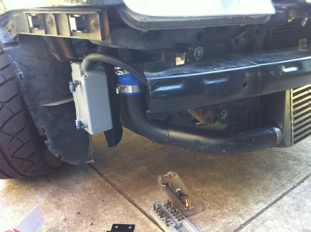

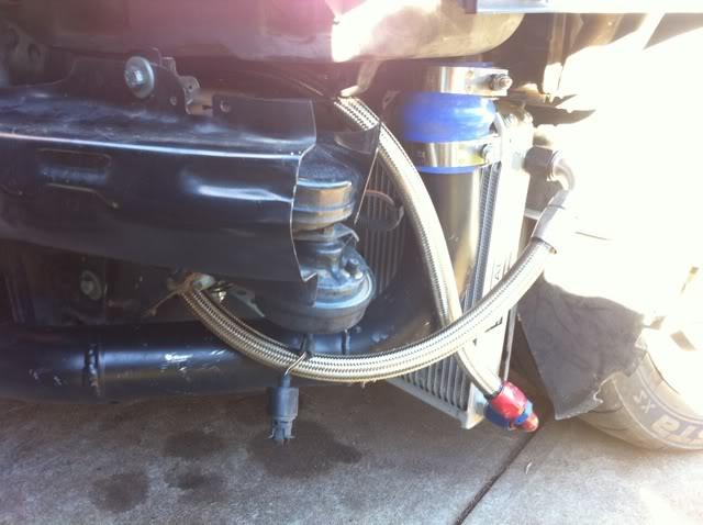

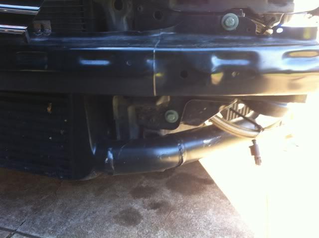

                  • More bits done: Oil Catch can has been installed in behind the bumper to keep it out of the engine bay, windscreen washer bottle has been sorted and i've boked dyno time for this friday!
                    Couple pics of cooler routing and the catch can. Continuing my stealth trend the Catch can has been painted black, its grey in the photo as i've just alloy etch primed it. Sorry for the poor image quality!

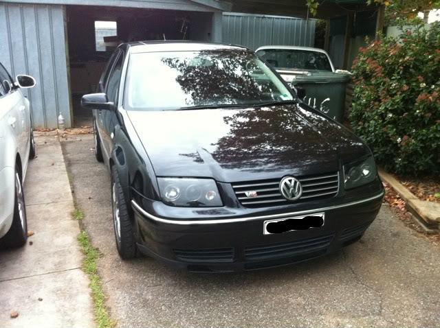

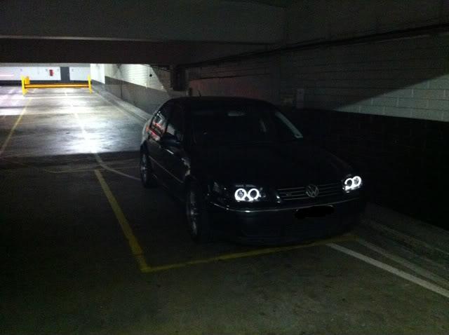

                        • Photos of my latest change, New headlights to replaced the old faded ones
                          I wasn't sold on the Angel eyes at first and was planning on not hooking them up but after some convincing decided i'd give it a shot. Can't say i was a fan of the idea at first but once i wired them and tried them out i'm actually kinda liking them. That said i'm not 100% sure i like the extra attention they grab especially when i'm going for the sleeper look so i'm undecided if i'll keep them wired up or not.

                            • Those lights look rather nice once installed. I wondered how they worked, might have to invest in some as the old stock ones are very very cloudy.
