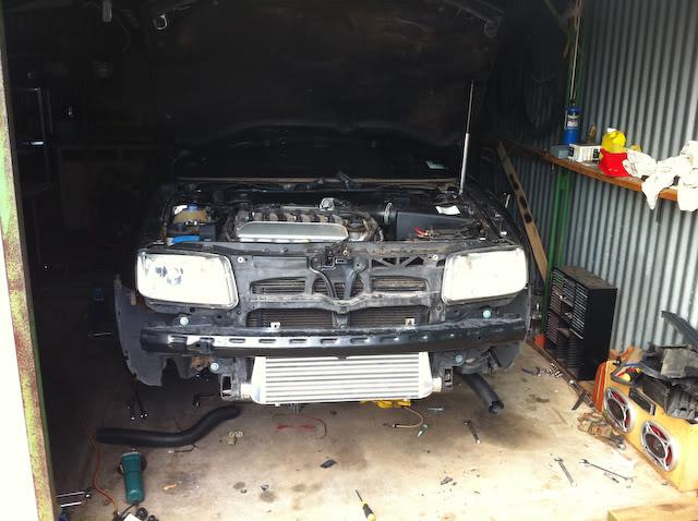

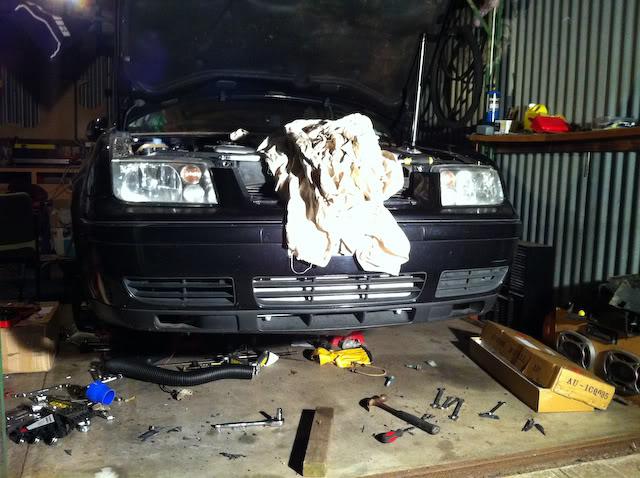

      First thing i decided to start tackling was the fitting of the Front Mount and fabrication of some of the lower pipes. The Bora makes for quite a tight fit and as one of my goals for the build is to NOT cut any metal on the car it was made that much harder. Unfortunately as with most intercooler installs i did have to resort to a slight trimming of the reo bar, however when i say slight i mean <4mm or so, so acceptable in my eyes.
      To get the cooler pipes to fit snugly behind the bar i had to chop the piping outlets off the cooler and weld bends directly to the cooler, however this combined with some light triming of some plastic allowed me to fit the cooler nice and snugly. My goal here is to make the cooler fit cleanly into the airflow through the lower grill however keep it well hidden. Eventually it will be sprayed black for a complete stealth setup.
      Cooler fitted

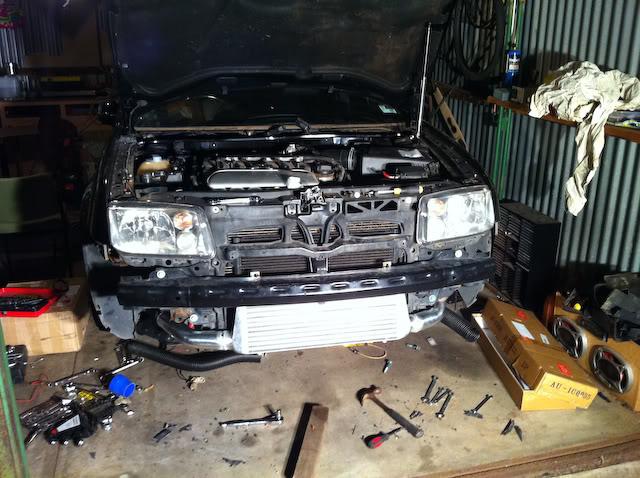

      Piping started
      Bar fitted
      Unlike how many of the guys from the US run the hot side cooler pipe (along the chassis rail then up by the firewall) i've decided to relocate the washer bottle thus bring the piping up the front drivers corner behind the headlight. I'll sort the washer bottle out later but reckon i'll just modify it to fit in behind the front bar. Pics of this will come when i get to it.

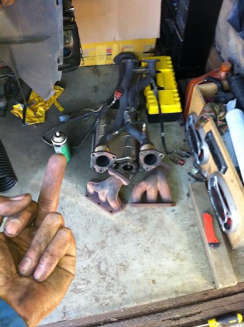

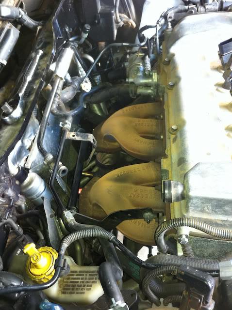

      Since beginning i've also removed the standard plastic intake manifold and exhaust back to just behind the cat. I've got to say at this point, getting the exhaust out is a bit of a pain in the A$$. This aside from the fact the bolts are a pain to get undone is also because the prop shaft makes it impossible to remove the primary's. Thus to remove them you need to undo the prop shaft from the transmission and then rotate the engine (dogbone undone) away from the propshaft so you can then disconnect it and push it off to the side.
      My feelings towards the exhaust and its difficulty to remove it
      There one second
      Gone the next

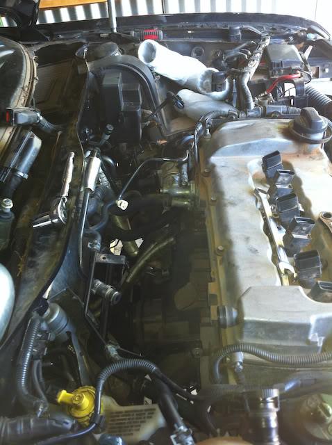

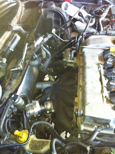

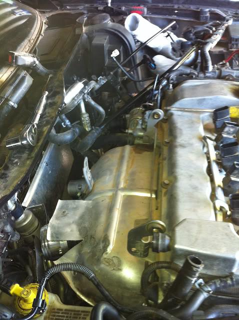

      However now that all that's off it's given me a much nicer idea of how much room i've got to play with and how everything will sit. As you can see here, there's plenty of room for the turbo, wastegate and manifold and the standard heat shield can even be made to fit... lovely Note that the manifold and turbo was only put on to test spacing as i'm still waiting on my head spacer prior to actually starting to mount it up for good.
      Oh hai thar
      And hidden by the heat shield (although the turbo outlet will be rotated to face upwards

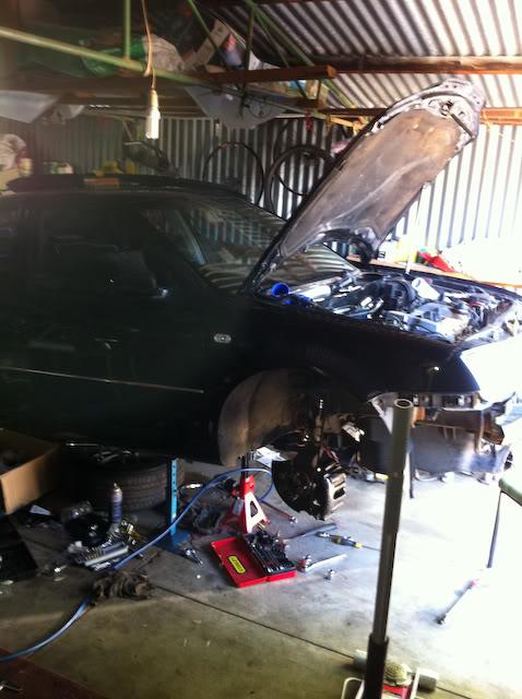

      How its siting now
