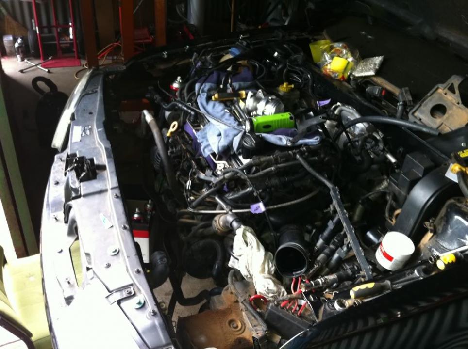

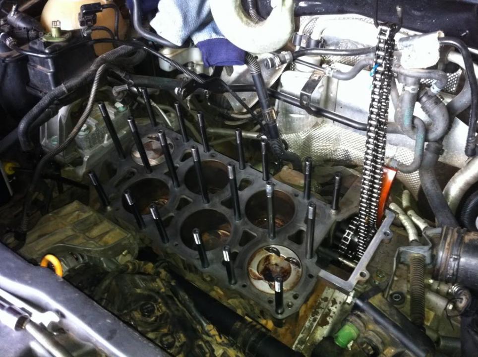

                Ok so as usual long delays between updates, but first some photos from progress as of late. Much more progress has been made since these photos, unfortunately i dont have many more progress shots as i've been getting into doing it when i've been working on it and simply forgetting to take photos!

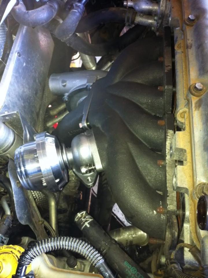

                (Now you see it) Turbo Roughley mounted up (its now properly mounted and hooked up, oil, water etc)
                Turbo... What turbo???
                After having battled with it for near an hour it gets pretty heavy

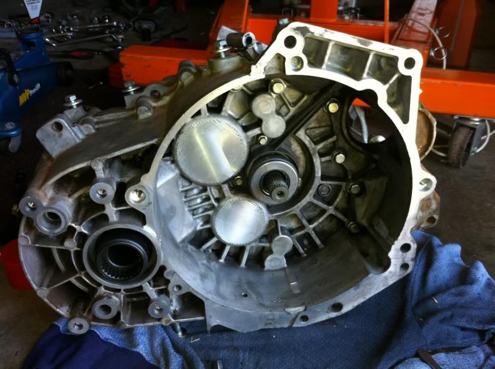

                mmmmm clean

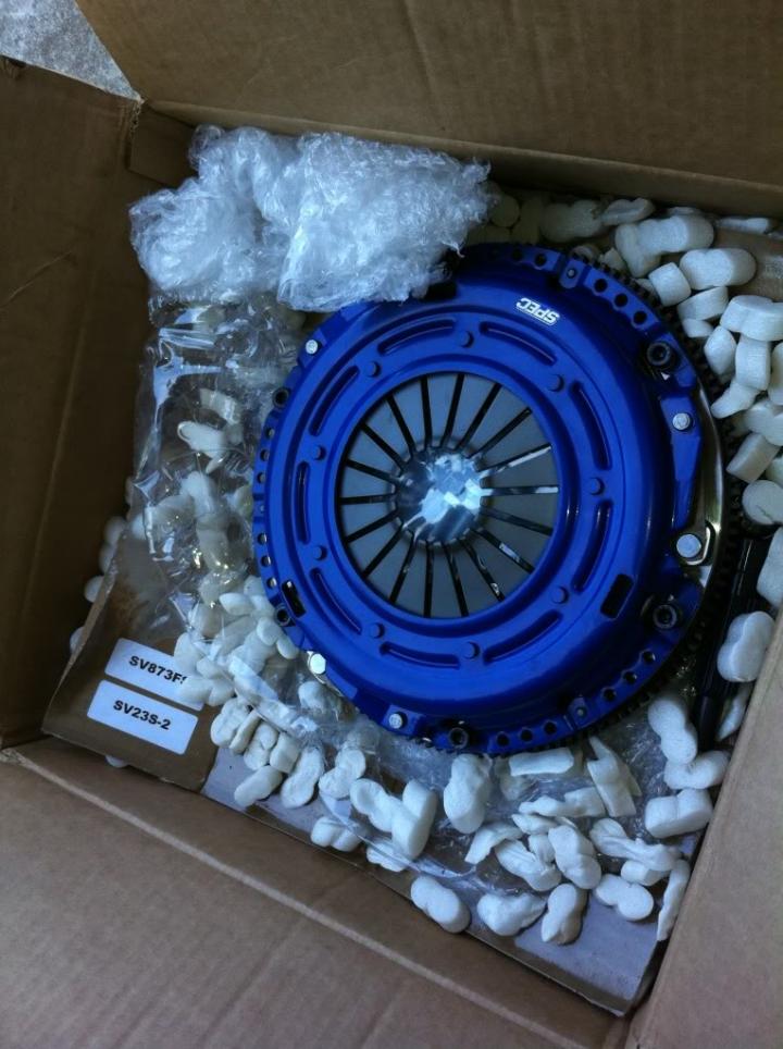

                mmmmm spec stage 3+ clutchey goodness

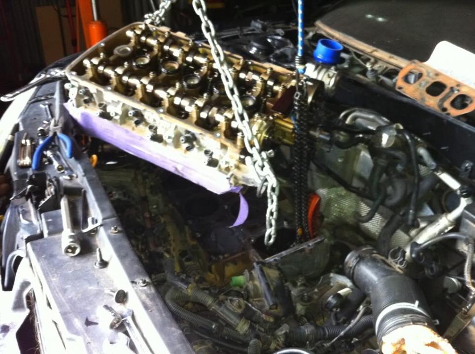

                Dump pipe goodness, now all finished but again no photos unfortunately, eagerness once again getting the better of me!
                Open wide (think this photo was somewhere from early on in the build)
                Well thats all the photos i have, as i've mentioned a lot more has happened since these were taken. I'll update the progress in the next post!

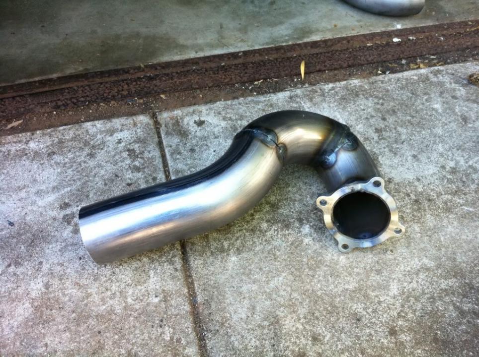

                  Anyway a fair bit has been done since then. I've finished up the dump pipe and front pipe so most of the exhaust is now hooked up. This is one thing i'll almost never do again that said. Making a dump pipe in a shed with a car only a foot and a bit off the ground is not easy, having to guess then cut, get under car line up, mark, take to welding bench ( an old desk lol) tack, take back to car, test fit, repeat this process half a dozen times and there's one weld done...

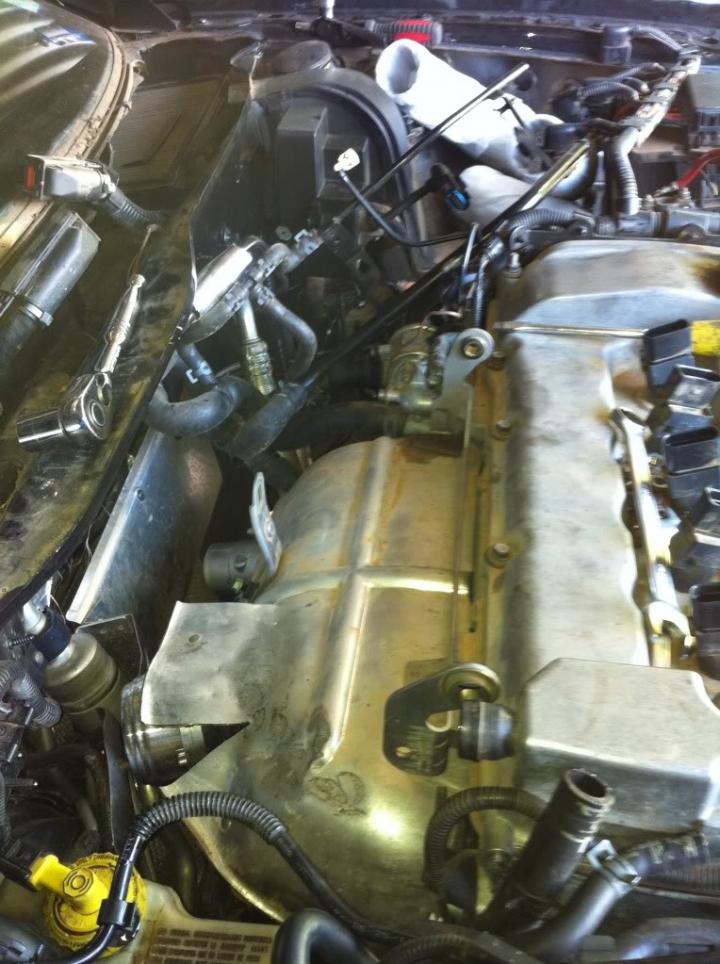

                  Turbo is mounted up properly and intake is bolted up btw which is a pain in the ass to do. The C2 motorsports short runner intake is a very nice piece of kit, however getting the bolts that hold the manifold on is an absolute pain in the ass to do up. Took around an hour just to bolt on not to mention the difficulties in fitting the throttle body, routing the vacuum lines and sorting out where everything went.... anyways done and fixed now!

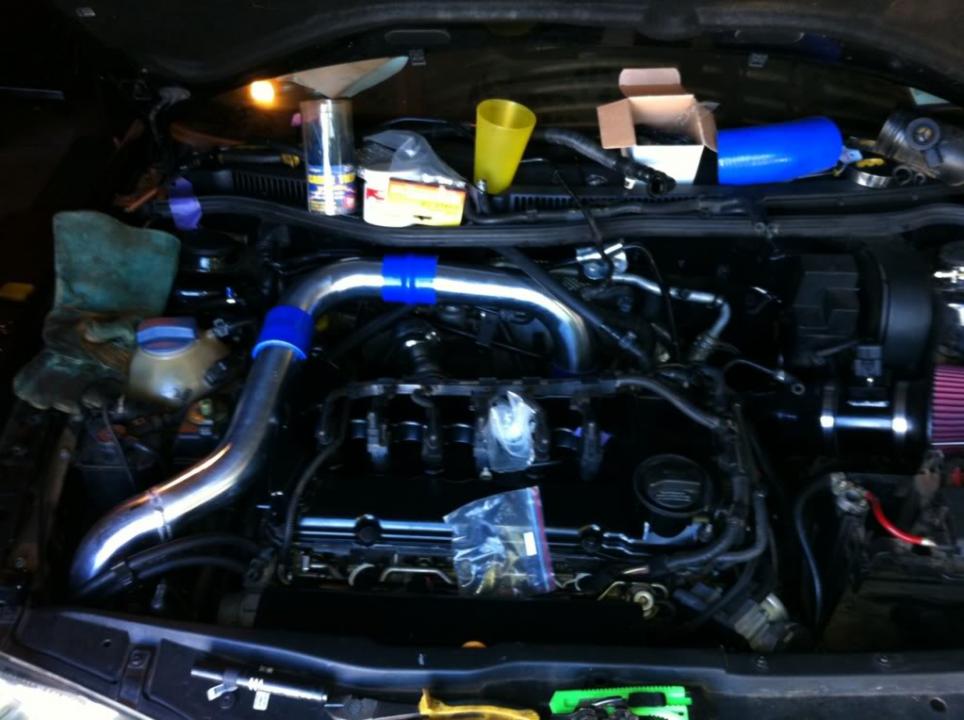

                          Got cracking on the upper section of the cooler piping today
                          Like the C2 intake manifold which is at the front of the motor, the piping will also be sprayed black and i'll either try and spray the silicone couplers or I'll just get black ones. Stealth FTW
