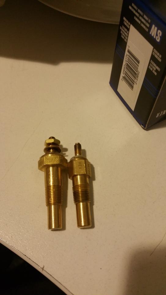

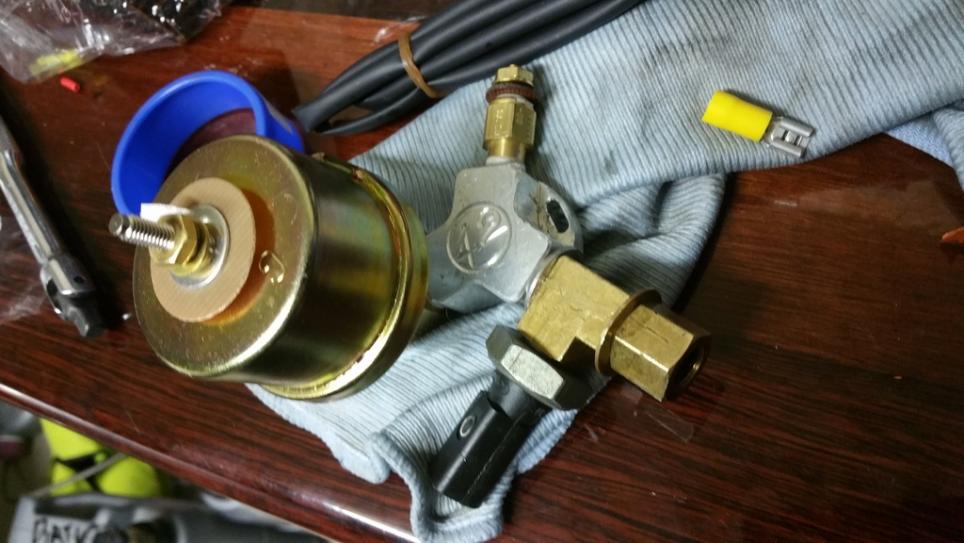

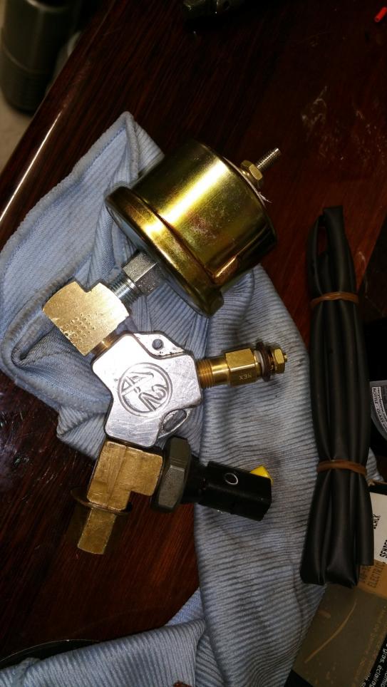

Finally got around to installing the oil pressure and temperature gauges for a little piece of mind. Installation is fairly straight forward just a lot of faffing about.

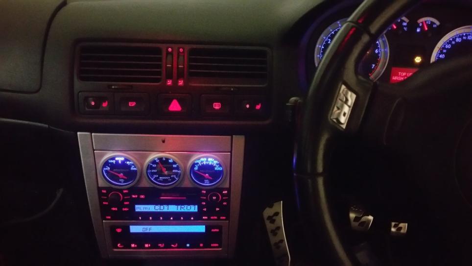

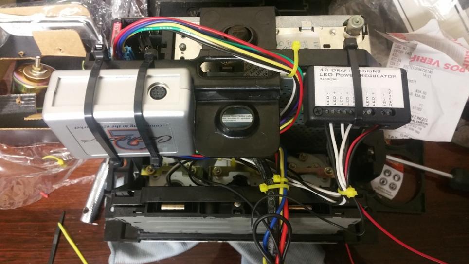

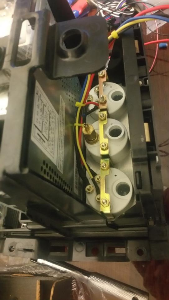

Behind view of the stereo cage with gauges. Easy install with the backing plate.
Wiring completed with the cd changer box and a power regulator to run the perfect match LED's for the gauges.

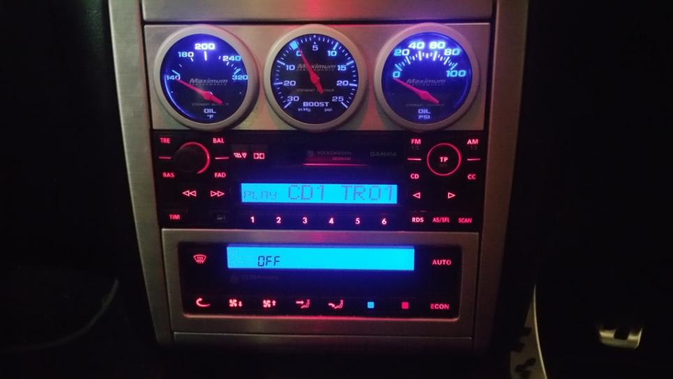

Everything back together and working well. Little annoyed with the LED's as they make a bright spot at the top of the gauge but minor complaint for the matching and the fact you can dim them.

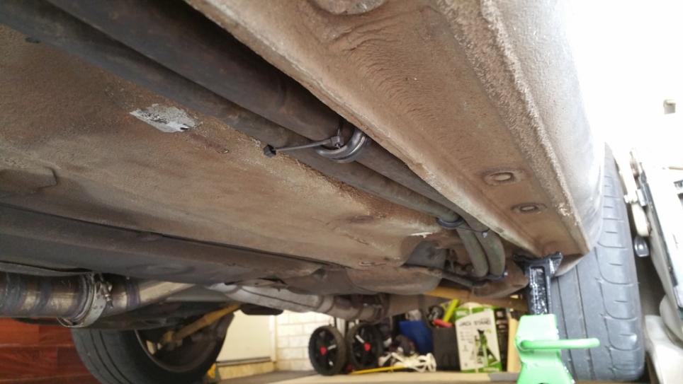

Got the car into the service position for hopefully the last time in a while. Been like this far to often recently.

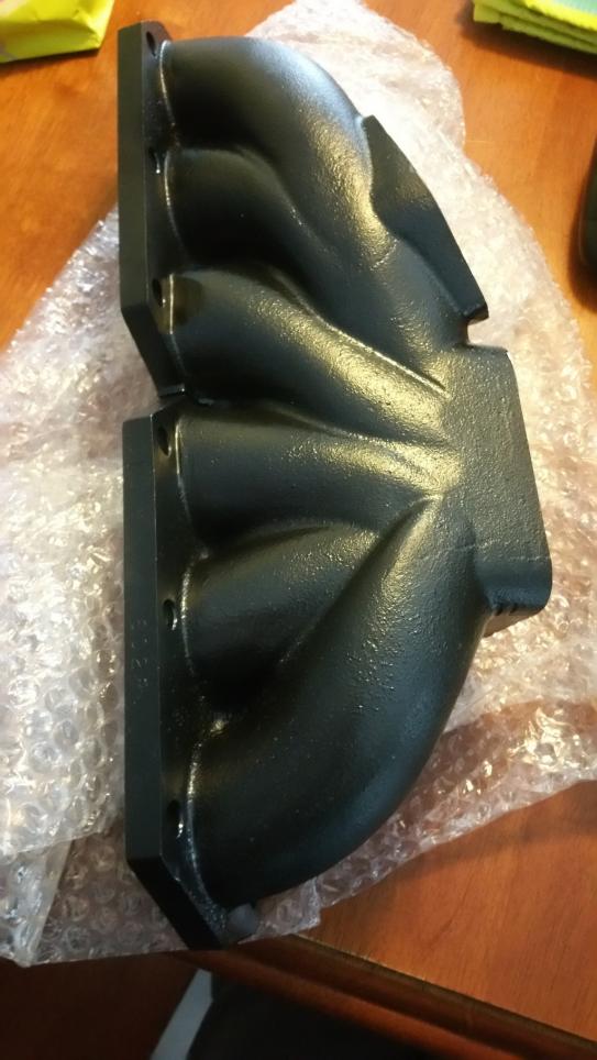

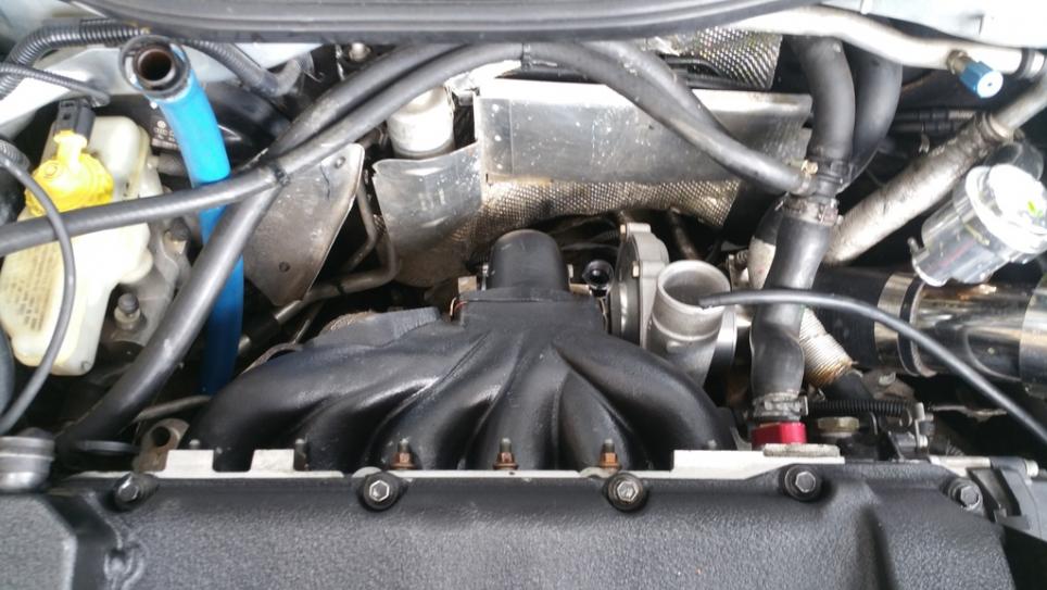

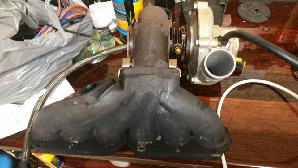

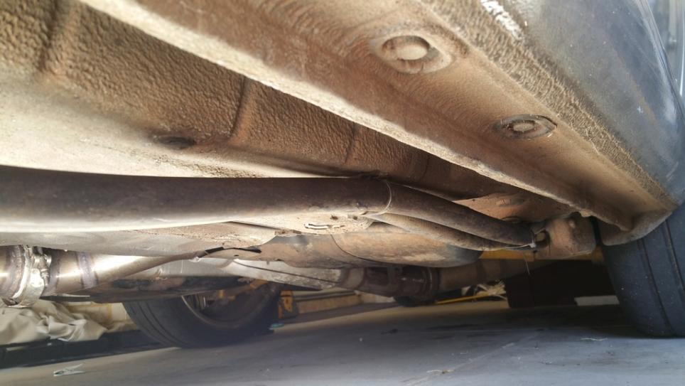

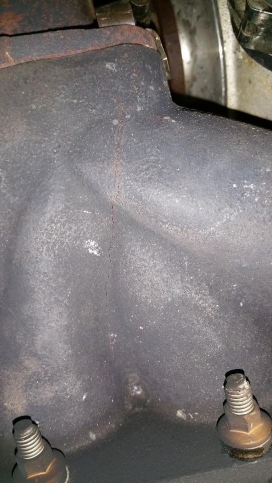

Also noticed my manifold has cracked which will eventually need to be replaced.

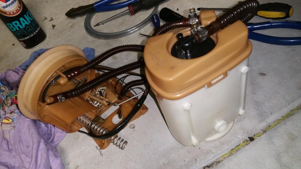

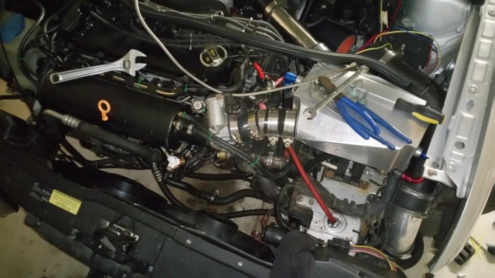

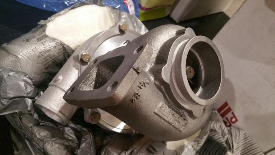

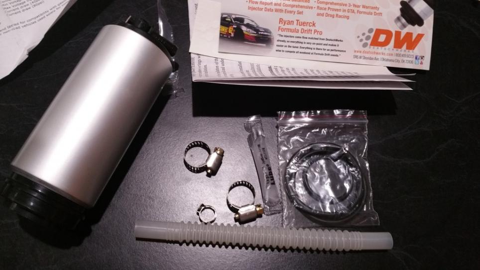

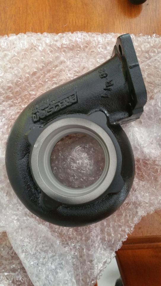

The progress on the actual turbo however is still non existent. I am still waiting on my fuel pump to come. Its been over 8 weeks since i ordered the pump, received the wrong pump at 6 weeks and have been told it will be at least another 2 weeks until the correct one is sourced.
