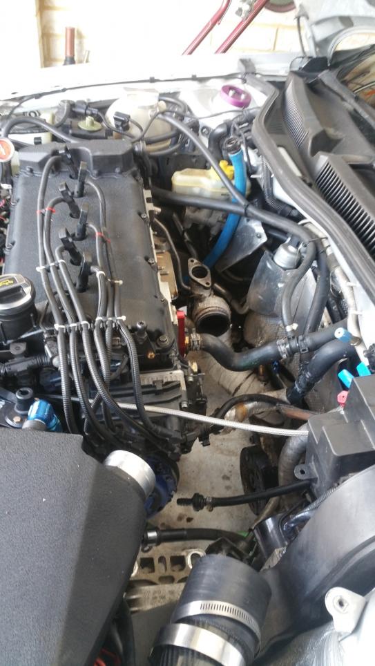

    Finally got the turbo parts and exhaust all back together and on the car by lunchtime Saturday. Start her up and check everything but the oil feed line from the block is leaking....and then it stripped the thread. All happened just after 12 when everything closes down.. Damn.
    So Monday i go to a fitting shop and get the correct fitting (yes the other one was wrong which is why it was leaking obviously) get back and fit it and bam! No oil leak. Woo time to drive the car...until i look under the rear and notice a big pile of oil. Damn! All the expensive haldex oil had leaked out from where the controller is. Sigh. So call up and try and get a new tube of haldex but unfortunately it couldn't come in time.
    Tuesday i picked up the new tube of haldex and got home. Fixed the gasket which i think must have been around the wrong way (its quite the pain in the ass to do but no excuse). Went to fill the haldex and boom! oil goes everywhere. Doing it the same way i've done it 5 other times it manages to pressurize and blow the bottom of the haldex tube out and oil goes everywhere. Nuts another bunch of expensive oil down. Call up another place for a new tube and same deal as monday. This nearly broke me.
    Wednesday. Pick up the new tube and get back to the car. All goes well with putting it in this time and no hassles. Start the car and get it off the ramps and boy was it good to drive it again. Put a smile back on my face. Drove it for Thursday and Friday loving every second of it.

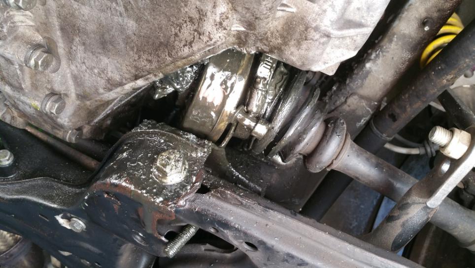

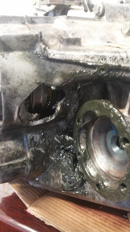

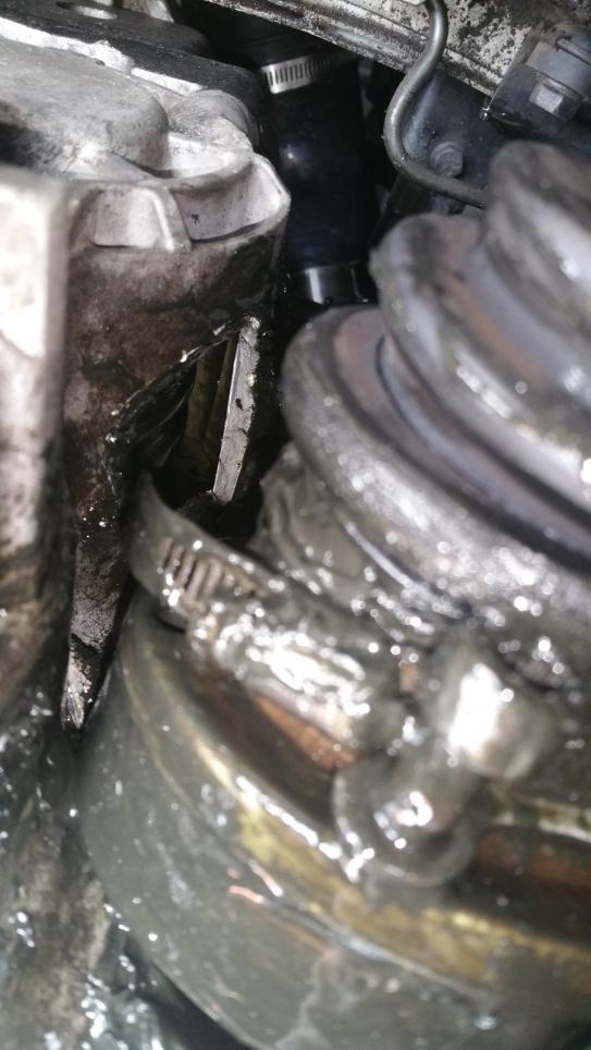

    Saturday Morning: Heading off down south to go kart racing pulled up at the lights and as it goes green i hear this awful thunking noise. WTF? pulled off to the side of the road expecting maybe a wheels come loose or something but they are both fine. Look in the engine bay and the passenger side drive shaft has worked all the bolts loose and came off. Freaken hell. Another $110 tow home for 3km isn't fun. Get the car back in the drive way and the end of the driveshaft comes off on the road but to be expected.

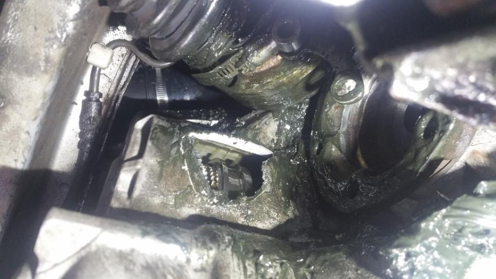

    Sunday. Get the car back into the garage and notice fluid leaking out strangely. Wanted to see what damage had been done got the car up on ramps and couldn't believe my eyes when i saw it. This ****ing car hates me so much. 3 Days... 3 freaken days is how long i had the car before the next major failure.
    My new inspection window.
    So time to rebuild the gearbox. Well at least its kinda an excuse to change over the final drive that i brought and strengthen the box but i wish i could have done it on my own accord. Not looking forward to the bill on this one. Think it may go over the turbo sigh.

      what went though the box?
          From these angles it looks like it was the flailing driveshaft after it broke free.
          Are you supposed to loctite those bolts when they go back in?
          Thats the longer front shaft too, isn't it? Did anything else cop a pounding?
            no good man!
            Keep at it!
            As tinto said i believe the drive shaft moving around when i moved the car off the road.

            I don't believe they need it but sure as hell are going to get them now. Nah shorter shaft on the passenger side. The end cap of the drive shaft came off and got run over so not sure if i can get that separate all though it seems as though i should get a new drive shaft anyway.

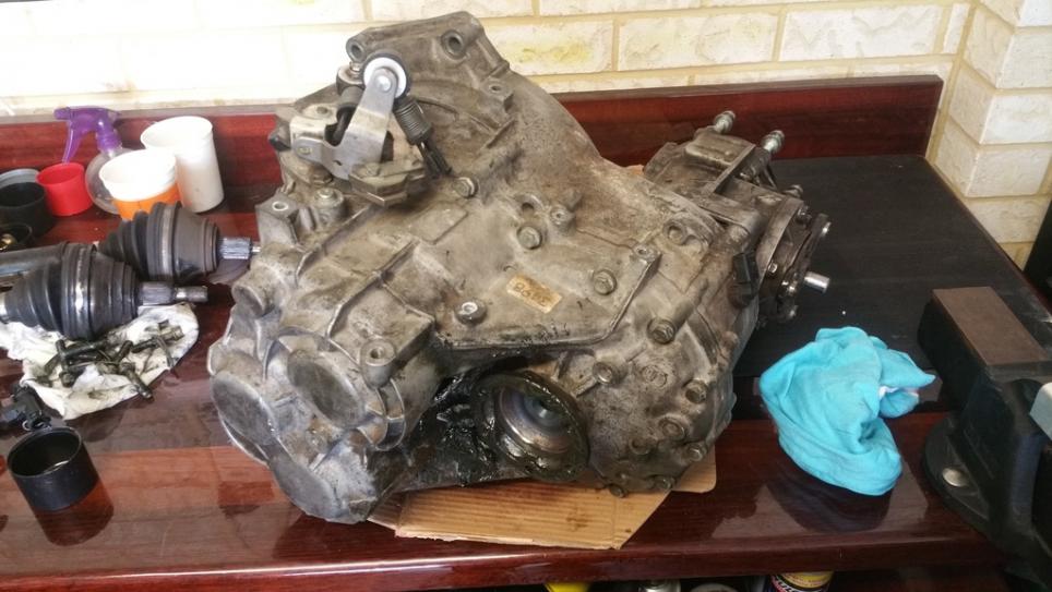

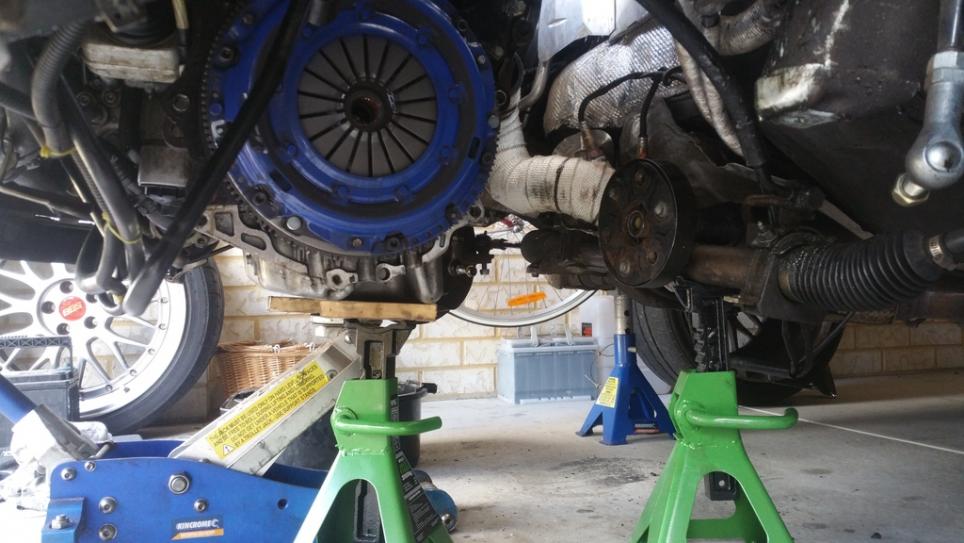

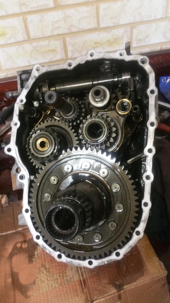

              Got the gearbox out after much cursing and swearing but only took 5 hours including removal of turbo and sub frame (just makes it a bit easier). Its a bit sad that i know how to do it exactly...
              Resulting works after gearbox out.
              Finally bastards out

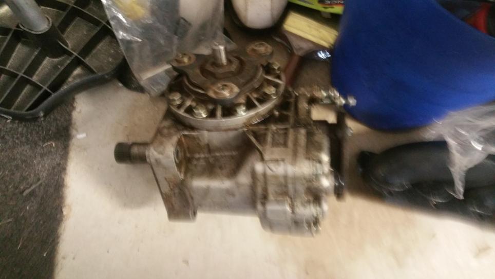

              Transfer case removed

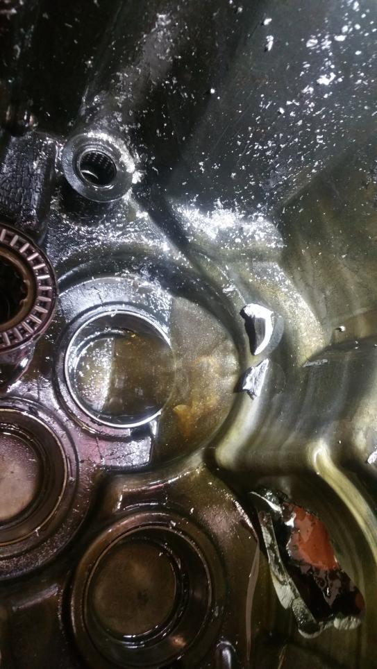

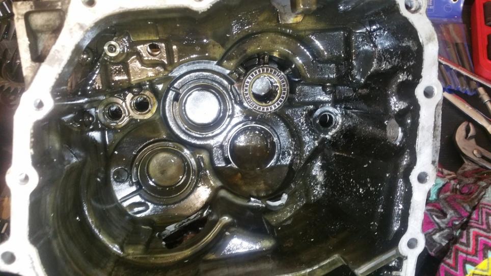

              Damage to gearbox and driveshaft.

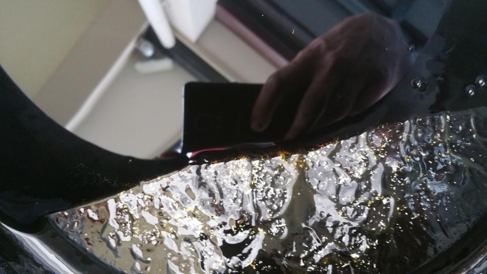

              Draining oil was a sparkly experience

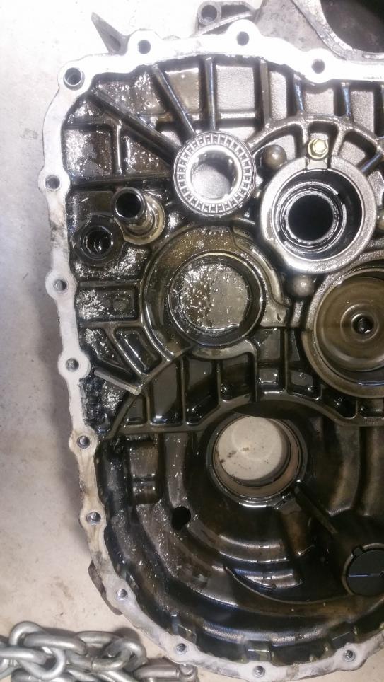

              Splitting the case was a bit of a pain in the ass, not sure if due to me being tired and frustrated or just like everything its just a pain in the ass. Major issue it getting the shifter tower out. Once split it reveals far more glitter.
              Time to order up some bearings and seals and then decide weather or not i can rebuild it myself or should i take it to someone.
              Also, if anyone notices some slop in their gear shifts i can bet its caused by this shifter pin which runs in the guides for the H patten. Would be an easy fix

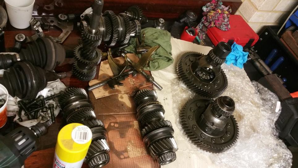

                            Last time i posted was when i was getting the gearbox rebuilt. Before sending it off i had to upgrade a few internals.
                            Old Final Drive with rivets
                            Rivets drilled out
                            Ring gear off
                            Bastard rivots really didnt want to come out.
                            Using my grandfathers old bench vise the wrong way leads to missary.
                            More rebuild **** and rivets for the diff, used two packs in the end after some of the threads screwed up when inserting them (probably to do with poor workmanship :S)
                            I took the opportunity to do some shift fork upgrades whilst i was here. Shift fork with rivet

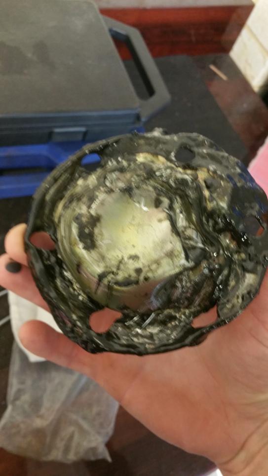

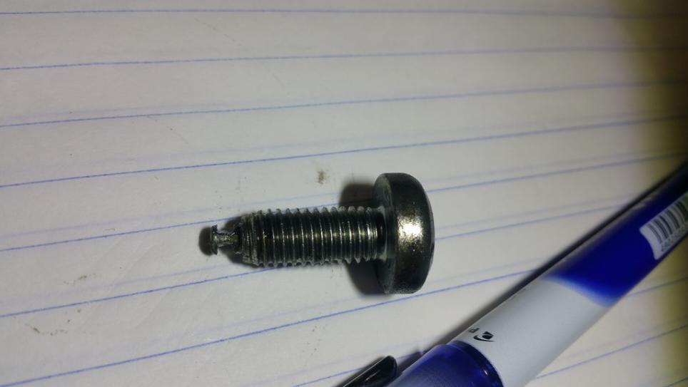

                                Looks like a bolts come loose on the driveshaft coupling allowing it to detach but still spind from the rear wheels taking out everything in its way.
                                Sorry need to take some photos of the failure but you can see below when it repeats itself....
