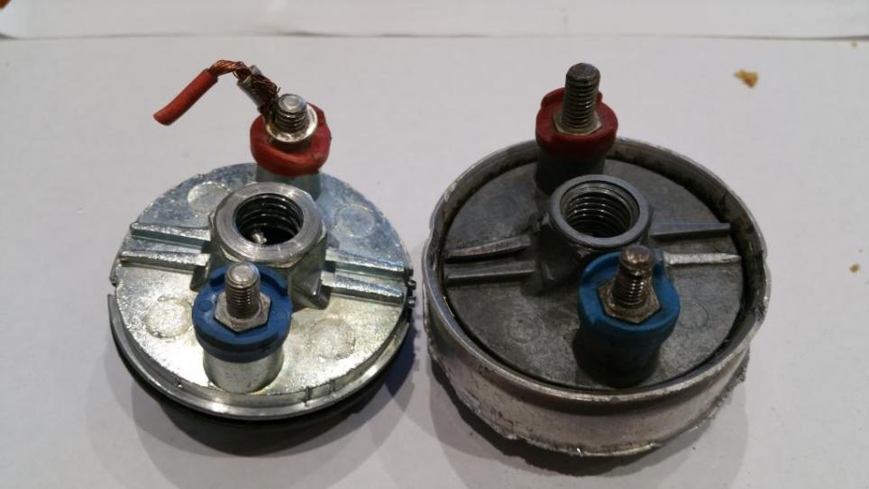

                          So it looks like i have to eat my own words. Its a fake, a decent fake but fake none the less. My advice, don't buy them off ebay. Luckily i managed to get a refund when i pointed that out but not going down that path again.
                          I decided to tear it open along with the other legit one that i had that died for information and i think you guys might find it of some use.
                          Fake on left, Genuine on right.
                          Casings. Same markings very hard to tell. A little differences in the crimp height etc but would be impossible to tell by itself.
                          Inlet port. Fake is threaded aluminium, also the wrong pitch. Legit is helicoiled.

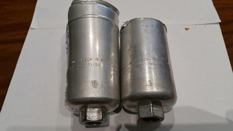

                          Intake filter. Fake is a lot bigger than the legit version. All the debris is due to a tired idiot threading it onto the wrong thread (didn't contribute to the failure however)

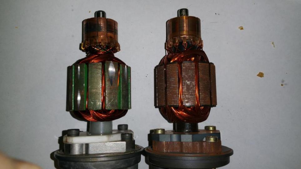

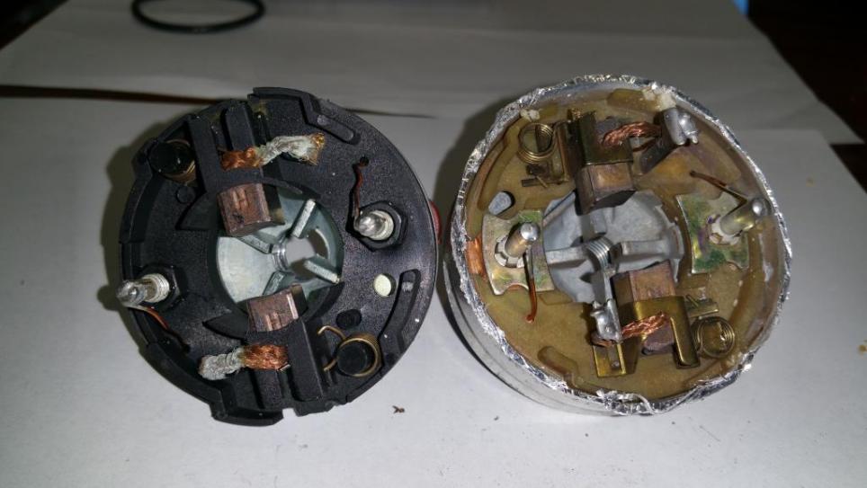

                          Brushes. Quite a difference here. The cause of my intermittent failures was due to the brush sticking back hence why hitting it with a hammer fixed it.

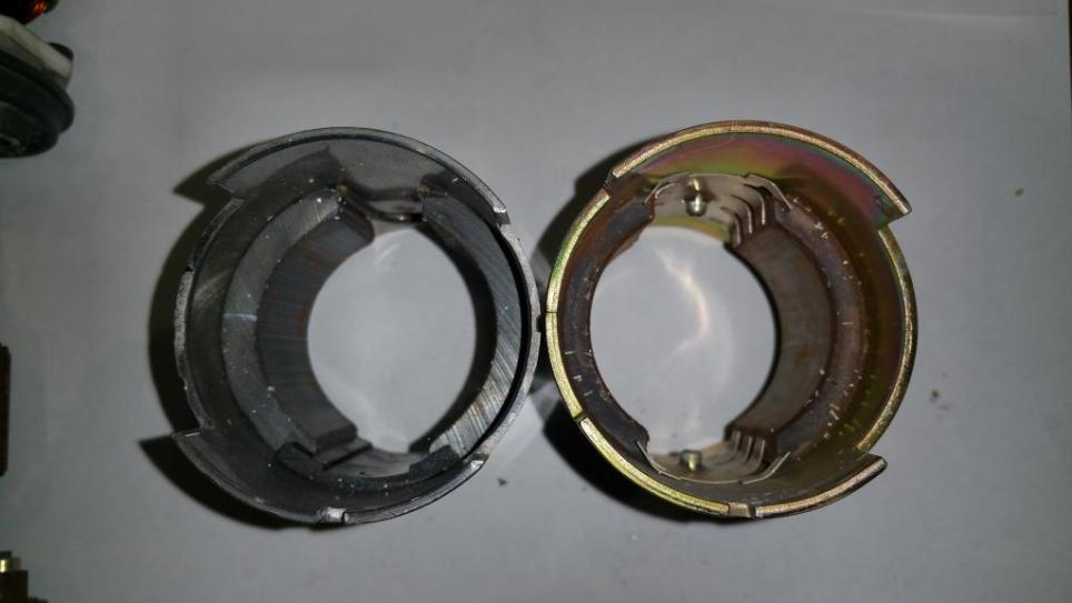

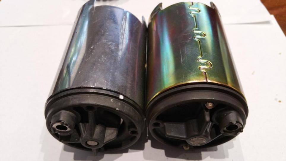

                          Outside's. Fake is a tube with the notches appearing to be hand cut whereas the real was a sheet with punched notches and rolled into a tube.
                          Inside, Different magnet holding mechanisms. Ignore the metallic debris from opening.
                          Armatures. Fake is balanced by taking metal out of the armature (Counted about 5-6 different cuts) whereas the legit is properly balanced. Winding is also better on legit.

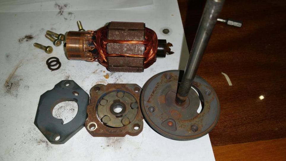

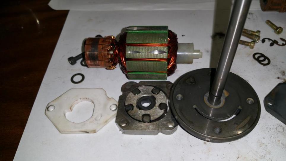

                          Legit Motor and pump. (rusty due to overheating)
                          Fake motor and pump
                          The roller pumps appeared to be much the same but if you look closely the legit one has much finer tollerances which is why i think it would flow more.
                          More photos for those interested
                          Store your photos and videos online with secure storage from Photobucket. Available on iOS, Android and desktop. Securely backup your memories and sign up today!
                          So failure of the first and legit one was due to lack of lubrication. I have a feeling that was due to starving of fuel due to not filling the surge tank prior to running, so my fault. The second pump didn't fail but was having issues due to a poor design of the brushes.

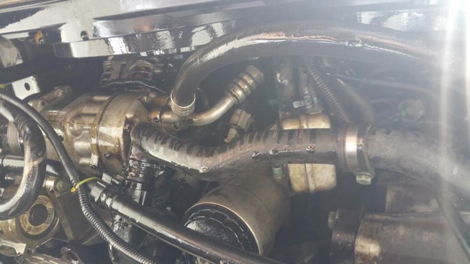

                          • Never a good way to finish a 13 hour day
                            Came in to get fuel after work and noticed an oil trail from where i just drove in, ****. Started car up and sure enough huge pile of oil appeared. So not worth risking it ill get it towed.
                            I think its kinda lucky that i needed fuel otherwise i don't think i would have noticed and it would have been too late. Funny thing is there was no issue when driving to work. Doesn't look major though, think its just the stupid turbo oil feed lines either busted or come loose. Straight after i thought i fixed the leak from that area.
                            Oil soaked everything.
                            Shoutout to the nice federal police, bp works and guy from the random skyline who where at least helpful and nice. Also big shout out to Zero Degree Towing. Good rates and great guy with always a few good stories to tell.
                            2001 Turbo! 4mo Bora 'Boring' | Carbinaro CAI | Fixing broken stuff | Sorting the Turbo Goodness! | BBS Lm's 18x8.5 | KW V2's | 4 pot Brembo's

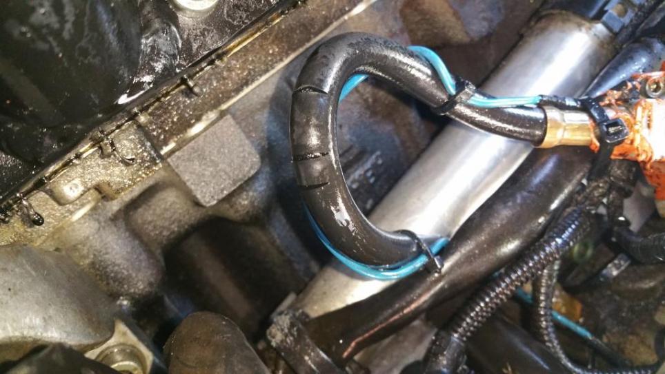

                            • Found the culprit.
                              Also found the sump only had 2.5ltrs of oil in it so im considering myself a very lucky person.
                              • might need to stress relieve the next hose install ?
