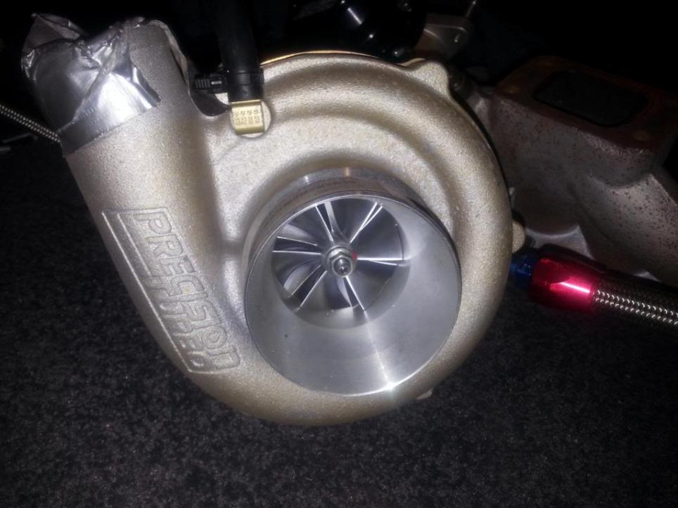

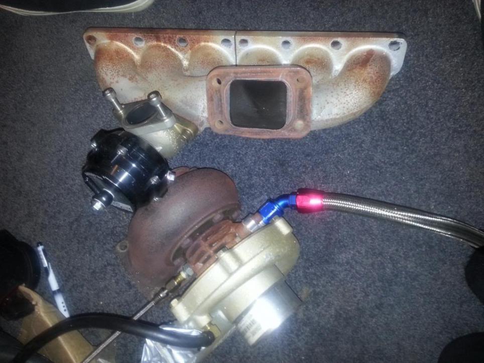

    So i finally saved up and got myself sorted. Around i think late september i organized this from a guy in america who had it installed on his 24v.

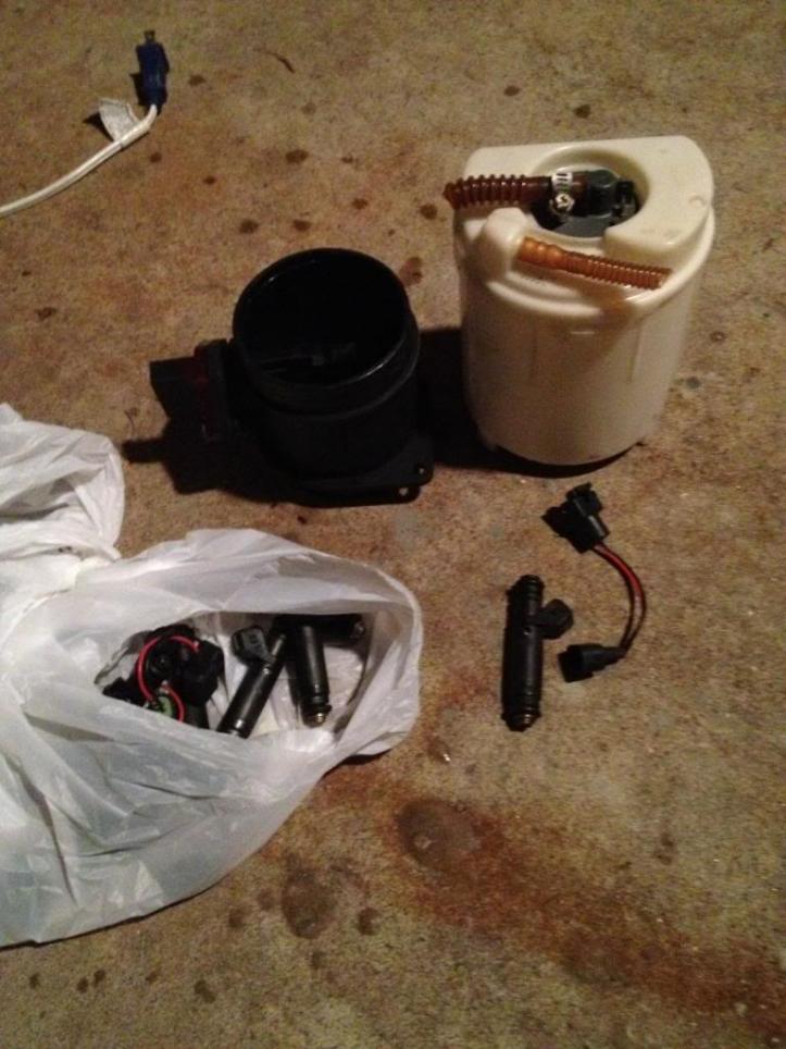

    In the kit is a manifold, Turbo, wastegate, 660cc siemens injectors,fuel pump (which turns out wont work..sigh), ECU with um tune and oil drain and feed lines. Basically everything i needed for the turbo side of things.
    I've since sent the ECU and my ECU to united motorsports to swap the tune to my ecu and add an SRI delete which should allow me to keep my immobiliser.

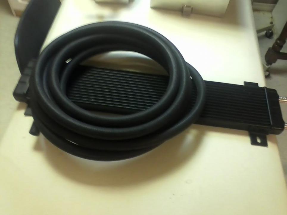

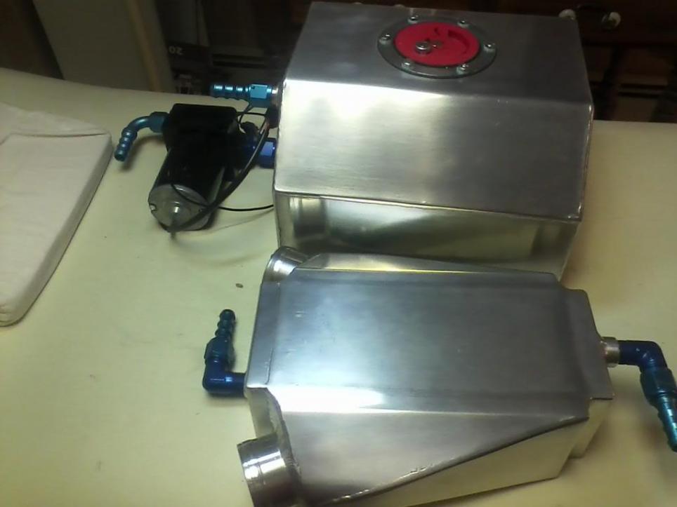

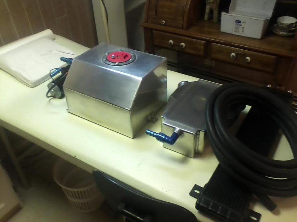

    The other thing i sorted out is this beast of a kit.

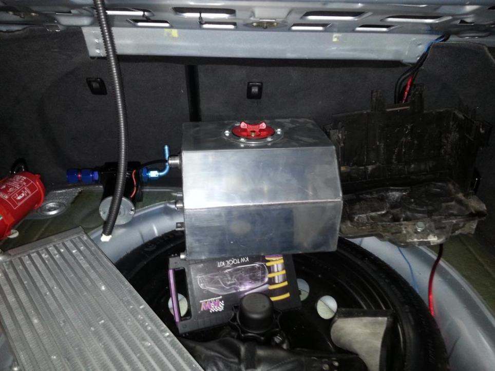

    I loved the idea of an Air/water intercooler specially in australia. A little more complex (well not complex but install difficulty) for some key features. The reservoir has i think a 3gal capacity and a screen for ice. This allows alot of heat to be absorbed and through the use of ice below ambient intake temperatures. It also allows very little intake restriction (less turbo lag) and less complex intake pipework cleaner bay. It comes with a hefty all aluminium water pump and a decent heat exchanger.

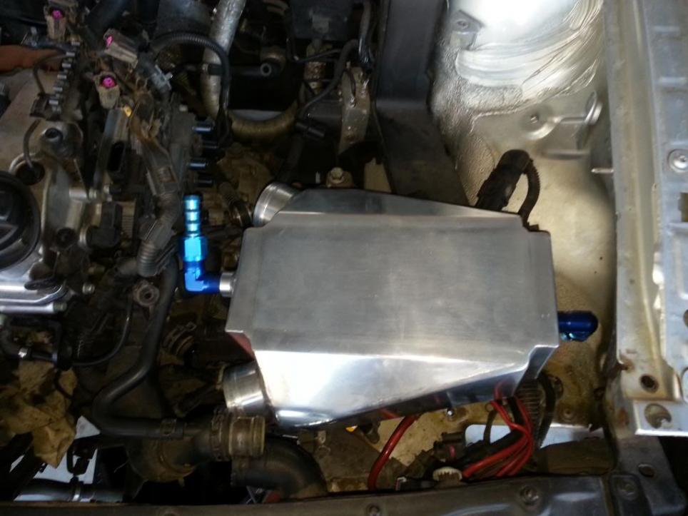

    The basic plan for this is to install the reservoir and pump into the boot, plumb the lines to the awic which will sit where the battery was (getting moved to boot) which runs to the heat exchanger (in front of radiator) and goes back into the reservoir.
    Roughly like this

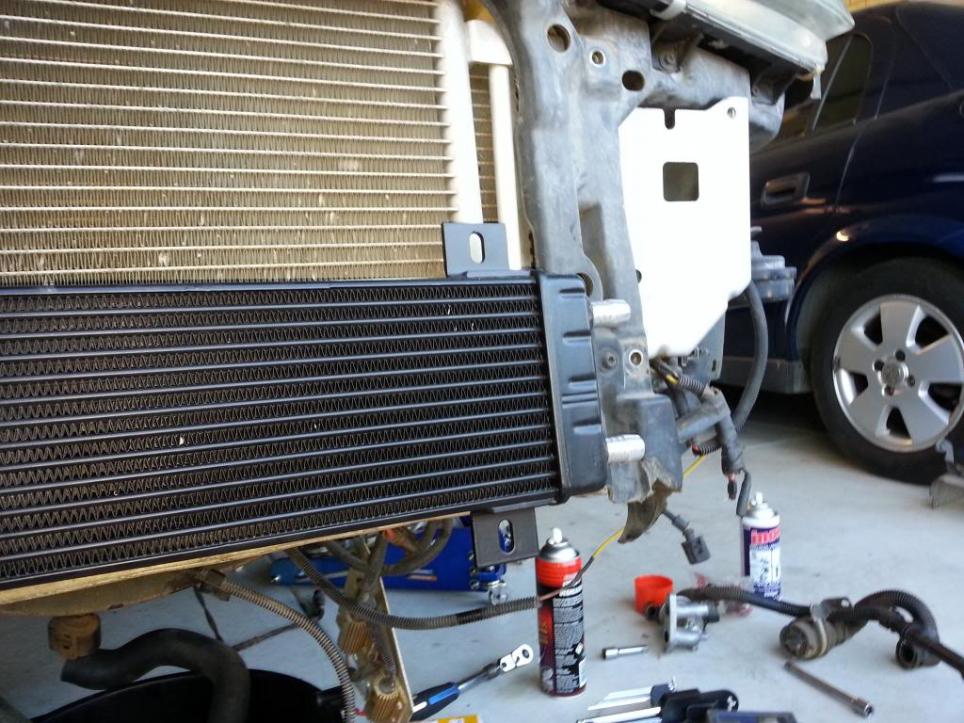

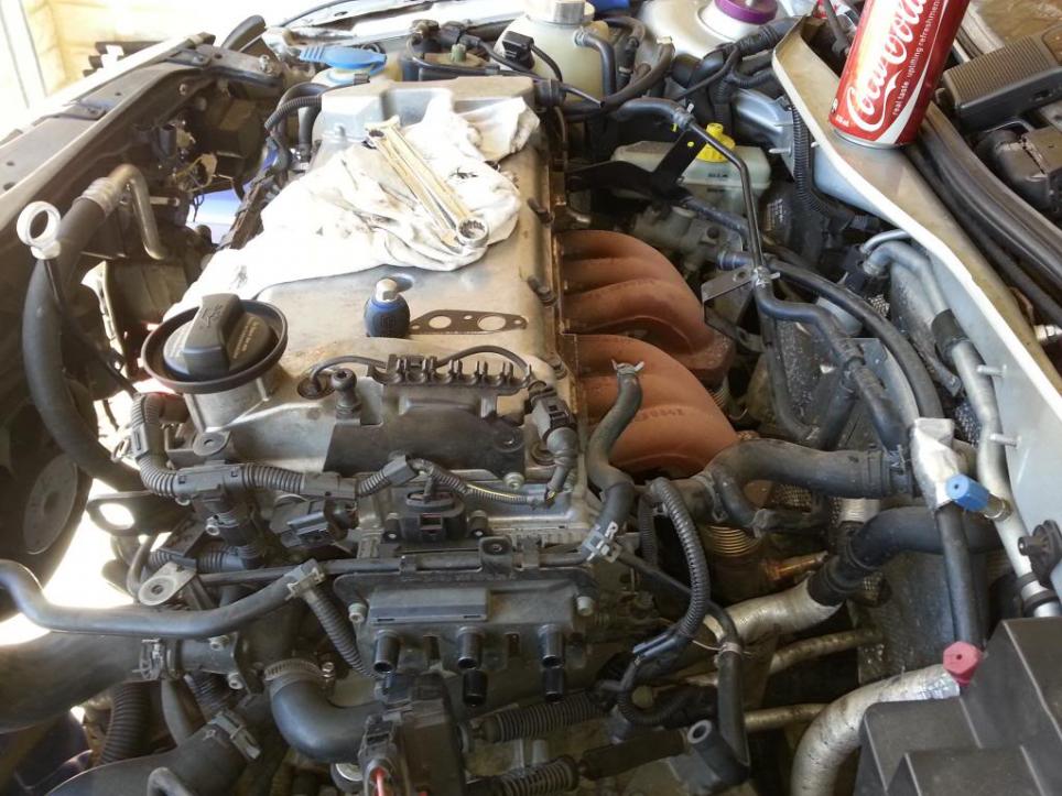

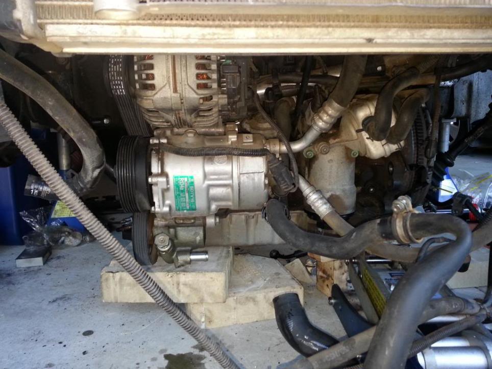

      Currently at the moment the engine bay has the fewest amount of pieces i've ever seen. Basically the core engine is left. I've been very lazy with photos so forgive me ill take more when putting it back together.
      The rough starting point

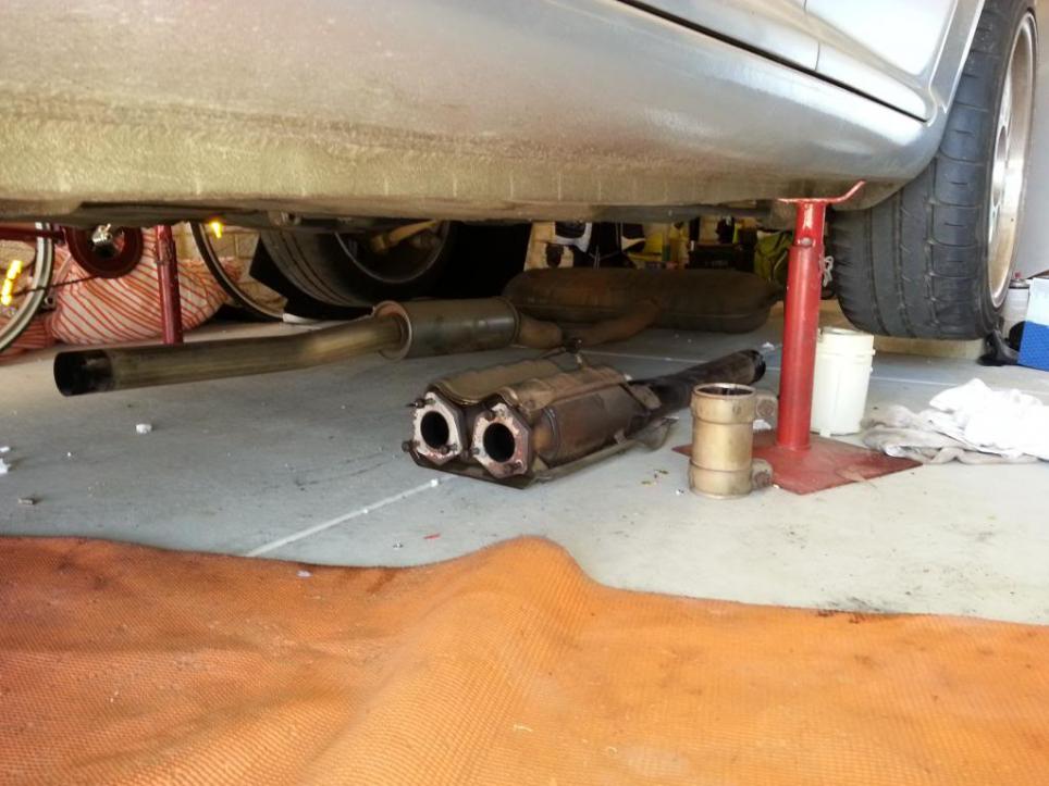

      Exhaust mostly out.

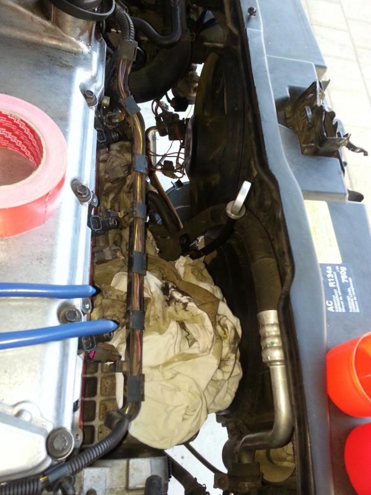

      SRI delete installed (this was done out of order as i should have been ripping down but i was getting seriously frustrated at the exhaust)
      SRI pump removed from front
      To get the section between the head and cat off the sub frame needs to be dropped and the steering rack removed. I think this is VW's idea of fun.
      Heres the back of the engine once the exhaust is finally off!

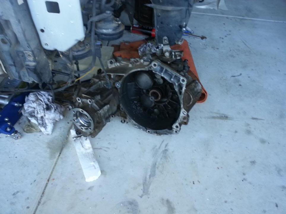

      Gear box out.
      It was ten times easier to remove the gearbox this time. Top reason being no exhaust or most of the parts that get in the way and secondly because i decided to detach the rear drive shaft instead of the box. It hopefully should be a lot easier to put the gearbox back on because of this.

          Can't wait to see how this finishes up... Are you worried about the line length from reservoir to the air-water kit?
            Haha thanks, I enjoy doing it... sometimes.
            Not really. The pump from the reservoir is ridiculous i think its something like 20gal/min. The lines and fittings are what came with the kit so it should be ok. Always chance to change it later on. Most people dont even run reservoirs either.

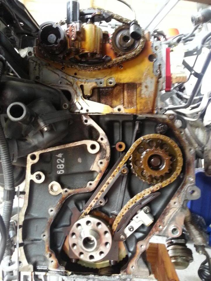

                  • Had an interesting weekend. One of the most oh **** what the hell am i doing moments i've had with the car but all in good fun. Just need to wait until the cars running to see how screwed she is.

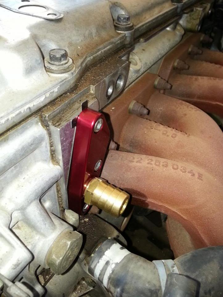

                    Anyway yesterday was all about installing the head gasket spacer and head studs. This involves removing the head and cleaning the two mating surfaces. Whilst i was there as i had to remove the timing chain i did those as well. I'm still missing the top section as its a stupid half cast version but got the lower end done.
                    Anyway onto the part people look at which is the photos.

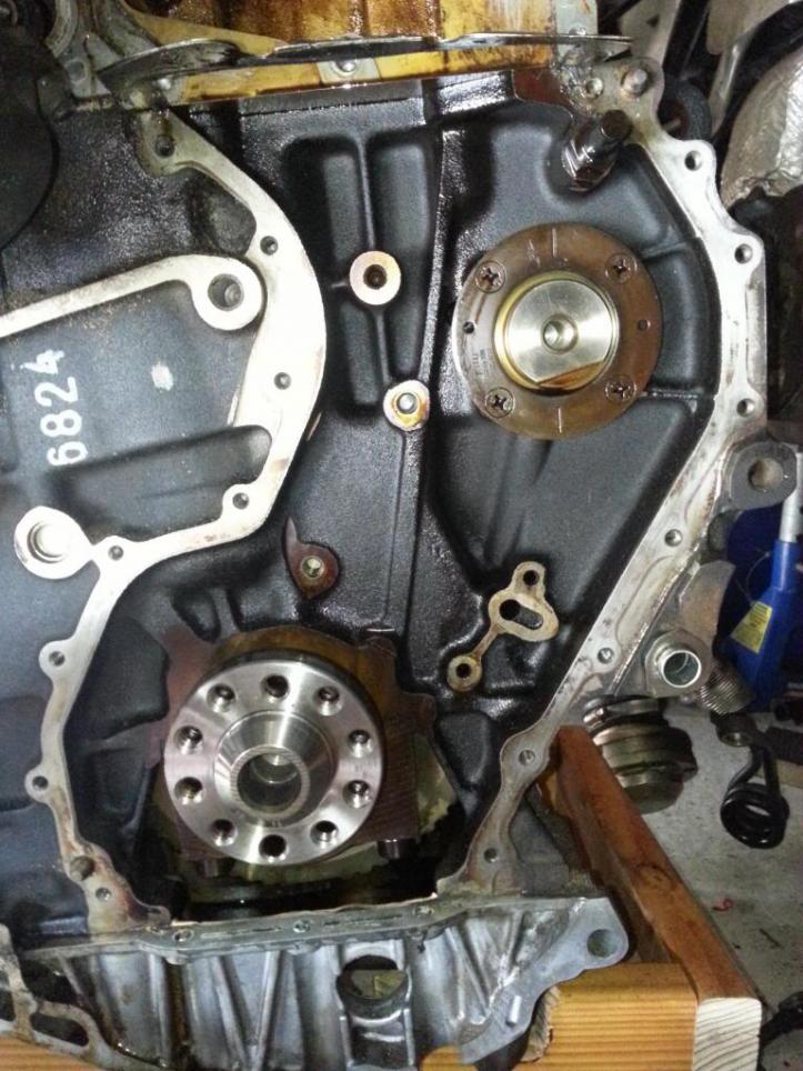

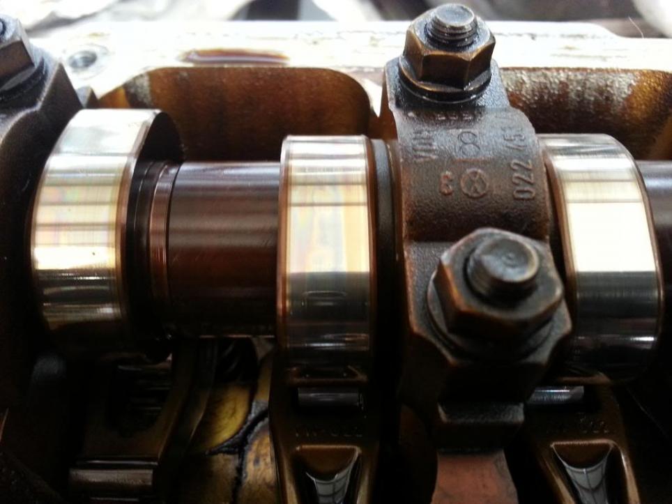

                    So after the rocker cover is off i inspected the cams. My work has got me really paranoid about wear in engines which is helpful and hurting at the same time. But a quick look at my cams show no abrasive wear and the original machine marks still present which is a good sign. Sorry for the bad photo don't have my good camera with me.

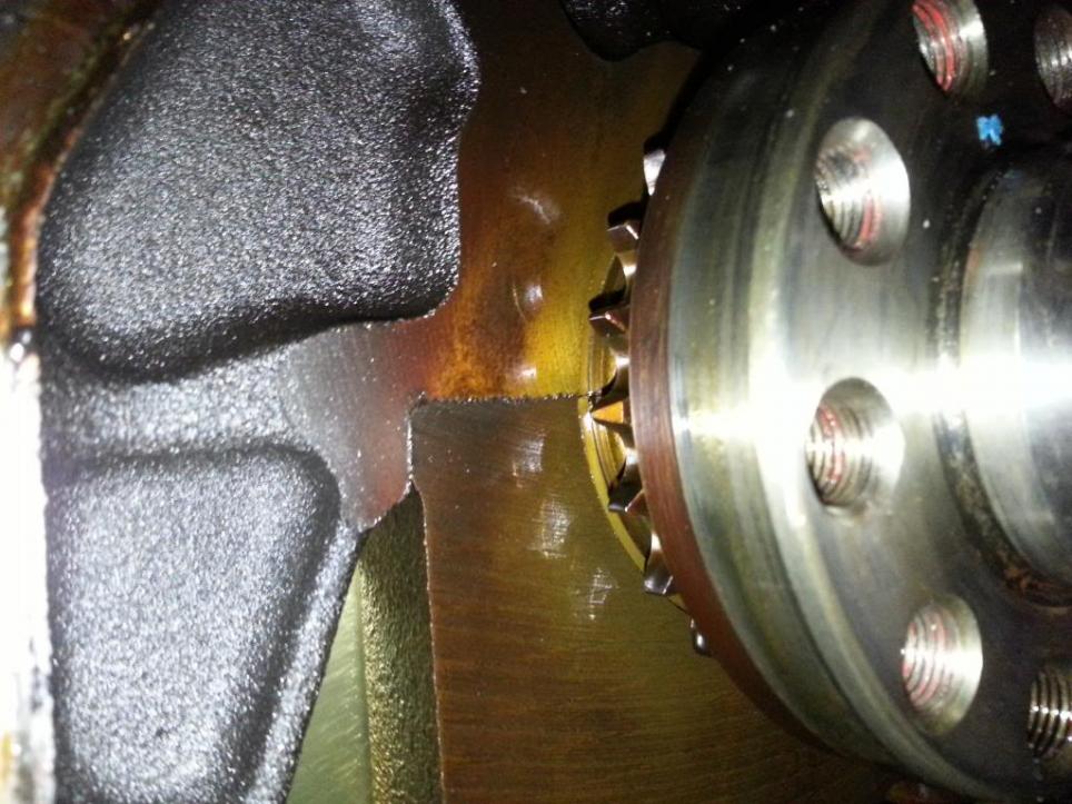

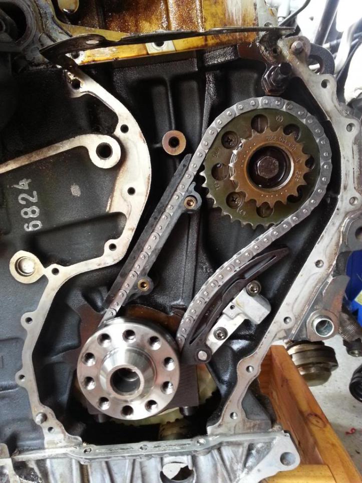

                    Next i removed the upper timing chain. This involves taking the gear off the exhaust cam shaft. A little tip, Don't use a rattle gun unless you don't care about the old timing chains. It will break them (or you could take them off before but shut up).
                    Then the lower chain off. Did the same here and shattered the slide rail into a million little pieces. Was tossing up weather or not to change the guides but this made the decision quite easy.
                    Crankshaft timed. Yes its slightly off but i fixed that.
                    Lower chain and guides installed and mating surface cleaned up.

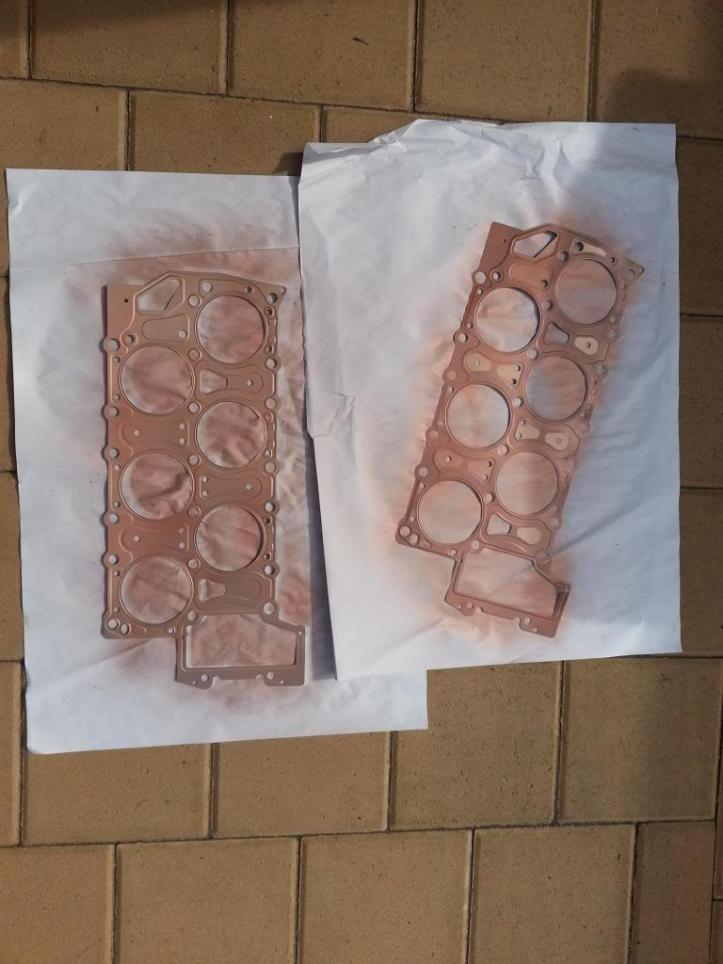

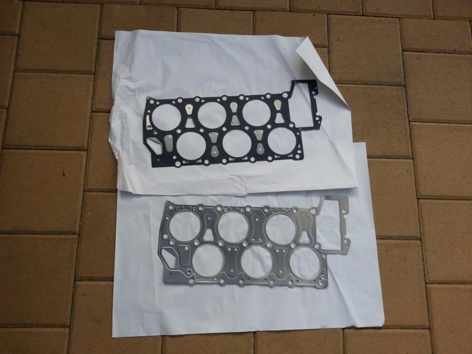

                    Before removing the head i prepped the two head gaskets that go between the head spacer. I sprayed some copper gasket spray over them which was a real PITA as they decided to keep sticking to the paper. This will be the issue if i have any but it should be ok as paper is very soft...
                    Before:
                    After:

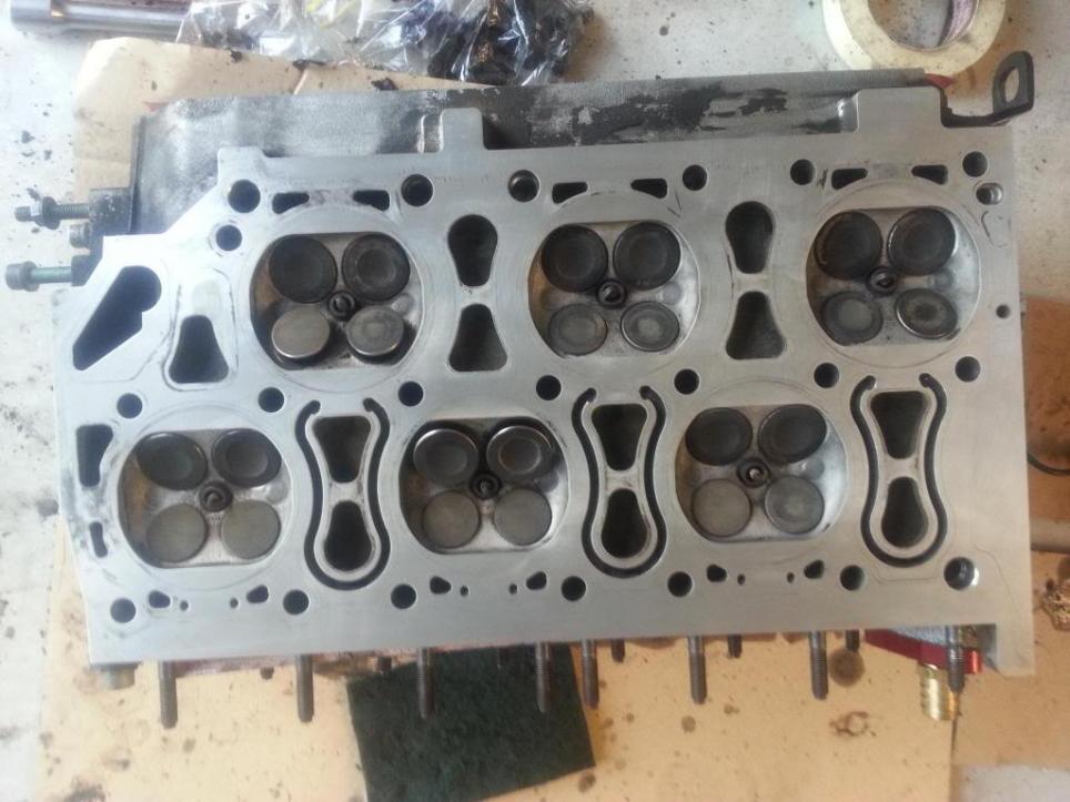

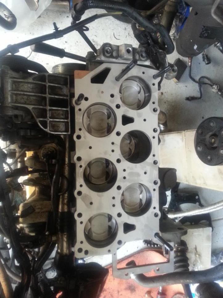

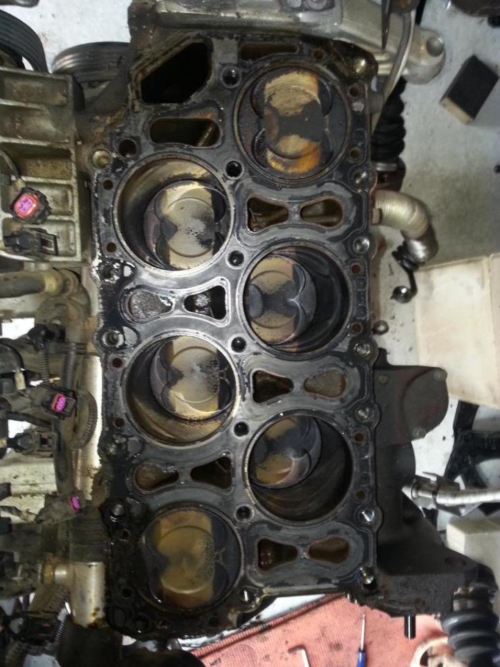

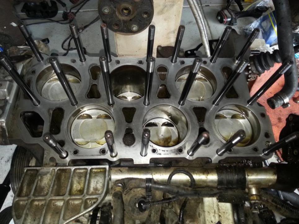

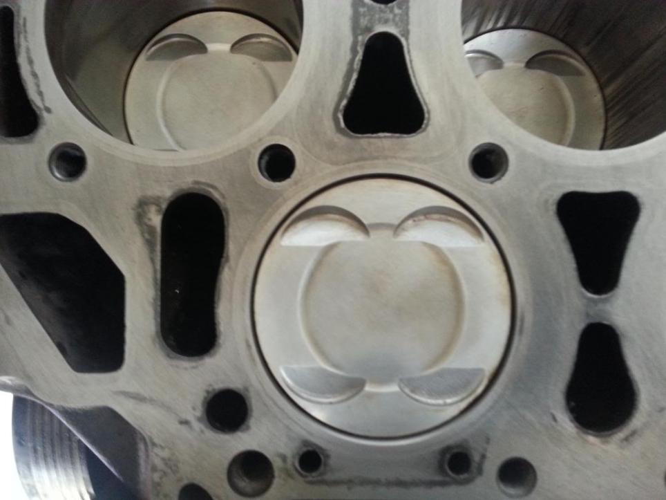

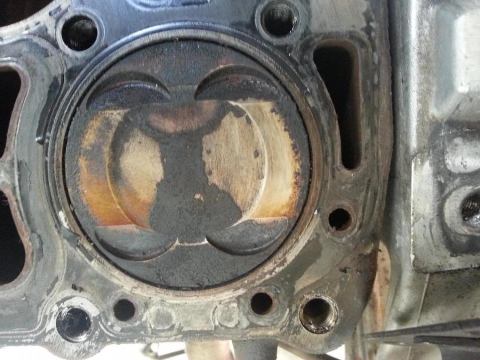

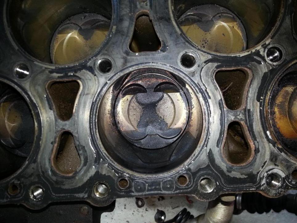

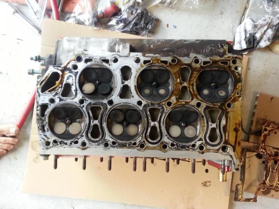

                    Anyway the head finally came off and the engine gave me quite a shock. Damn she dirty.
                    Was really quite worried at this stage until i started the cleanup an the stuff came off pretty easily. The crap on the pistons was coming off basically with a spray of the carby cleaner.

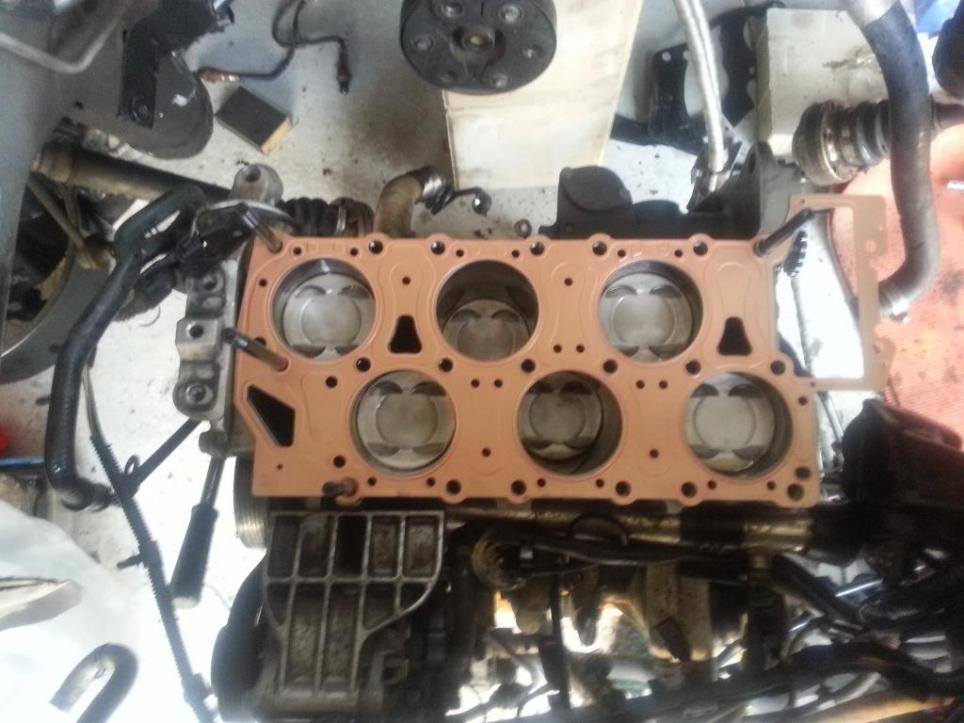

                    Heres the end result. Cylinder liners are dirty but i did clean them. Residue black is the head stained. Its all flat.
                    Major worry i have at the moment is that all the crap off the head has and will go straight down the oil and coolant galleries. However this should be fine and the stuff is all very small and soft so it shouldn't get caught in the bearings. Note i only used a scraper and scotch brite as using sandpaper can cause a lot of issue if the particles come off into the oil galleries. However a flush of oil and coolant should clean this right up.

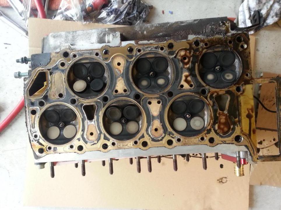

                    Head was kinda in the same condition.
                    With head gasket
                    Without head gasket
                    Cleaned up. I missed a bit on this as it was getting late and its very hard to clean all of the crap off but the majority is done so that should be good.

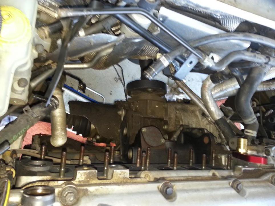

                    Head studs installed.
                    Then removed cause the gasket and spacers wouldn't go back on... sigh
                    Didn't get any photos of the head back on because... well that stage was late and i was frustrated.. specially as i managed to drop the first washer straight down into the sump....i hope....But i got the rest of the washers and nuts on quite painfully i don't quite like studs. I'm going to have to lift the engine, undo the sump take the washer out and then redo the sump back up as its sitting on the sump at the moment. Then i can torque all the bolts up and wait for the upper timing chain pieces. Thankfully there's still a lot of cleaning and prep work to do before that and the clutch and flywheel. But all in good time

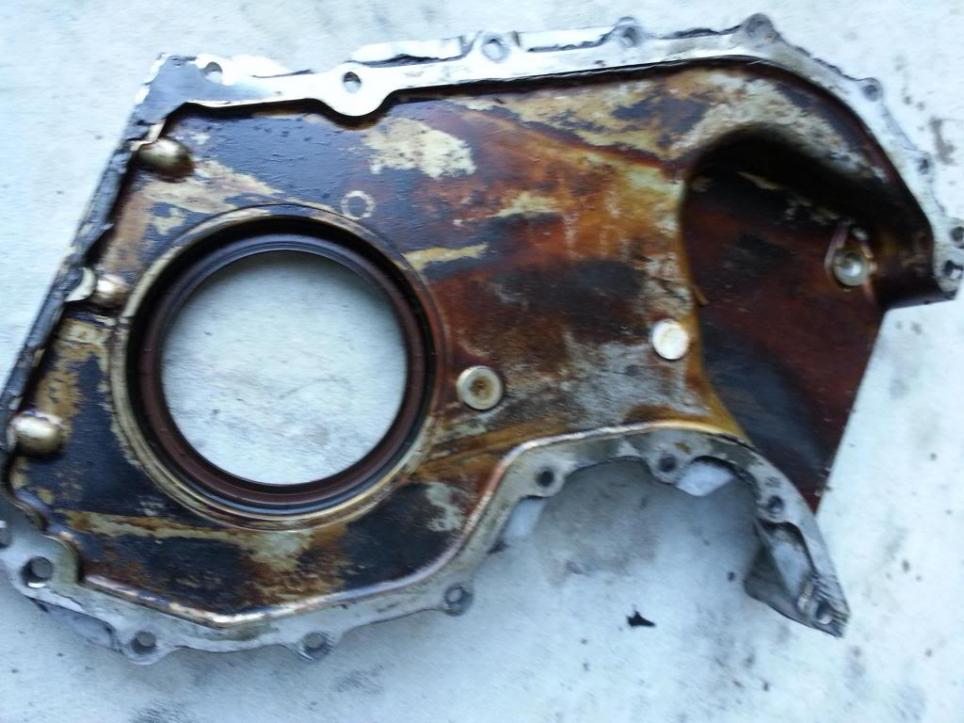

                        • YAY! got the freaken washer out of the sump without having to take it off.

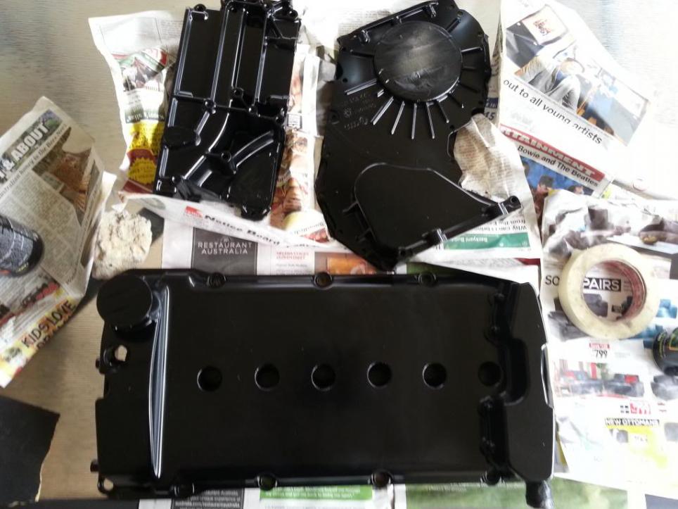

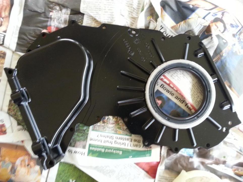

                              • Not along of progress lately, just waiting on timing chain parts coming from germany and a clutch and flywheel. Then i can start putting the engine back together and start building the exhaust.

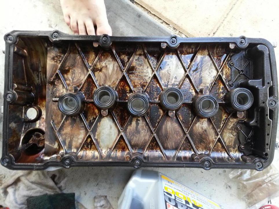

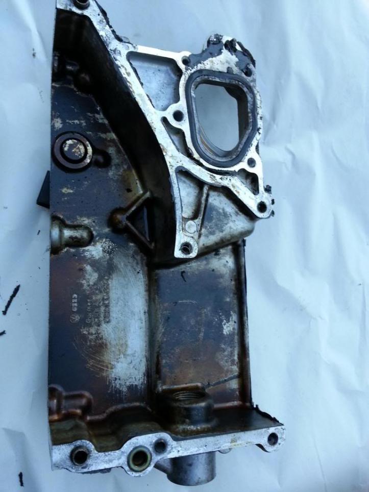

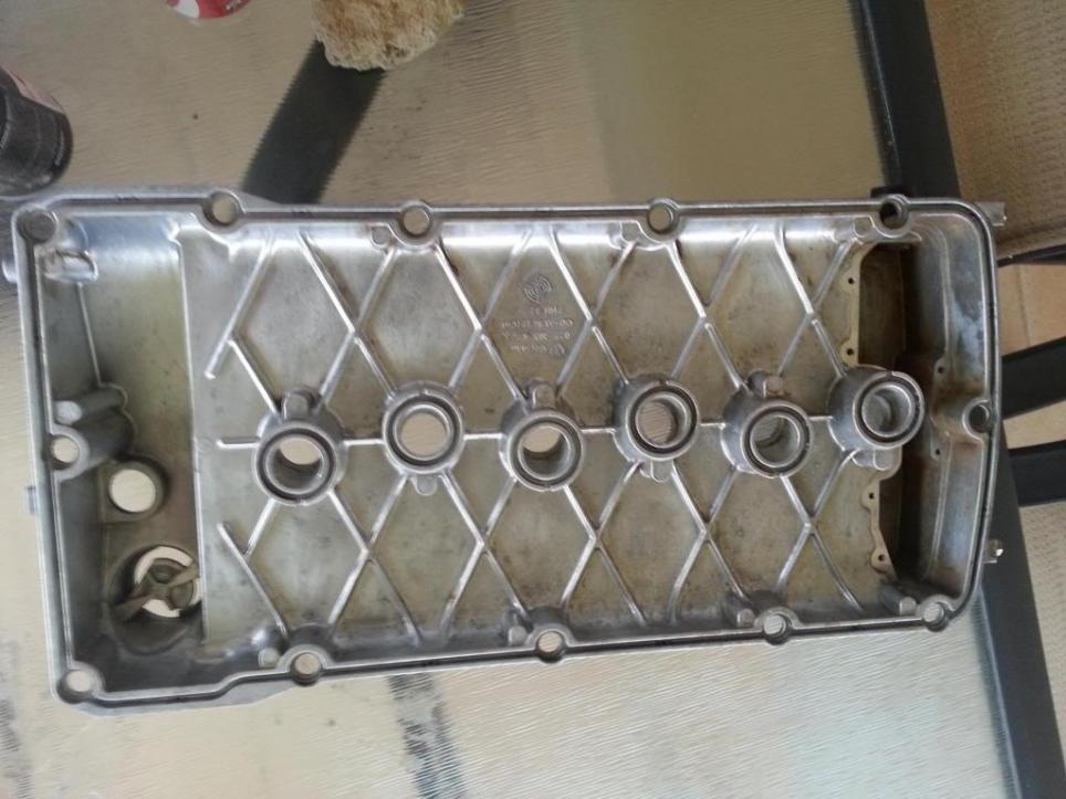

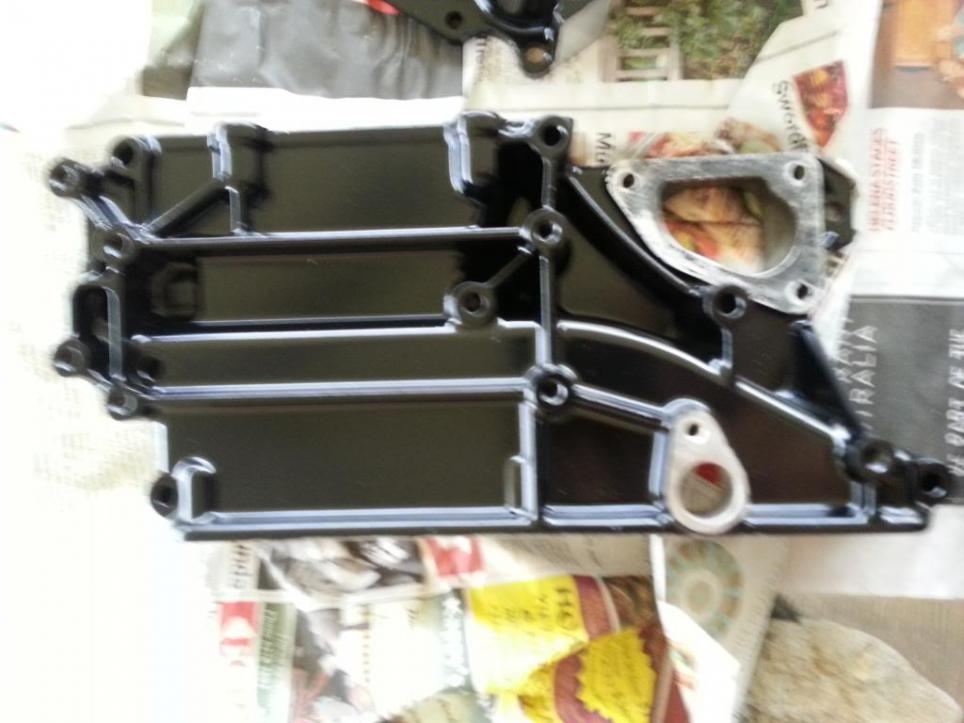

                                Just cleaning up some pieces.
                                Rocker Cover before.
                                Timing guides before
                                After
                                And painted.

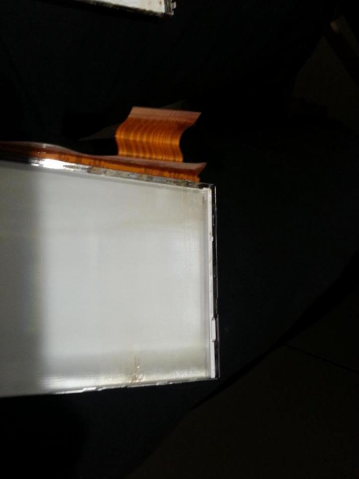

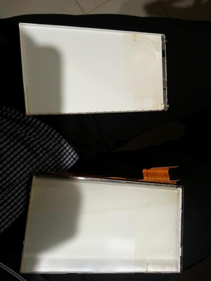

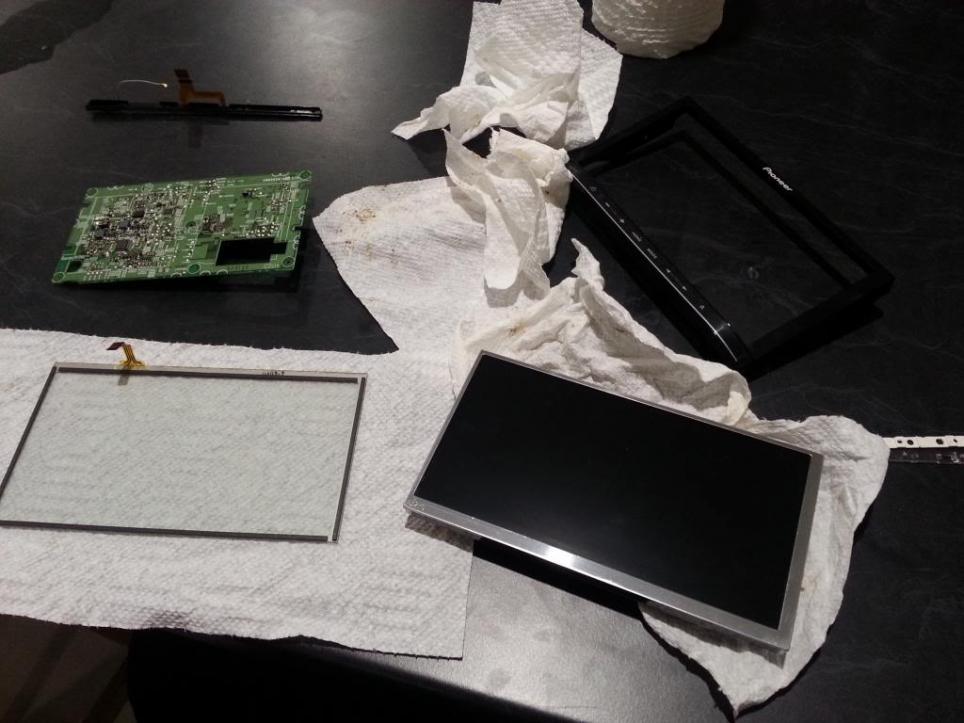

                                Also decided that i would take apart my old head unit to see if i could clean it up and get it working. Wow was there a lot of coke syrup type stuff all underneath the screen. No wonder it was screwing up. No good photos though. Hopefully it works again when i can power it back up. Otherwise its a much cheaper replacement screen at only $180 compared to $850
