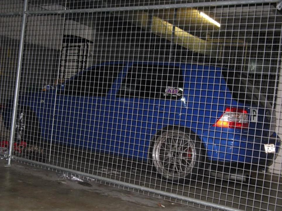

    Looked again at the pile of things to fit to her...
      Is she getting driven at all Neil?
