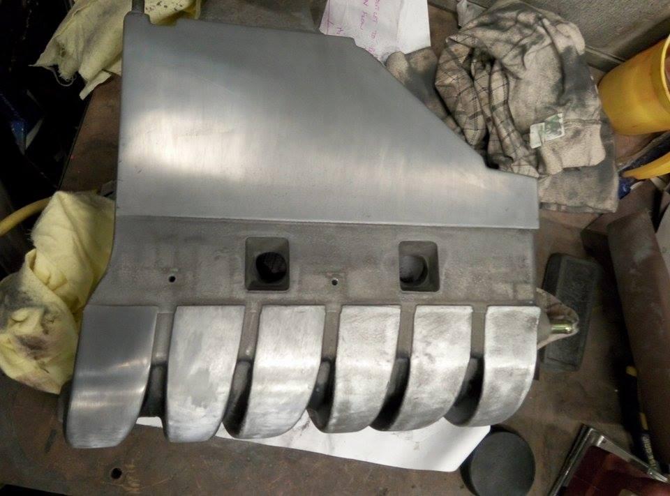

    Started to polish a spare manifold:

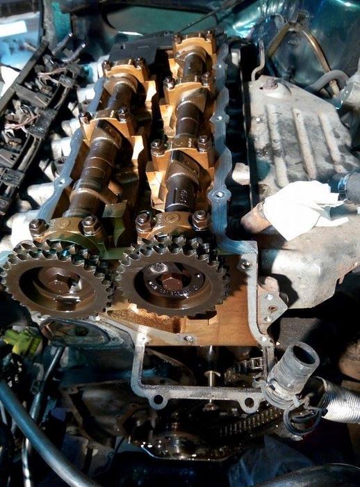

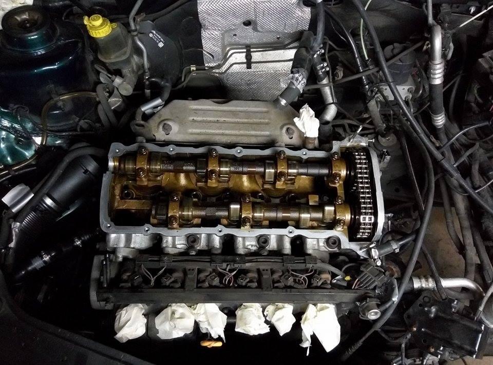

          Yesterday I tackled the timing chains. It was a bit scary knowing the potential risks, but after reassembling everything (with the new parts of course) all the alignment markers seemed to be spot on.
          Side covers and upper chain removed:

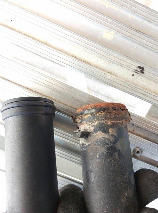

          Today I redid the crackpipe/thermostat housing, everything went well. Definitely glad I did it, here's a photo of new vs. old of the crackpipe:
          • #50
            wow...big difference. Did you go for the OEM one or did you upgrade to a billet item
            • #51
              I just went for another OEM one.

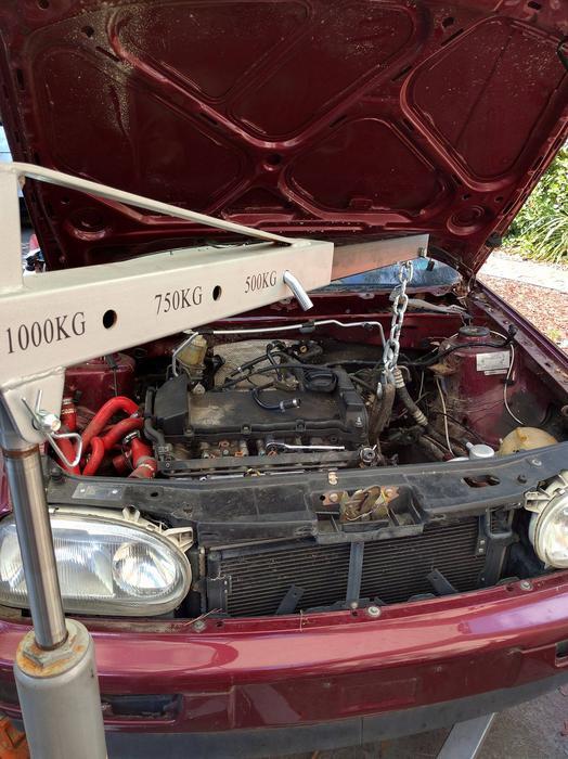

                Have had a long break, I'm now back am back at it over summer.

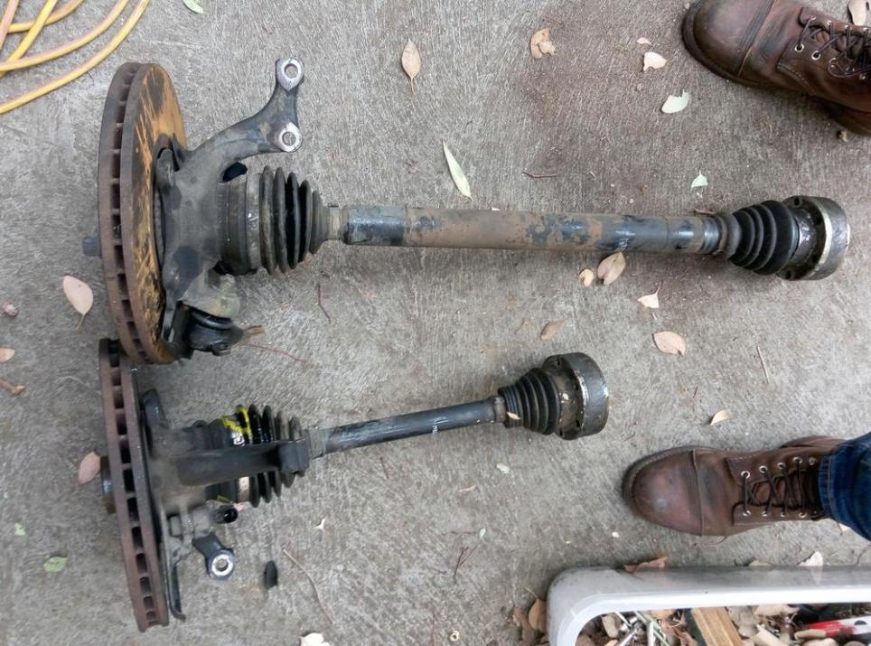

                I had a terrible time trying to get the axles out of the hubs. Had the specialty tool which clamps via the wheel bolts and drives the a bolt through the centre to push the axle out. Long story short, it didn't work. Decided to remove the whole assembly instead.
                The brake pads were a bit tight removing them. Is there any way to open the callipers up a little? I imagine the others will be a tight fit.

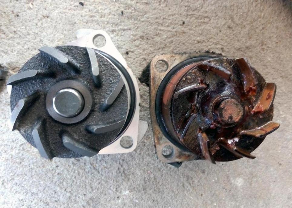

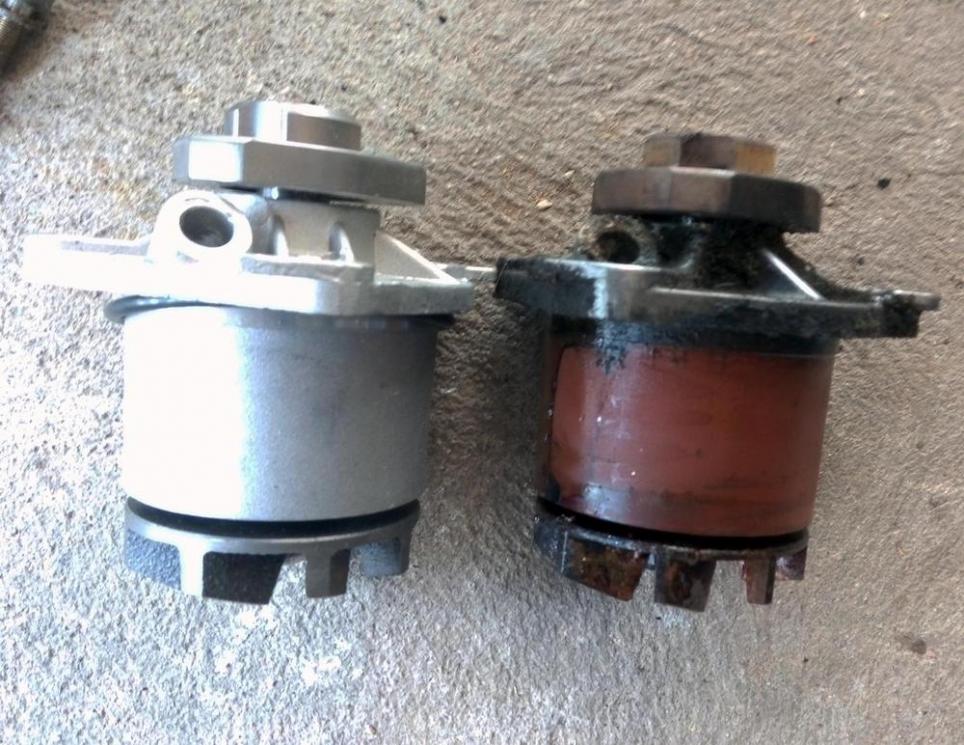

                I replaced the water pump as well as a precautionary measure.
                New vs. Old:

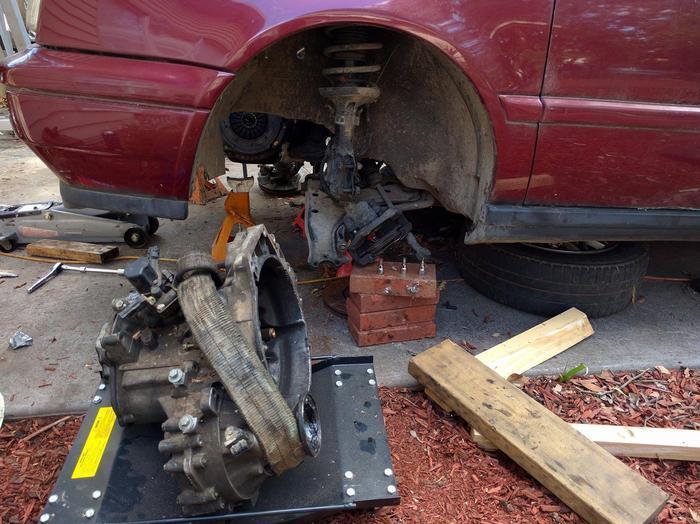

                • #53
                  Removing the manual transmission:

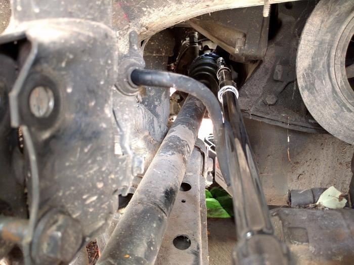

                  Removing the driver side axle:

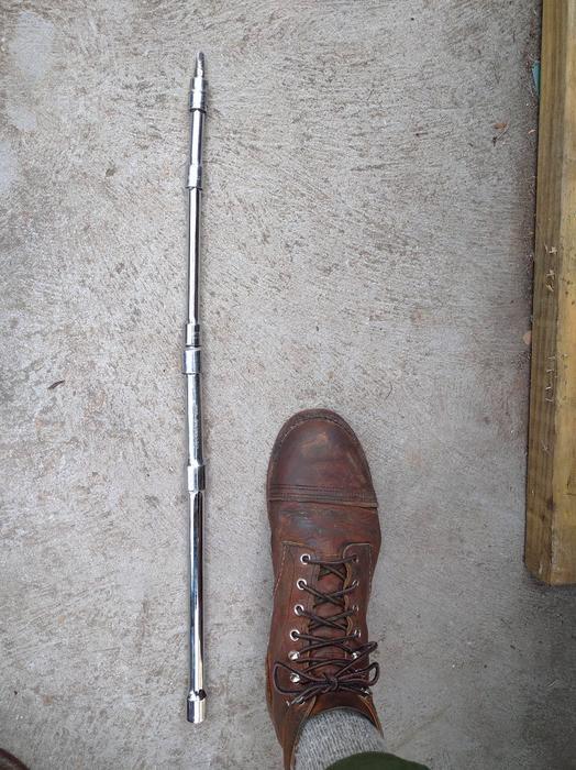

                  It was a long reach:
                  Pulled out through the passenger wheel well:

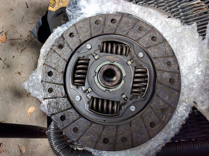

                  The clutch:

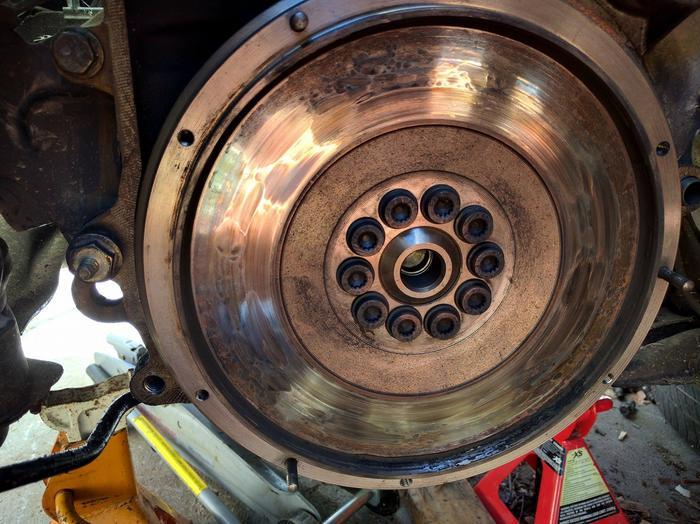

                  Flywheel:

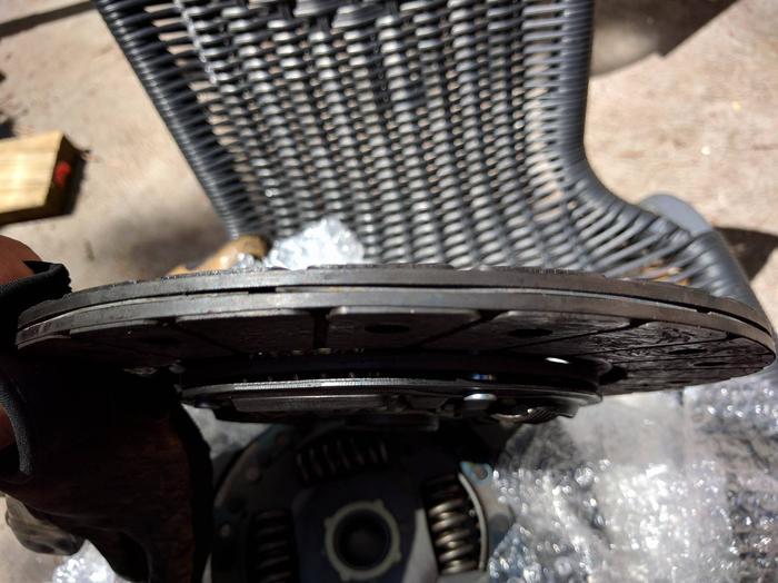

                    I'm wondering if the flywheel/clutch are suitable to re-use? It was allegedly installed <1000km's ago and from my knowledge it all looks to be in great condition. Are there any red flags to look for?
                    Thanks
                    edit:
                    A profile photo of the clutch:
