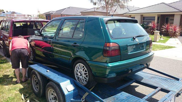

    Pictures from when I picked her up:

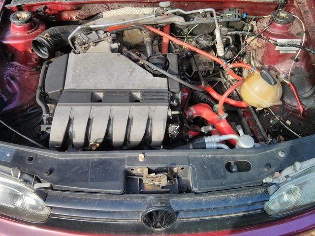

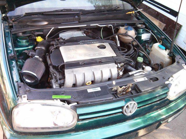

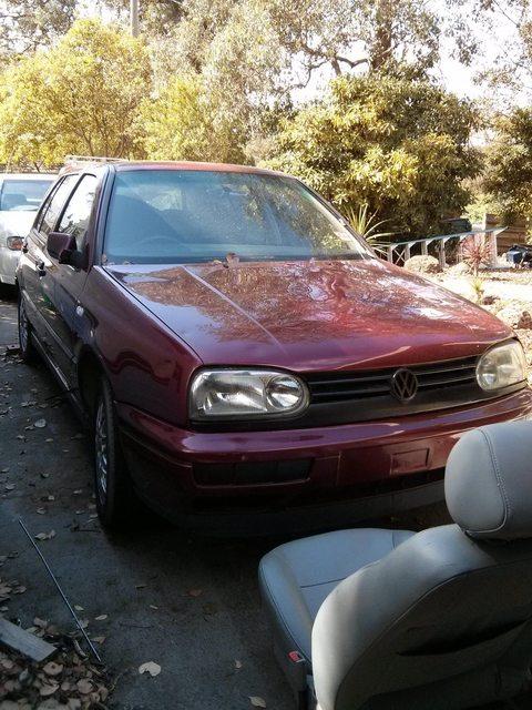

              Donor Car:
              Donor Car Engine Bay:

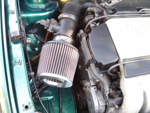

              I did a test fit on a K&N filter from the donor car to see how it would look. It frees up a ton of space in comparison to the stock intake.

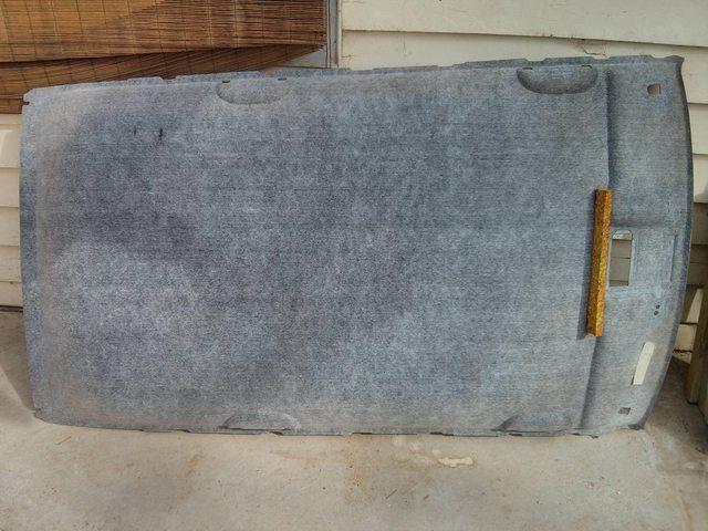

              I removed the headliner from the donor car, but my main one has a sunroof and the donor doesn't. I think it will be a pain to try and make the headliner work. Ugh!

                yep, removing the stock intake frees up heaps of space. Increases airflow around the engine and made it run slightly cooler. That's what I found anyway.
                Past - '95 VW Golf MK3 VR6
                  Don't run a filter straight of the maf. Add a length of pipe to get the filter down to the headlight at least
                    Is this to force more clean air into it?
                      Air less turbulent so the maf gets a more accurate reading

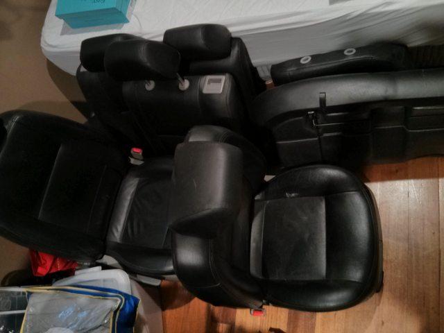

                        MK4 black leather seats waiting to be installed!
                          nice seats
