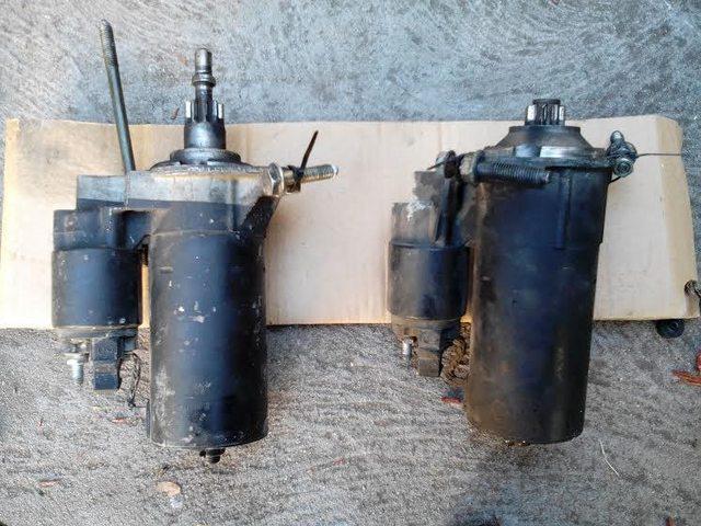

I used my original starter with the shorter bolts due to the thinner bell housing on the manual and the different front mount.
