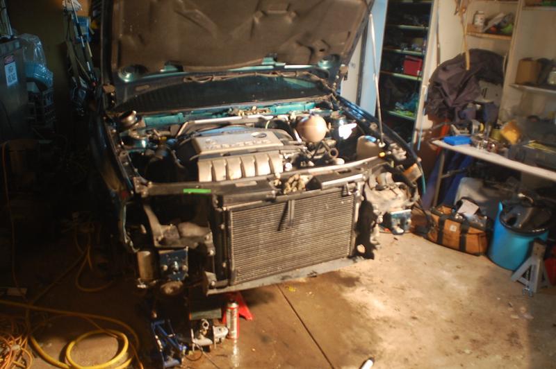

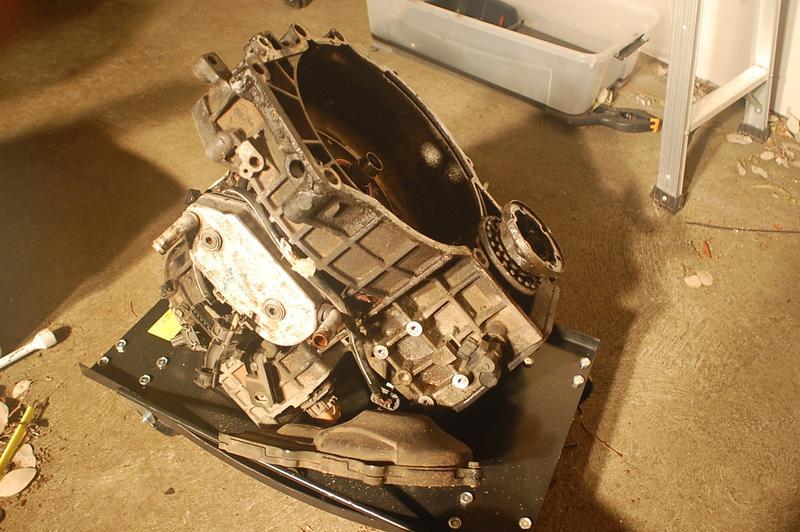

      • #33

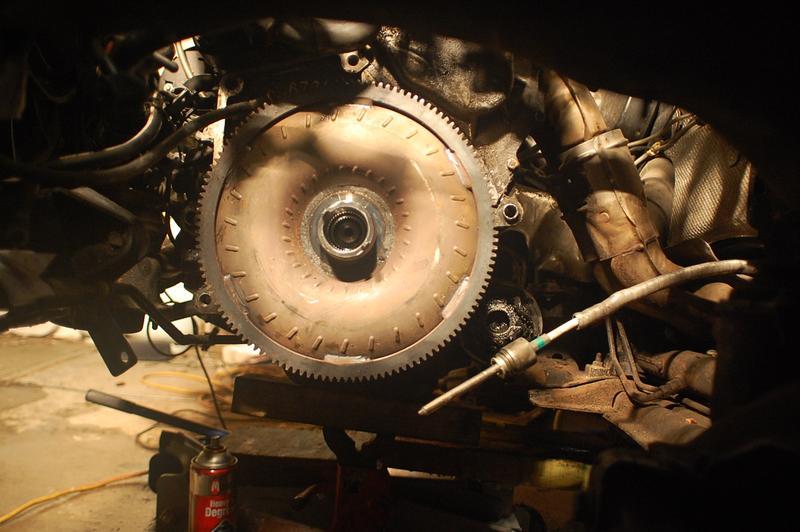

        Pulled out the auto transmission! The thing is huge, and insanely tight to manoeuvre in the engine bay.
        I missed the torque converter bolts when removing the transmission, which left even less space to move things around. I ended up rotating the whole transmission by 90* degrees clockwise using and engine crane + jacks/jack stands, which allowed it to slide straight off! Definitely the easiest way to drop the transmission, especially if you're doing it solo.
        Torque Converter still attached to the engine:
        (picture taken from left wheel well)
        And here is the car resting in the garage:

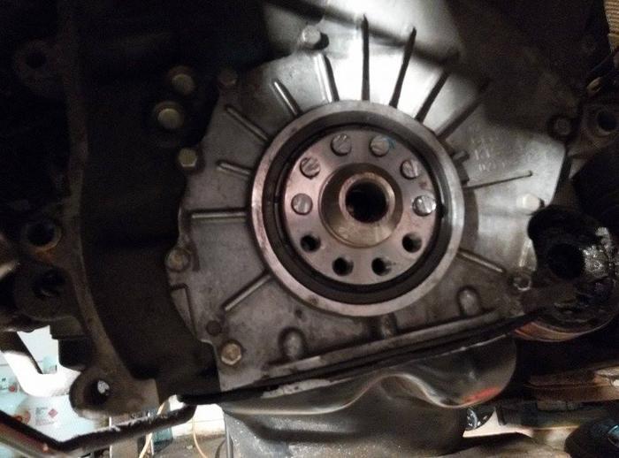

                  My impact gun stripped one of these bolts and the rest are pretty soft too. (not my picture, mine's a drive plate, not a fly wheel).
                  Pretty frustrated, not looking forward to trying to get these out. Not sure how I'll do it. Heat it up a bit, use a chisel to try and bite into the bolt and chip it loose?
                  Ugh.
                  • #39
                    Ouch. ...
                    Vice grips
                    • #40
                      Grind the head off, once there is no pressure on the threads it will thread out easy. The are insanely tight so I doubt anything would get them loose while still under pressure.
                      • #41
                        I'm worried I'm going to grind the heads off and be left with seized headless bolts in there though :-/ I guess I'll have to test my luck.
                        I think I'll try a few alternatives and then I can always resort to grinding the heads!

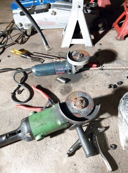

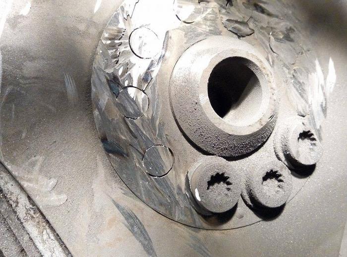

                                So, I decided to try and grind the bolt heads off...
                                The tools:
                                After half an hour (changing discs, etc):
                                After I ground down the metal I was able to get the drive plate off!
                                Gif of me pulling the plate off:
                                Imgur
                                The remaining bolts were quite firm, but using some vice grips I was able to start taking them out:
                                Thanks for the input on helping me remove these!
