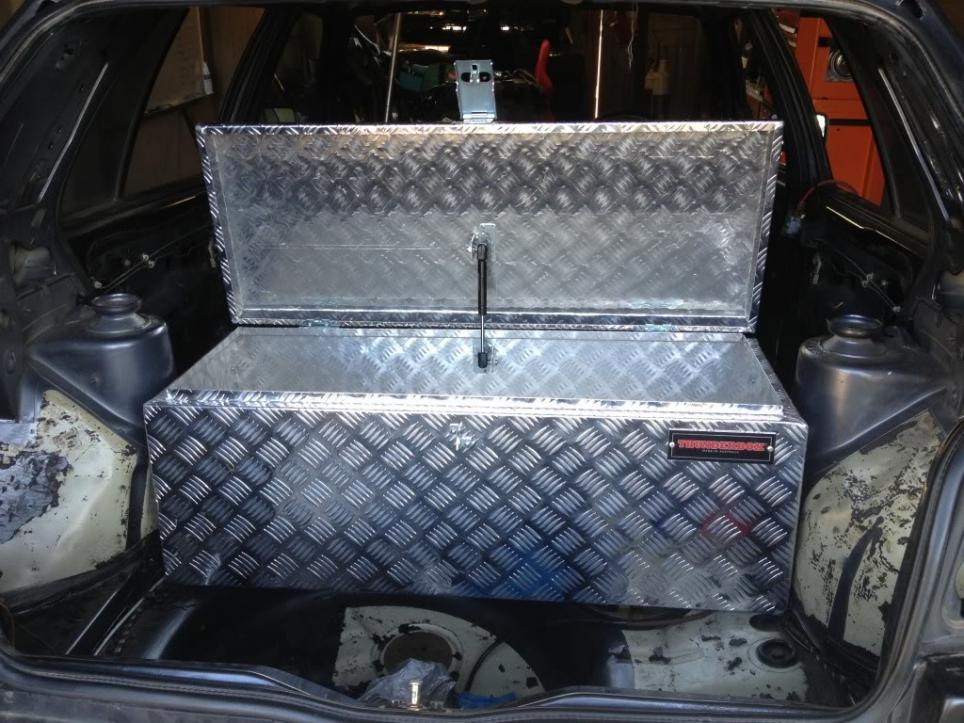

      Fuel cell rocked up as well. We have decided to still run it. Shouldn't be too hard to seal it off from the rest of the cabin. Will just put the entire system (fuel cell, surge tank, filter and pump) in a cheap, sealed aluminium tool box in between the rear shock towers. Hardest part will be finding one suitable. They all seem to be either too long to fit between the shock towers, or not tall enough to fit fuel cell in.

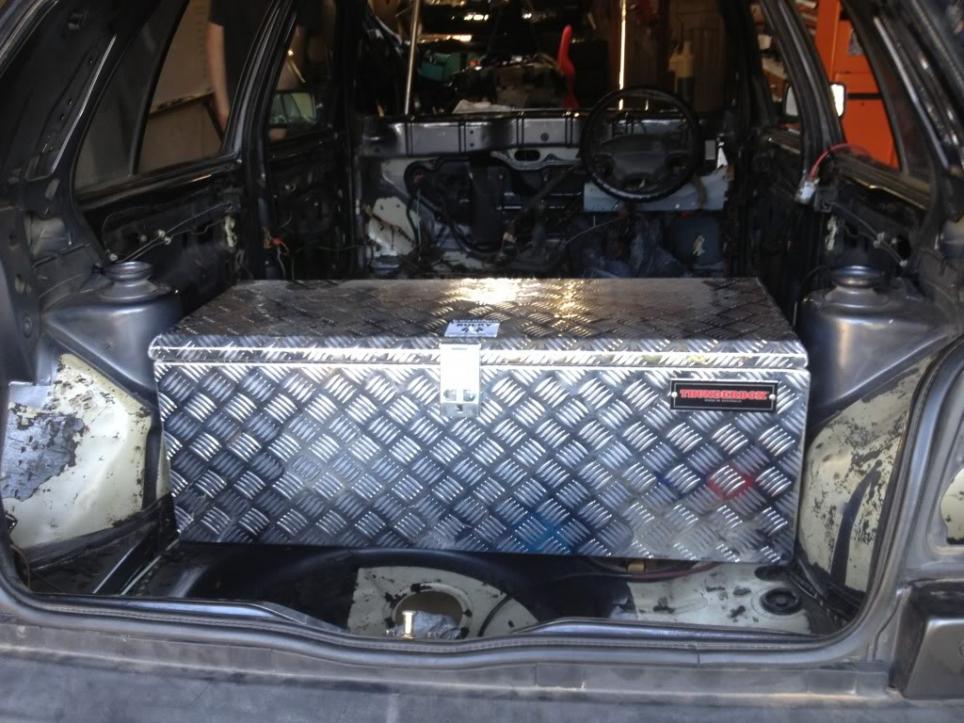

                Scored a tool box for the fuel system. Perfectly sized to fit between the shock towers. Isn't as heavy as it looks, either.
                Hopefully the surge tank arrives this week.

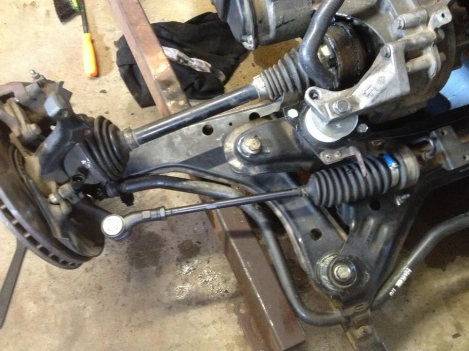

                Have finished one side of the suspension refresh kit. (Ball joint, Tie rod, lower control arm bushes.)
                We will need to take the drivers side driveshaft out before we finish changing suspension bits. It seems we may have wrecked the driveshaft flange seal when we were knocking the wheel off with a sledgehammer (was stuck to the hub)

                • #98
                  ^ This side good, Other side not so good.. yet haha
