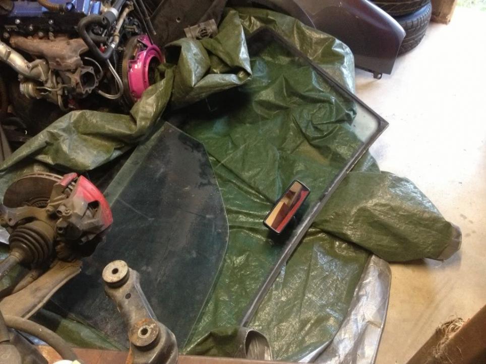

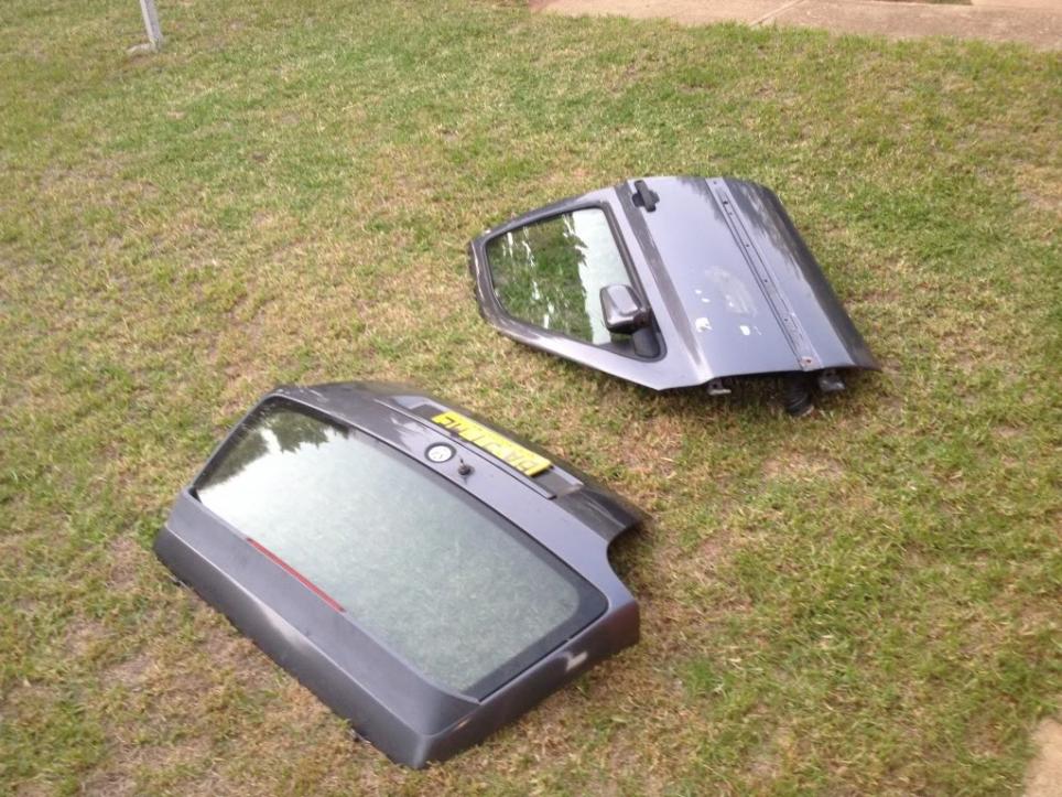

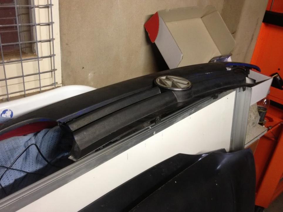

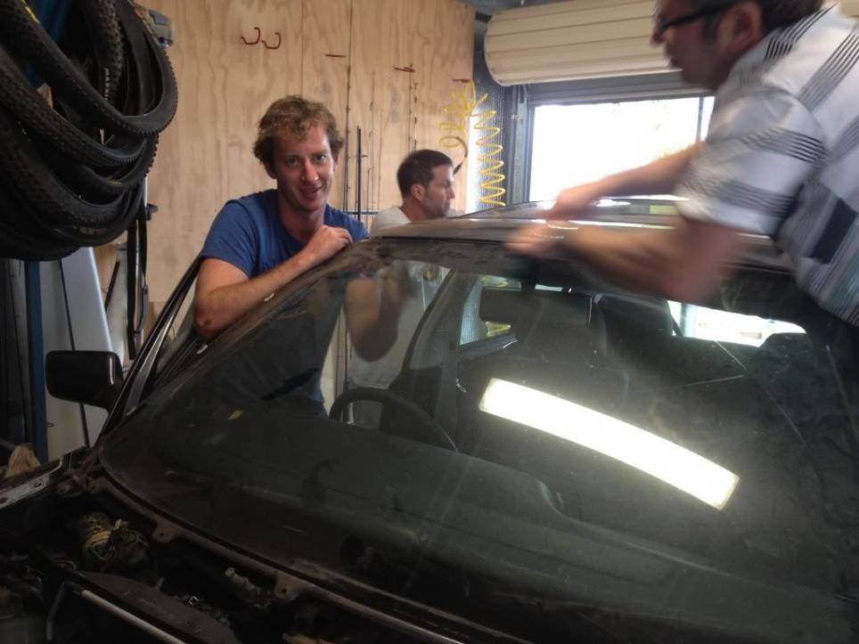

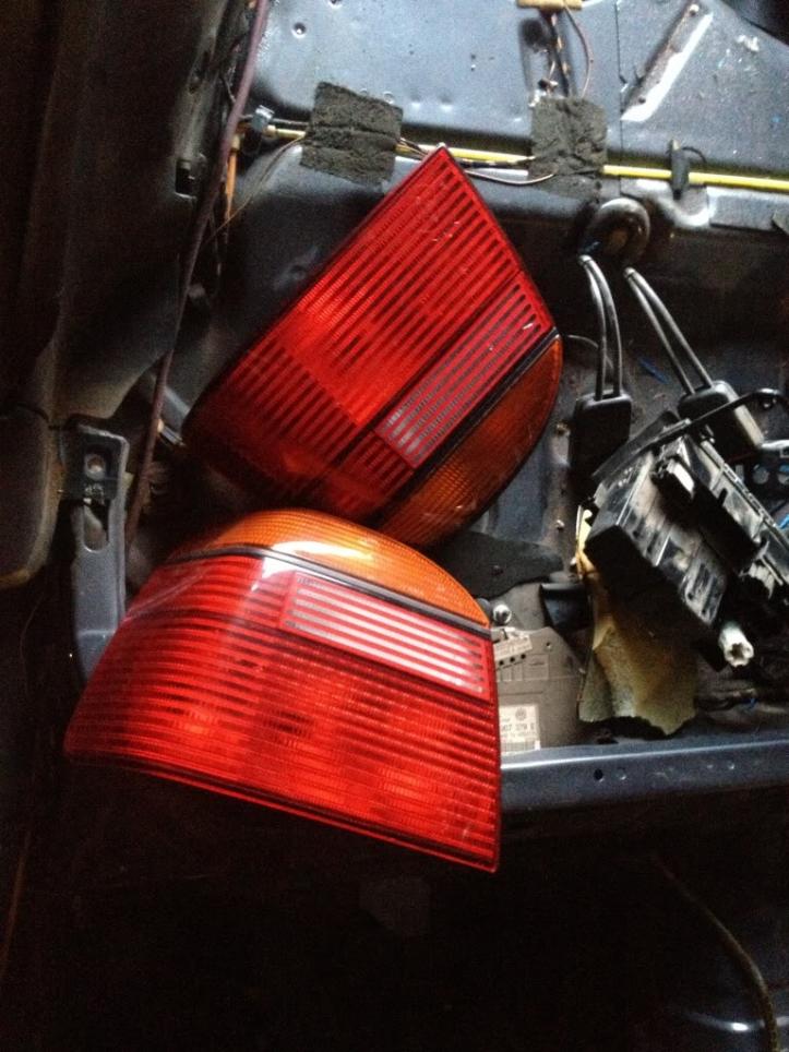

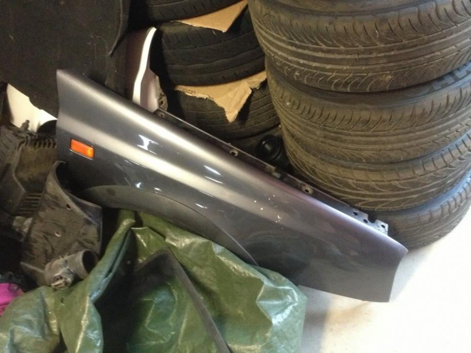

My mate Brad and I took a 4 hour drive to Kangaroo Valley to pick up some parts, off Smeeeb.
Now this would usually be fine, except one of those parts was a windscreen that we had to remove. Never having removed a windscreen before, we began praying to Lord Goku. For anyone who doesn't know how this is done: You need to saw through the glue holding the windscreen to the body. Easier said then done. Luckily, I had taken a trip to Obrian's Windscreens the day before and picked up some wire and got a few pointers off a very helpful staff member. After a solid 2 hours of sawing through glue, snapping wire, swearing and cutting ourselves, we were able to remove the windscreen with no cracks! Jordan's dad kindly removed the rest of the panels we needed!

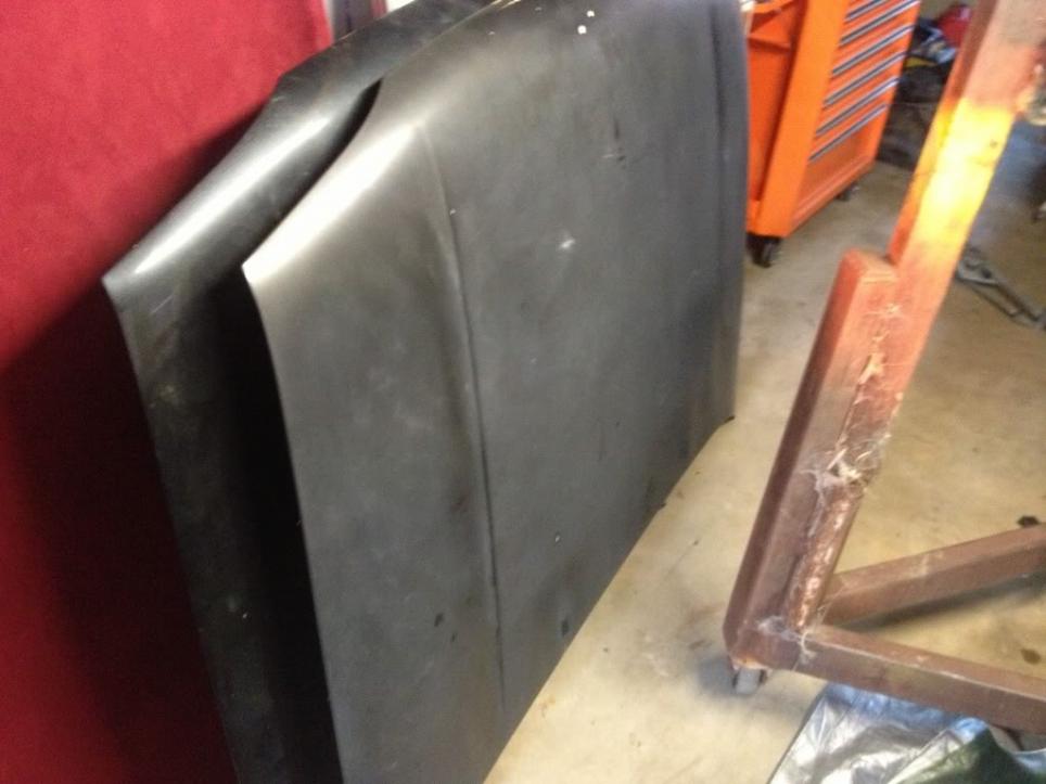

So we ended up picking up:
Windscreen
Bonnet
Front Bumper
Front Grill
Front Drivers side fender
Front passenger side door
Rear hatch

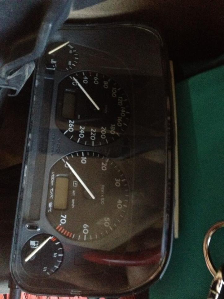

VDO Instrument Cluster
Glove-box

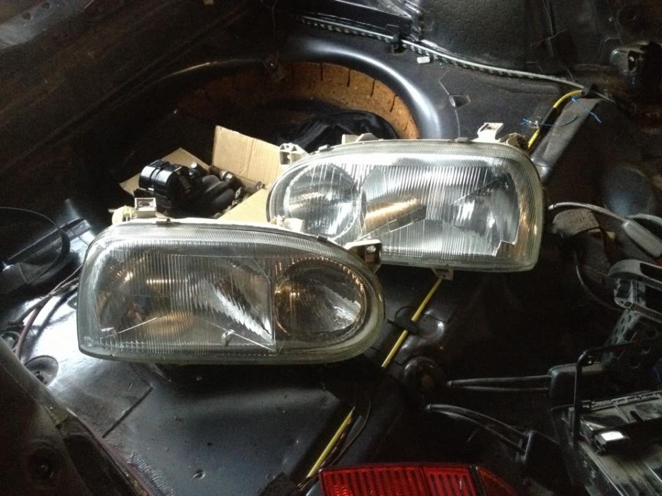

Headlights
Taillights
Few misc. pieces (Pretty much everything we need is sorted now!)
4 hour drive home, unload the parts, and Zale and myself stripped most of the racecar!

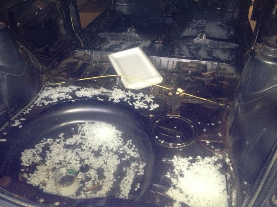

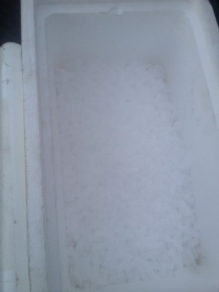

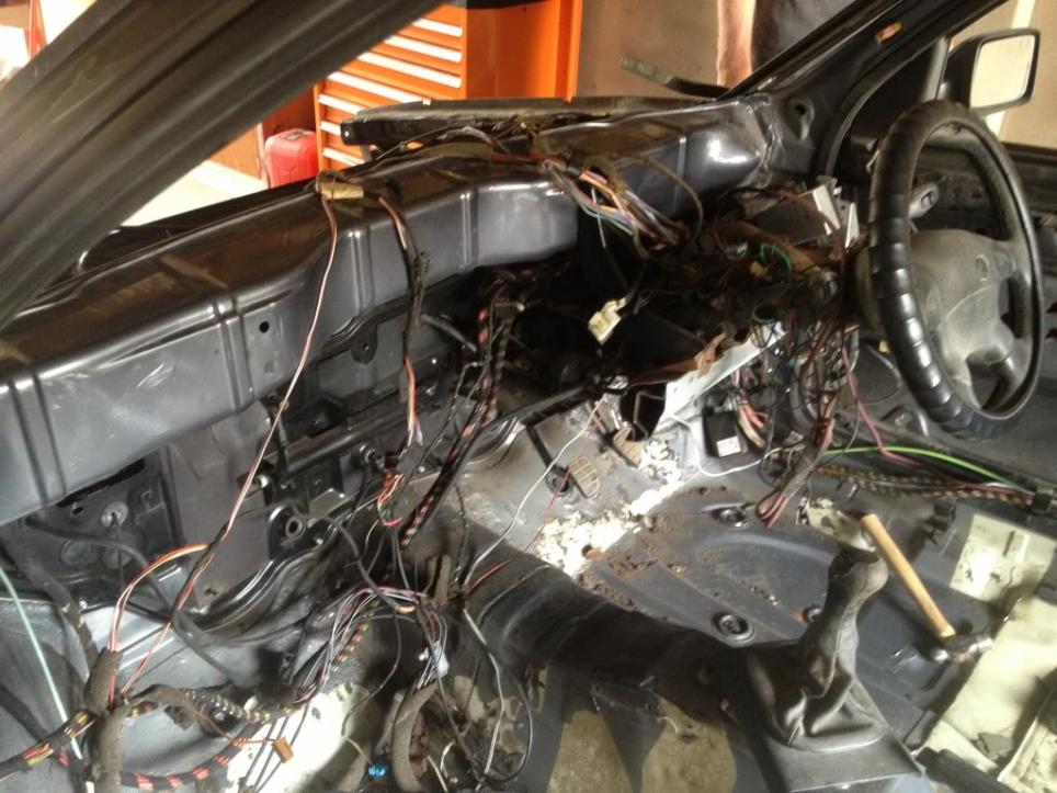

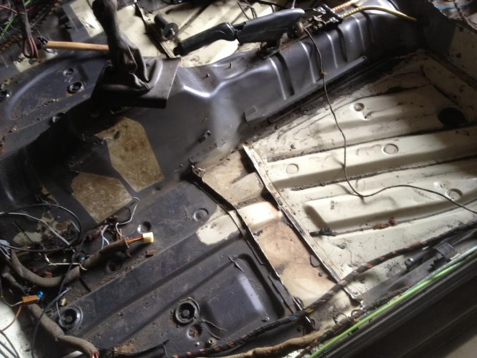

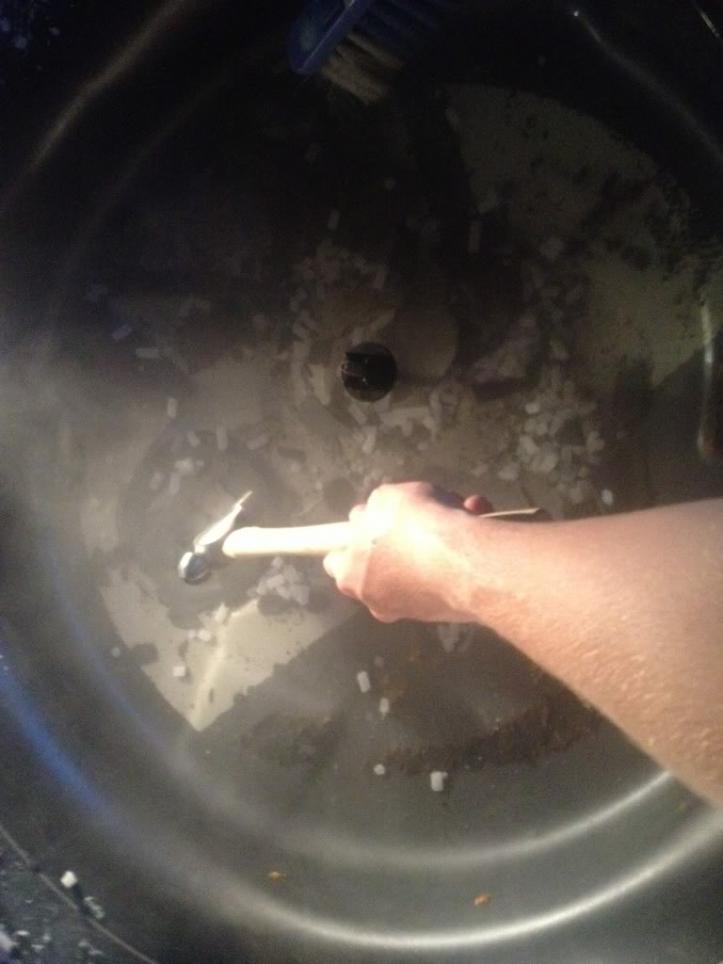

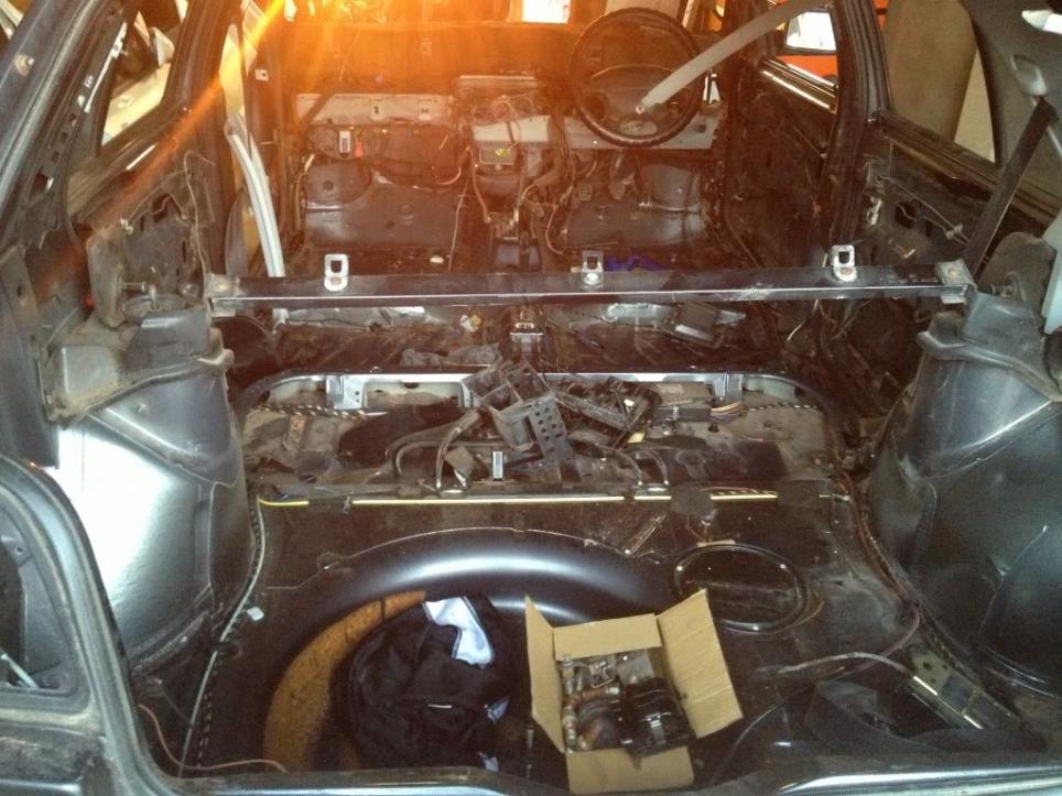

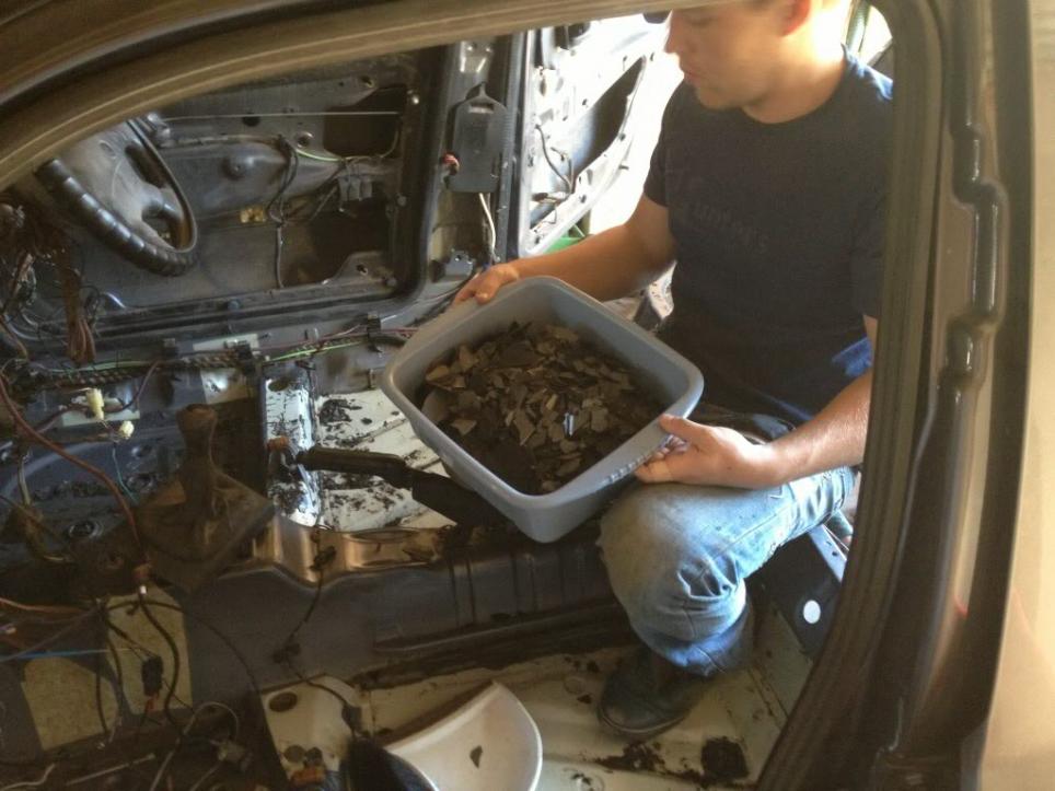

Another 40-50kg of unnecessary weight stripped from the racecar. This time, we needed the help of some power tools and dry ice.
Using the dry ice, we froze the sound deadening, which made it easy to shatter with a hammer. Caution to anyone wanting to try this for themselves, -76 degrees celcius will quickly give frostbite to any bare skin. Will probably need to get a bit more, still need to remove some from the front footwells and rain tray.

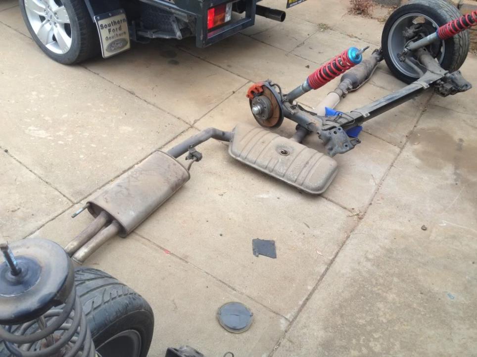

We removed the heater core (what a bitch!), fuel tank, exhaust and stock rear beam (in preperation for our new beam with better brakes and swaybar.)
Cut the front and rear seat rails out, and cleaned the engine bay up a bit. In preperation of engine refitting.

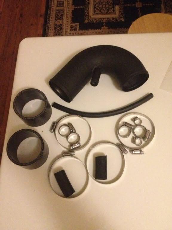

Still waiting on engine mounts, new engine pulleys, belt and power steering delete. We did however, recieve our upper intake piping from 42draftdesigns. This gives better flow and longevity over the stock plastic corrugated piping.
Still so much to do!
