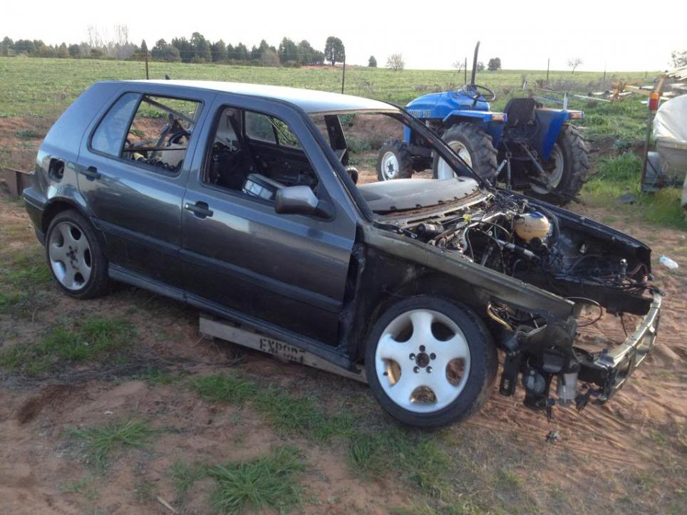

    Our story begins with my brother Tom buying a MK3 VR6. Unfortunately, debt got the better of him, so he was forced to sell the VR6 and the new owner decided to strip it for some quick cash.
    This is how it sits now:

    The grey VR6's motor will be fitted once more to its original body. We will be focusing on weight reduction and suspension set up. The engine will remain relatively stock for the time being.

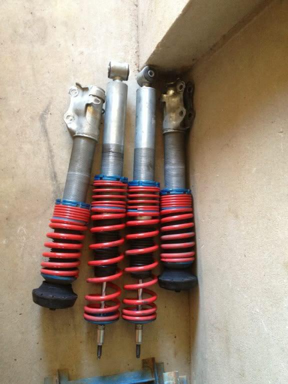

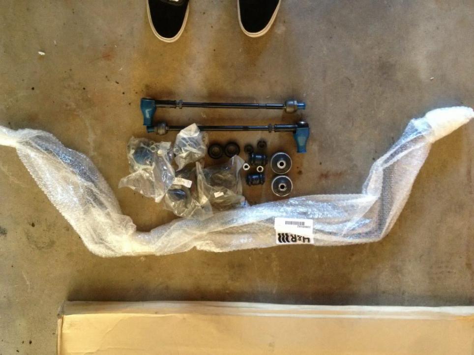

    We took a quick trip to Sydney yesterday (read 5 hours there and back) and picked up some things from Seb at Euro Automotive. 24mm H&R Front swaybar, Raceland Coilovers and a suspension refresh kit.
