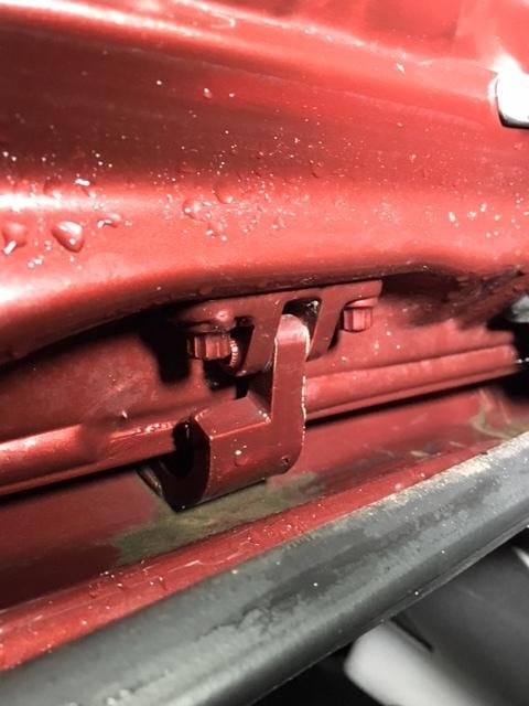

well tried to swap the hatches tonight but the rains came so i decided to call it quits.
was stuck anyway with the 4x male torx bolts holding the hatch to the hinge.
anybody know what size they are?
i'll probably head to bunnings tomorrow to see what i can get to take them out...Last edited by doridori; 09-12-2015, 09:02 PM.2010 Jetta 125TDi DSG
1994 Golf VR6 Manual
you mean the 2 bolts that you can see pointing upwards which attaches the hinge to the tailgate in the above photo?
so they're 13mm? i had a look at the bentley manual but it doesn't state what they were but if that's the case i'll drop by bunnings for a 13mm torx bolt socket (is that the right name?)2010 Jetta 125TDi DSG

Ah ok, so i got to drop the headliner, reach in there and take them off?Originally posted by HaydEn View PostNo. There's 2 13mm bolts. 1 each hinge that mount it to the body
Replacement tailgate comes with a hinge as well and that had some old car panel sealant (black stuff) on it.
I haven't got any of that so what should i get to apply it on the new hinge before i install it?
thanks for all the help, just trying to learn a bit and have some fun at the same time!2010 Jetta 125TDi DSG
Swapped the tailgates today!
Few issues:
- 99 model tailgate used different diameter vacuum hoses with my 94 car. Luckily I was above to scavenge some rubber connectors from the old tailgate to make it work.
- 99 model interior brake light uses same connector as the exterior wing mounted one on my original 94. Both connect to the driver side tail light.
- tail gate latch on car needed to be adjusted for the tail gate to latch properly
Hope some of that info helps someone
