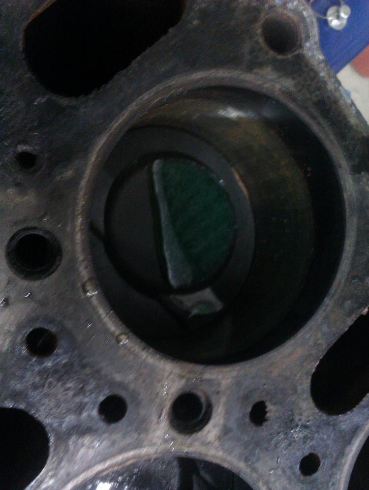

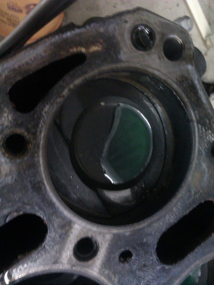

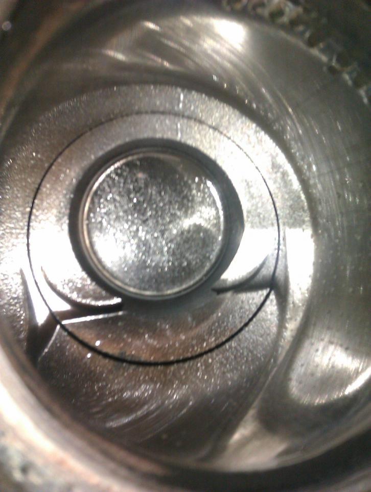

              Ok, so i got around to taking off the head today and after a bit of a look around i found that the timing was off enough that the exhaust valves on the exhaust side were hitting on the pistons and leaving a shiny mark.
              but the timing wasn't out enough and having hydraulic lifters might of helped too but apart from a bit of a smooth patch the valves are fine

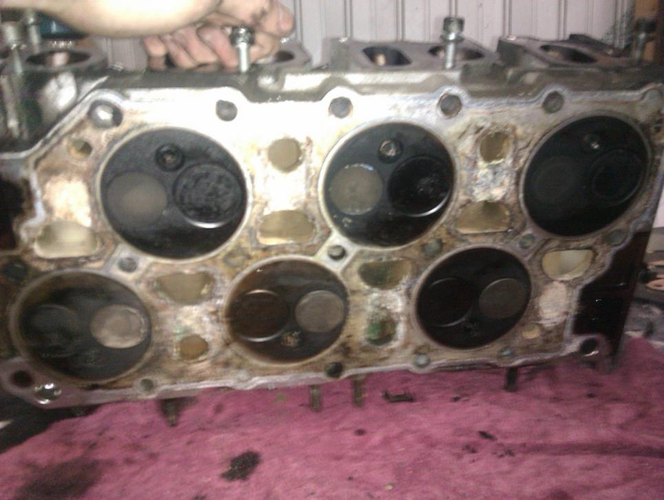

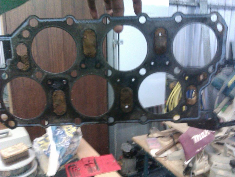

              the other thing is that the head gasket was pretty stuffed and letting coolant and oil into all the wrong places.
              that's all the updates i've got for now. all i have to do (as if its going to be this easy) is buy my new bits, put them on, clean it up, and put it in.

                Get a mk4 headgasket for a bit more hp.
                • #53
                  ya im hoping to. just have to see if the place im buying it from will swap the mk3 one for a mk4

                          Your valves are going to be bent . you dont realise how weak the valve stems actually are , as soon as they touch the piston its all over

                            thats what i thought but they seem to be fine. they look straight and seal pretty nice onto the head. i guess the other question is how hard is it to change the valves in a VR?

                              I'd just get the head reco'd mate, if you've gone this far getting it reconditioned properly would be the cherry on top. That way they'll be able to tell you which valves need replacing etc

                                even if the valves are strait the stem seals will most likely need replacing.
