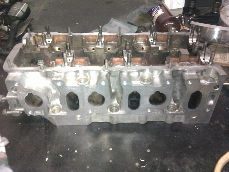

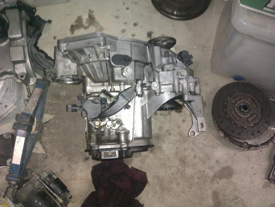

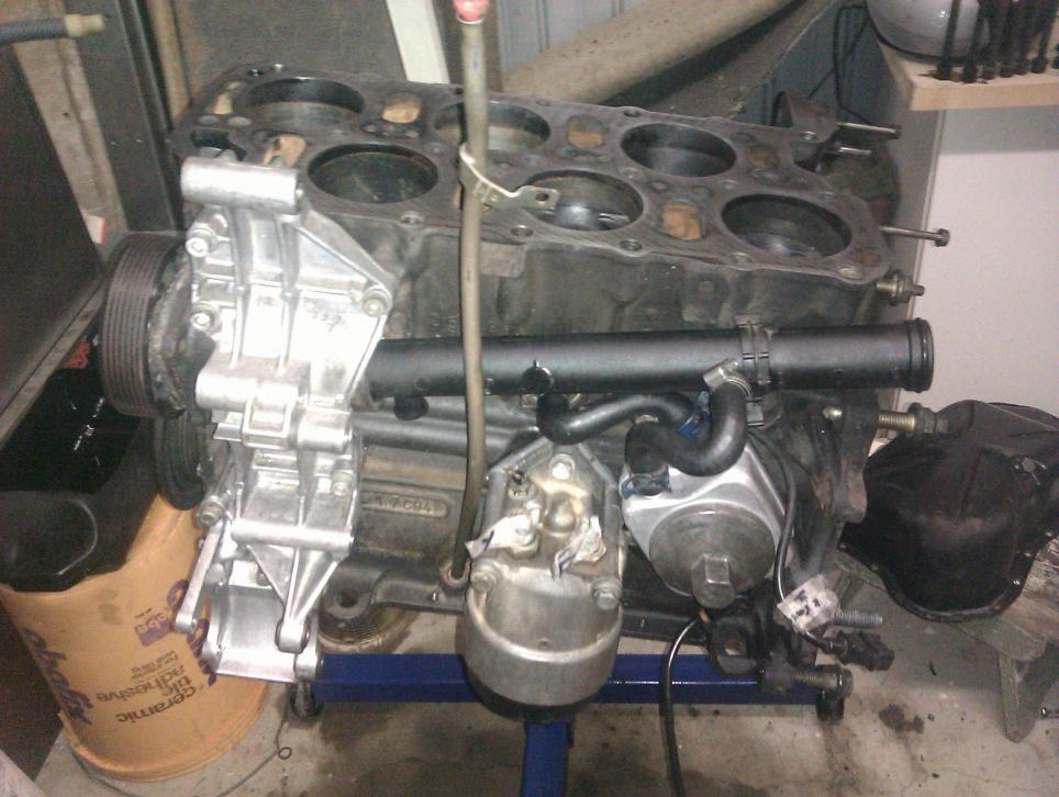

    i removed all the valves and gave them a clean and a relapped. also gave the rest of the engine, trans, ect... a clean and its looking good.

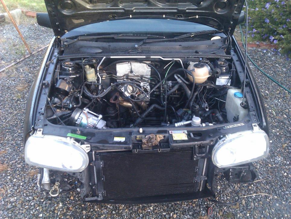

    also washed out the engine bay.
    Now im just waiting for the head gasket kit in the post then i can get the thing back together.
    • #62
      Can I 100% reconmned that your have the head sent off for a refresh by a professional. They will acid tub it, new valve stem seals and a quick skim. This would be a some good money spent so you dont drop a valve or do a HG later on the track. And it wont use oil liek most do with high KM's. So easy with the engine out.
      Please it would be so easy and $450 might seem like a lot now but if you cook it on 8 months time 700kms from home dont be complaining!
      • #63
        x2 on getting the head re-freshed by a pro. It'll be worth the cash and the piece of mind
