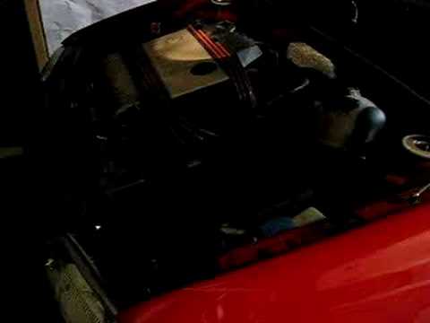

      you meen a slap like this?
      • #33
        Something like that. You'll know something's up as when it's cranking over it sounds brutal

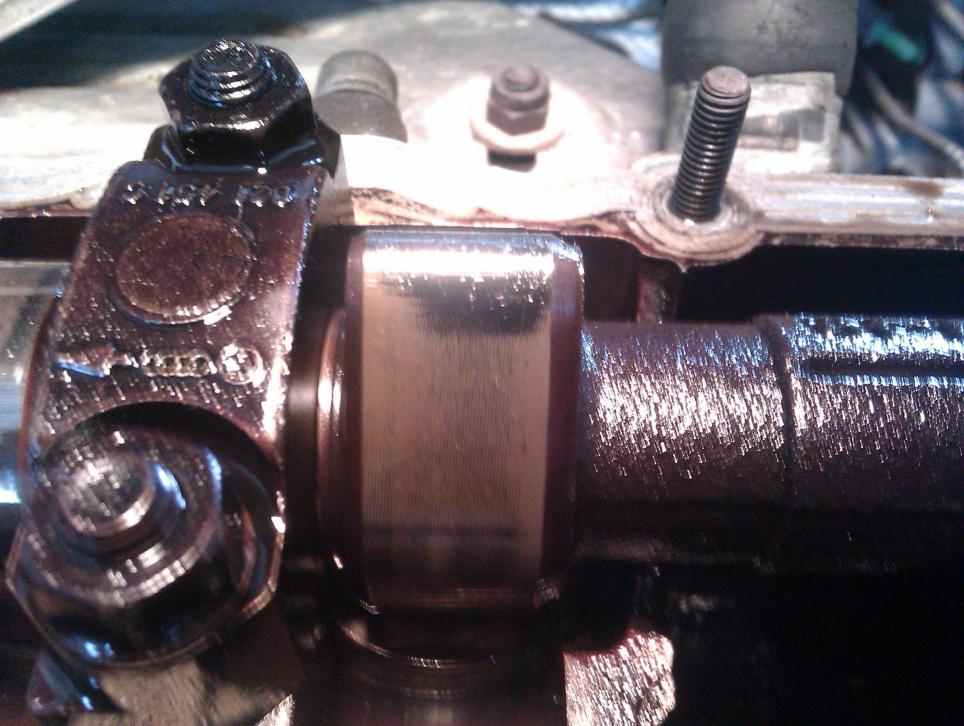

            its a little late for the oil pressure test as ive almost got the engine out but ill defiantly check everything. but what i have found is that there is plenty of oil on the cams and stuff and i don't think there is any heat marks.
            ill get ya a pic of the cams and stuff.

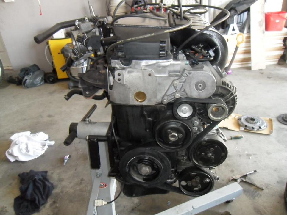

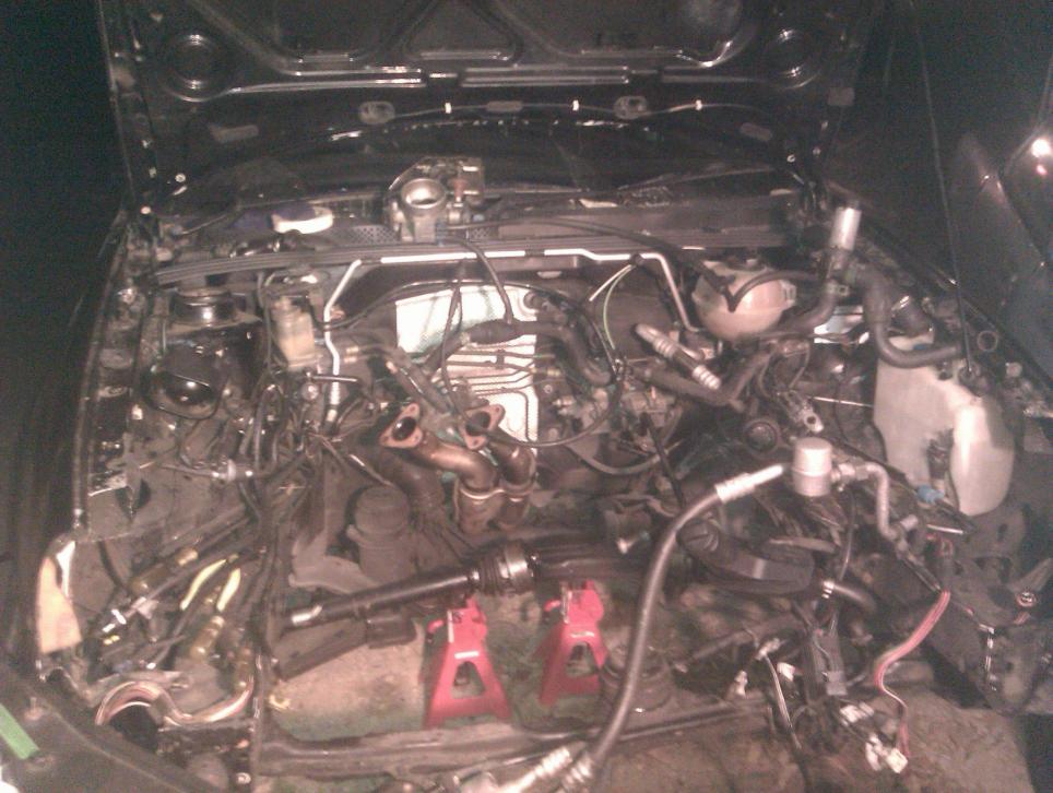

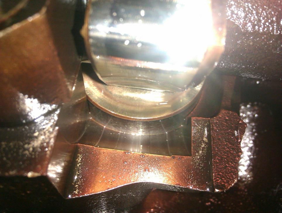

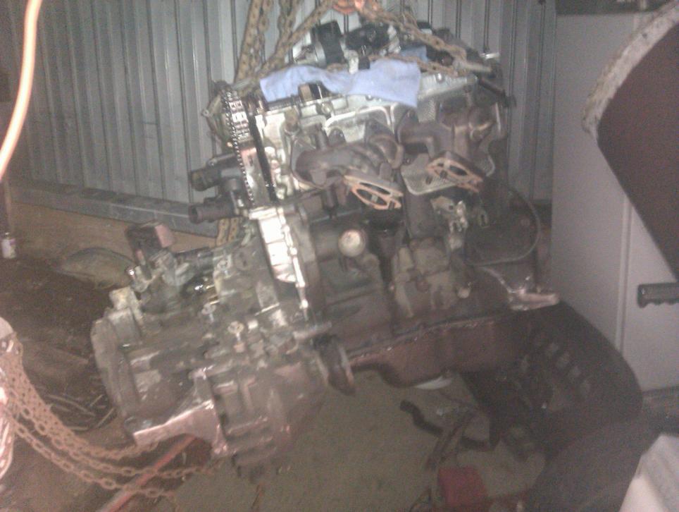

                so i pulled out the engine today:
                also took some photos of the cams as i don't really know what the heat damage looks like.
                now i have to buy/make some way to mount the engine on a stand without using the bellhousing
                • #38
                  Good work. Glad to see you getting in and having a go.
                  Supercheap sell engine stands for $40 and up. I have one, had my vr engine on it for 10 months now.

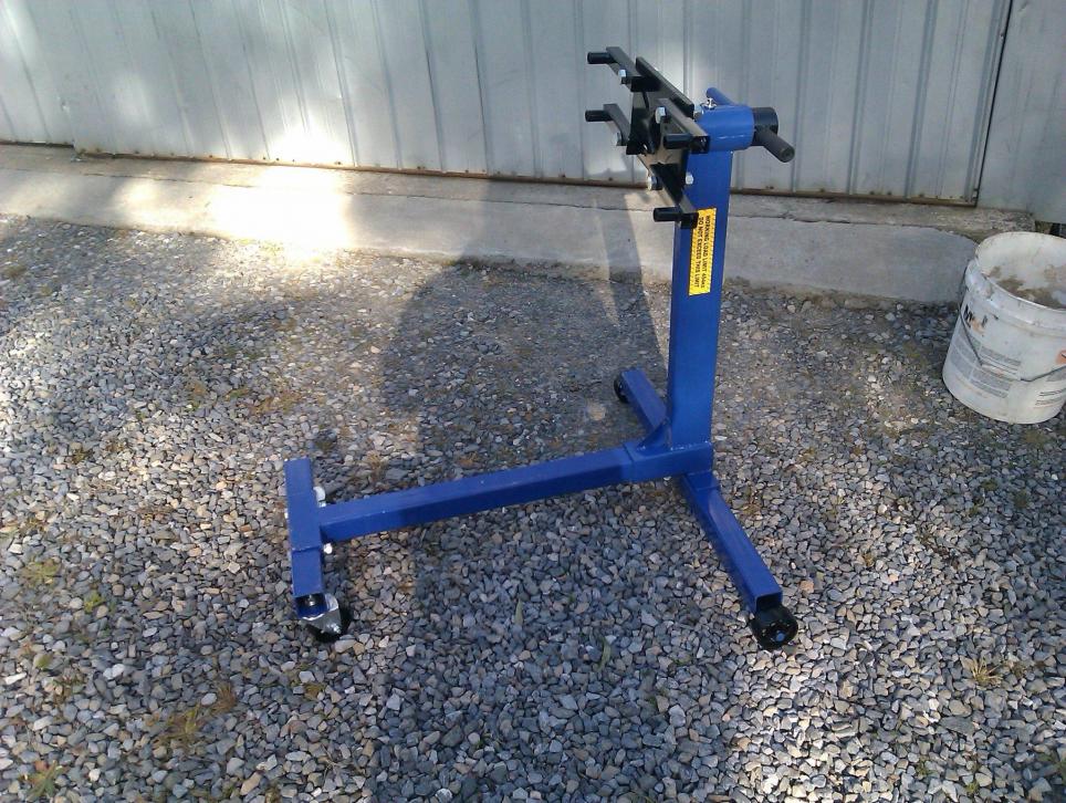

                    i picked up this stand today, but im not sure weather i want to mount it with the little arms or make a plate to go on the side.

                      [QUOTE=werd_103;850291]i picked up this stand today, but im not sure weather i want to mount it with the little arms or make a plate to go on the side.
                      [/QU
                      The cams look okay by the looks of it.
                      This is how i mounted mine when i was working on it.mine had a plate but your arms should do . I had to drill another pin hole on the stand so the engine sits straight because of it weight being more on one side .
