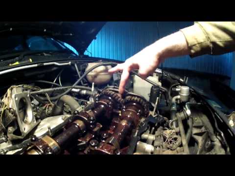

                      • #26
                        Ok so i started pulling her apart ive got the valve cover off and was going to take the top timing chain cover and needed to get it to TDC and secure the cams before i let off the tensioner, i didn't notice it at the beginning (not that i was looking for it) but after a few turns to get it to TDC the chain was loose enough to skip a tooth. would turning the engine with out it running not having much oil pressure to the tensioner let it loose? do you guys think if the chain was really loose and one or both the cams jumped a tooth it'd make that noise?
