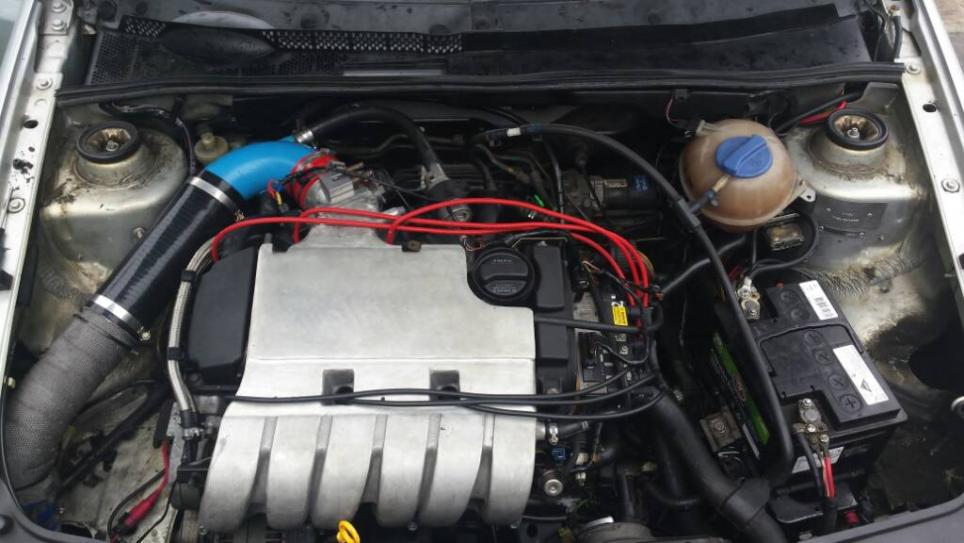

        With the ecu running an internal map sensor i was able to ditch the maf housing. Abd will be getting repainted shortly. Tucked the wiring loom while i was at it.
        This is how it looks now.
        Been having to tinker with the hoonduh to keep me occupied.

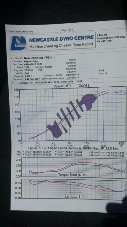

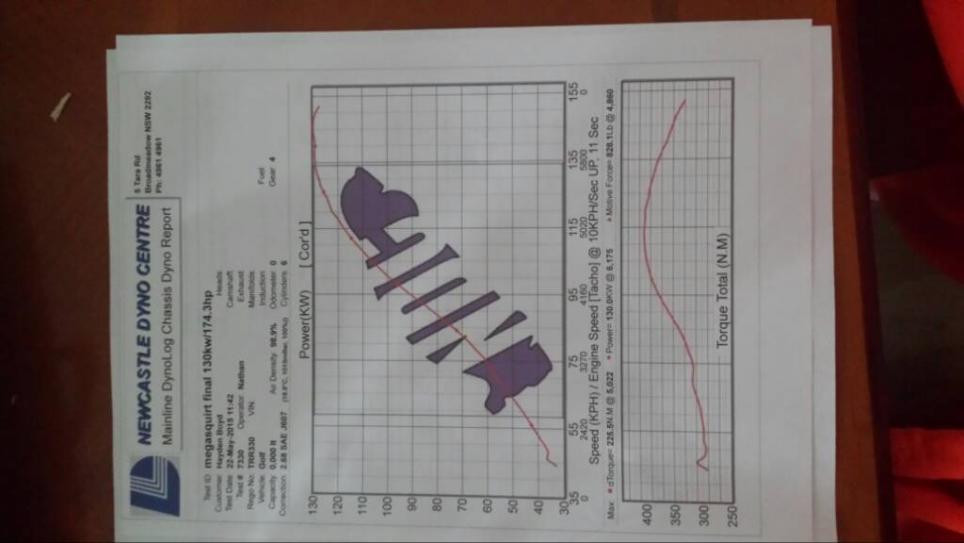

                • New graph.
                  Old for comparison.
                  Pain in the arse there isn't one on new sheet.
                  It made a whopping 2.5kw more than a standard ecu! Surely this could now prove that chips don't do anything..
                  Guessing just conservative tune, judging by how reserved the dude is. Does go a bit harder in the middle. Spins 1st, 2nd and 3rd when planting it mid gear.
                        Do you mean standard ECU vs chip or standard ECU vs MS?
                        Because when I look at the above graphs its your chip vs MS?
                        • Car never ran on a chip.
                          Gain is from standard ecu to ms.
