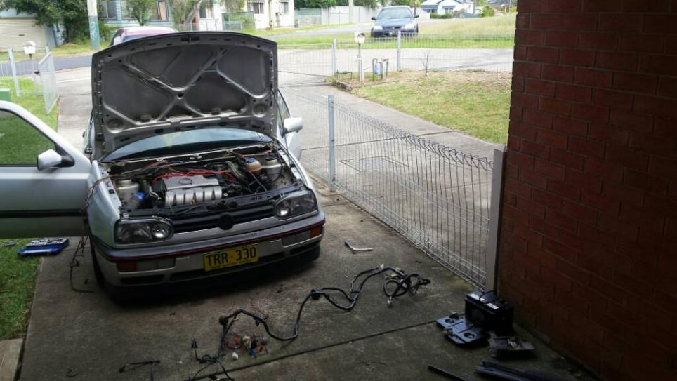

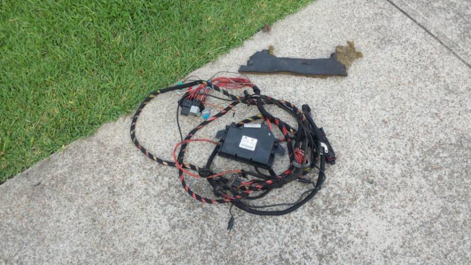

                        • Finally! Just got the pnp standalone loom!
                          • With some fresh motivation from VITS and a week off work i cracked into getting this thing ready.
                            Intake manifold off to add a phenolic spacer, port the lower and upper intake manifold and properly port the exhaust manifolds.

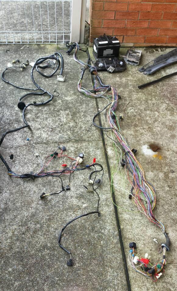

                            Next was to put in the megasquirt. Was a bit of a pain getting old harness out.
                            Got new harness in. Ecu has power, fuel pump has primed. Got excited; started it.
                            And
                            Didn't idle and ran like ****. Still does it and I've now dropped a cylinder.
                            • With a bit of back and forth troubleshooting and ideas.
                              Turns out spark output was set in opposite. After killing 2 coilpacks and two sets of plugs got it running today on all 6 again even smoothlt enough to do a burnout.
                              Get's tuned next week.
