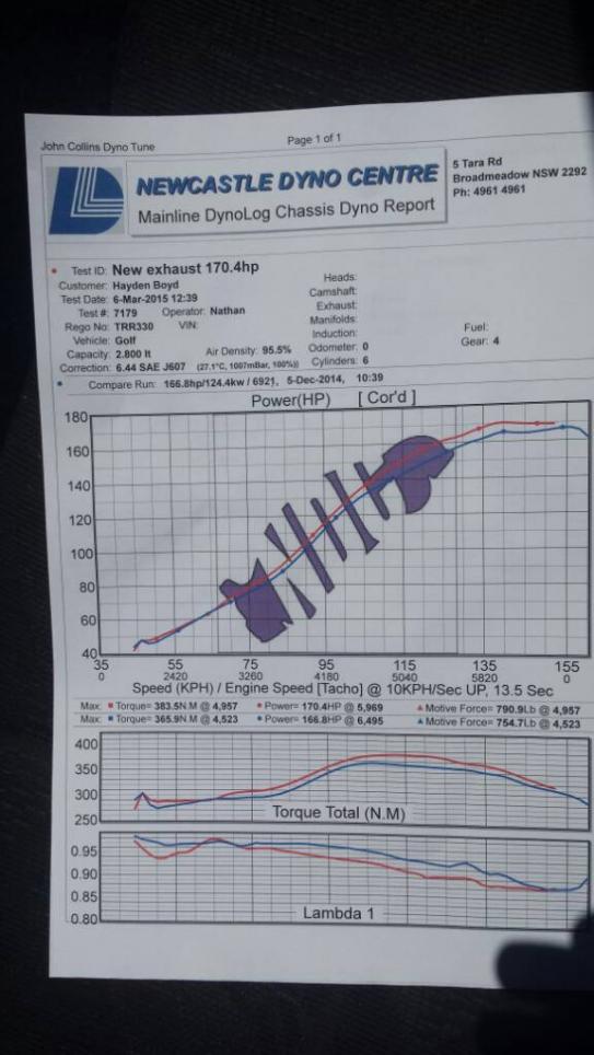

          • 2.5" vs 3" made power and torque everywhere.

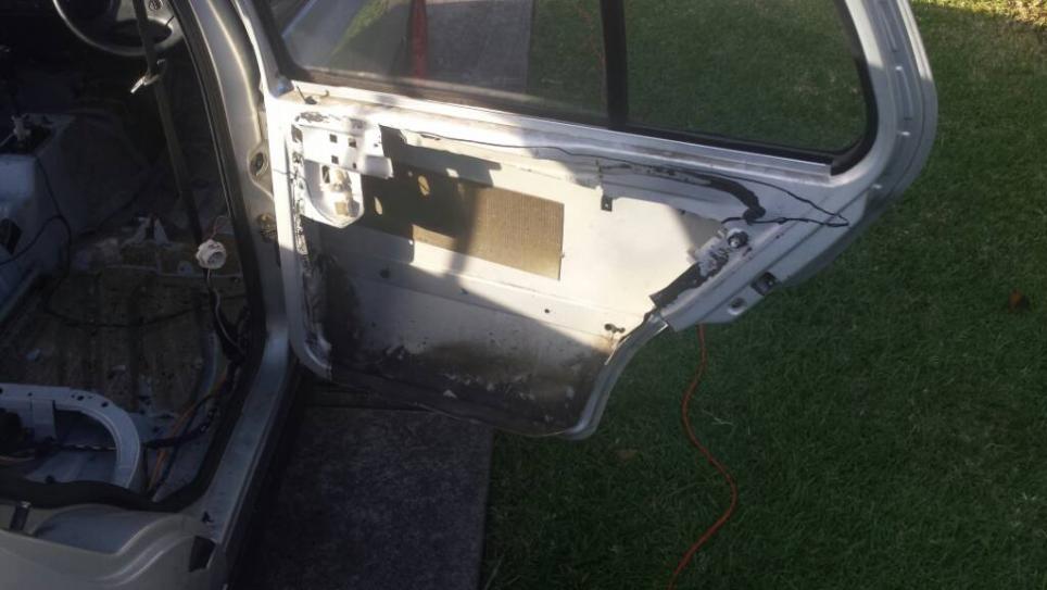

            • After putting it for for nearly 2 years. I finally stripped the sound deadening. Went the cheap route and used a heat gun and a spatula. As easy as using dry ice. But there is alot of left over residue. (Glue stuff i think) whether or not you get this with dry on a vw i do not know. I didn't have any left over on the sti.
              Sound deadening added up to 10-12kg i would guess haven't weighed it yet. Along with the pad on the fire wall and the sandbags under the carpets there would be 25 odd kg of material. Quality car.

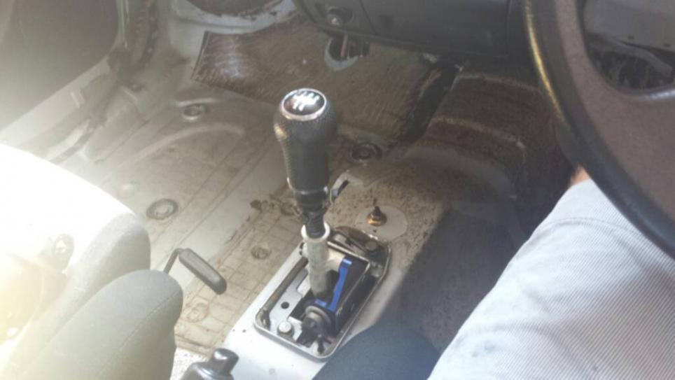

              Also put in the b&m shifter i have had for ever. Feels pretty tight. Takes a bit of muscle to move it around gears. But you do get a good engagement feel. Not as notchy as what people say it makes it. But you know you've got a gear when you are hoonduh shifting.

              All up rear doors I've removed 20kg
