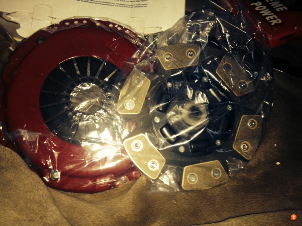

  • My new clutch finally arrived after about 2 months. So I can now button this thing up and drive it again.

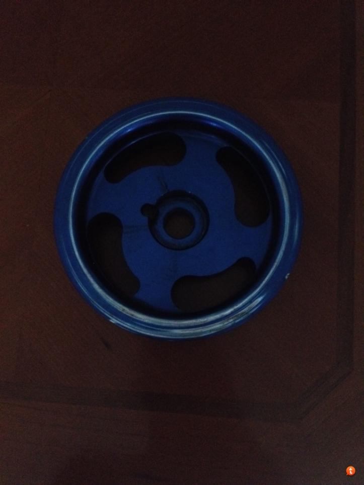

    • Turn2 crank pulley

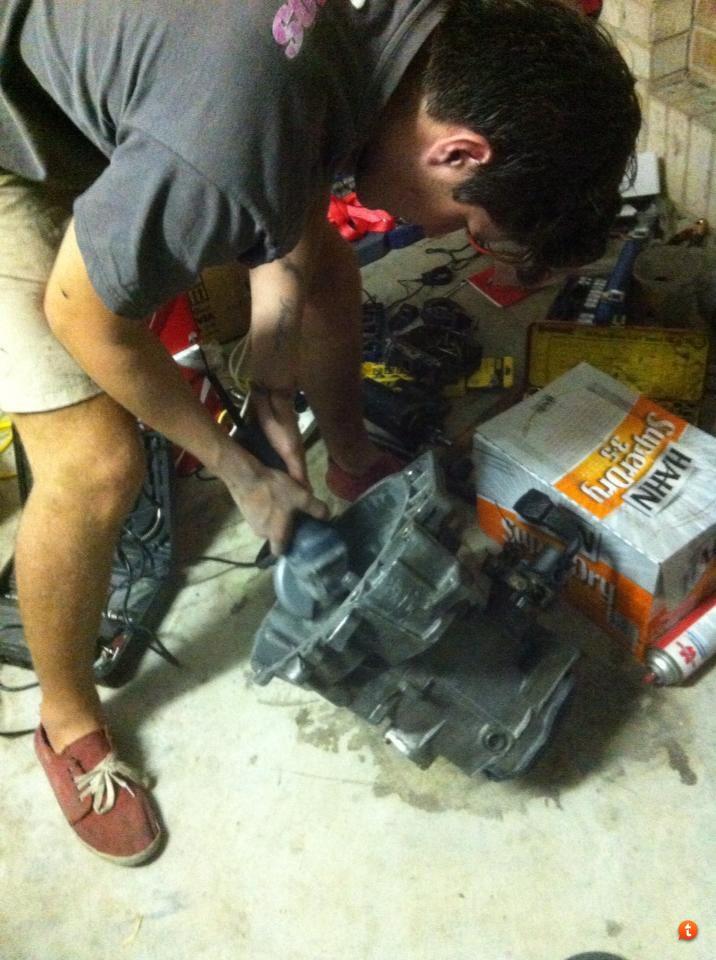

      The HD pressure plate hits something within the gearbox too; so that has to come back off and be rectified. Probably with the grinder

            Fixed said PP issue the Aussie way:

              ClutchNet stage 4 6 puck carbon Kevlar disc and Pressure Plate:
              Stock pedal weight, not on/off engagement like other pucked disc cars I've driven. No judders, no shaking etc. haven't launched it yet, but I'm going to say it'll be pretty sweet. Did have issues with the HD pressure plate hitting on the bell housing somewhere causing the motor to 'lock up' took box off and 'massaged' pretty much everything down to be certain and it worked.

              Haven't installed lightweight Pulleys yet.

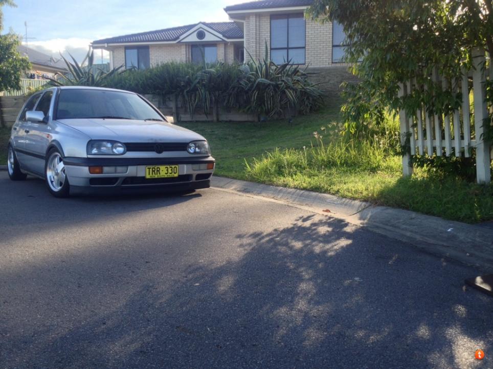

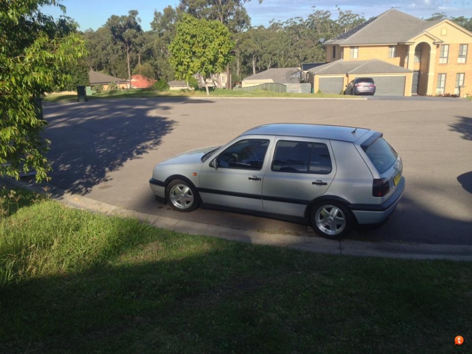

                      • Time flies when the car is not at your house.
                        Re rego'd, mk4 rear calipers(bit over a kg each saving), silly wheels to get around on for now, once and for all solved linkage problems, re wired tps and the coilpack harnesses, general service and much fun.
                        Back in love with it again.

                        • Its been a while but im glad to see its back. Getting a front lip should be your first priority however.
                          • Got one
                            • give it a wash and put your flares back on ya grub!
                              • No flares ftw.
