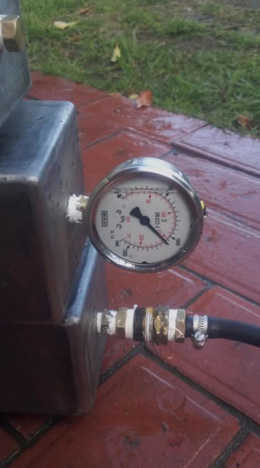

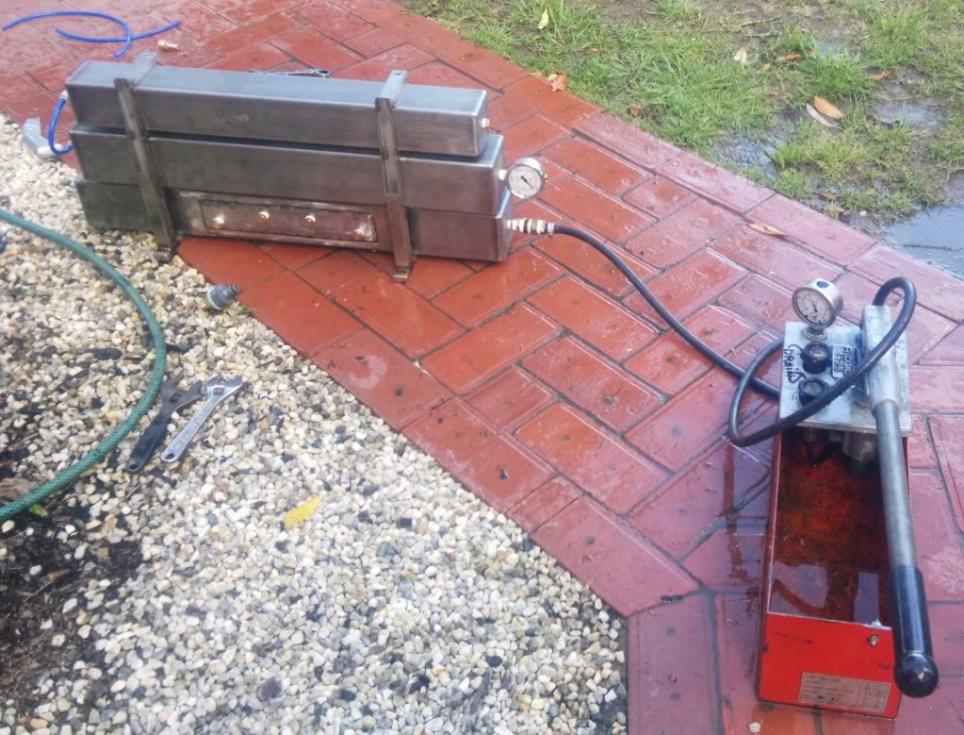

        The Tanks in the holders were once more tested with 151psi over night just to be 100% sure.

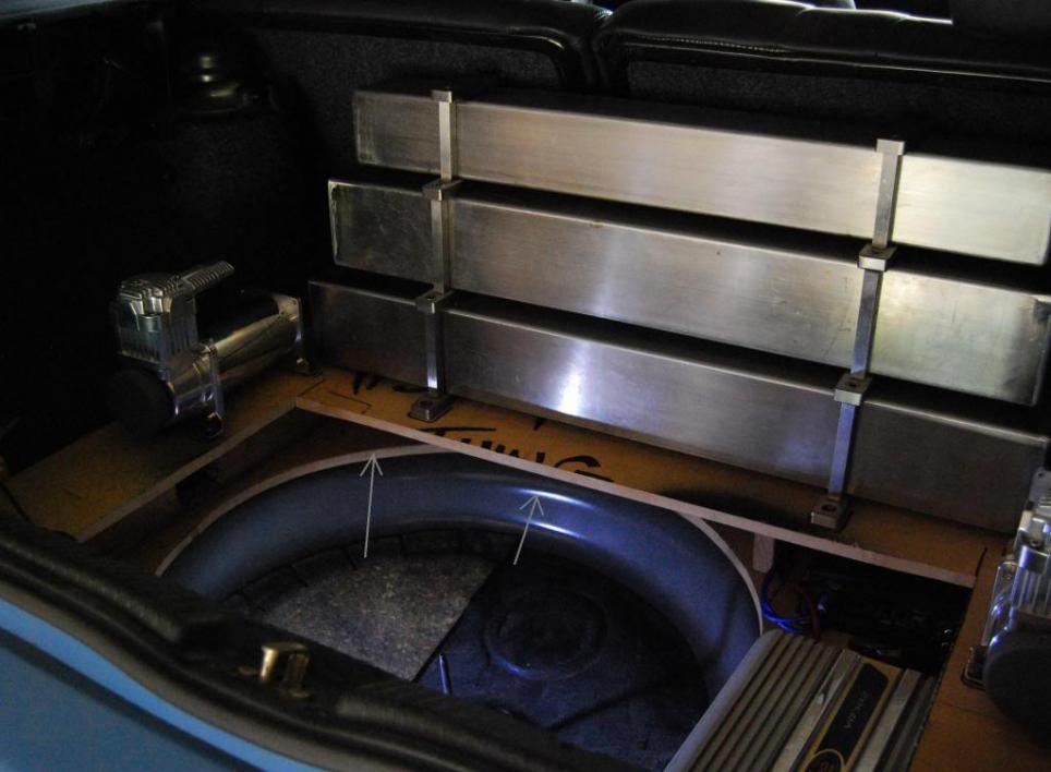

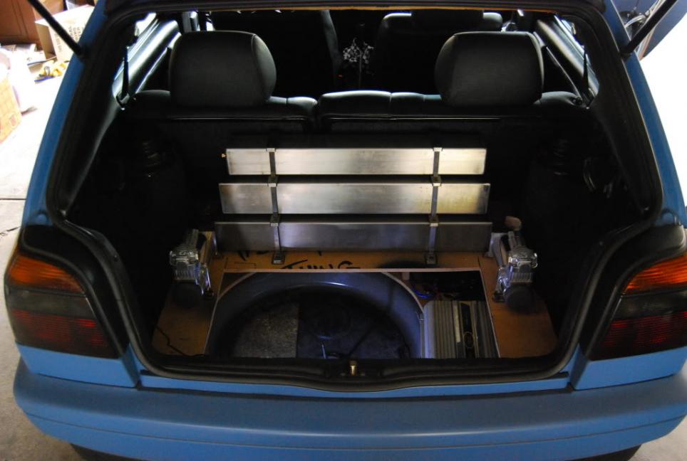

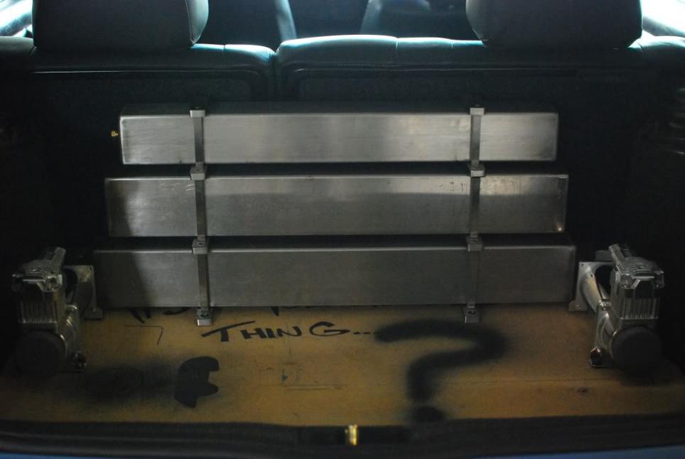

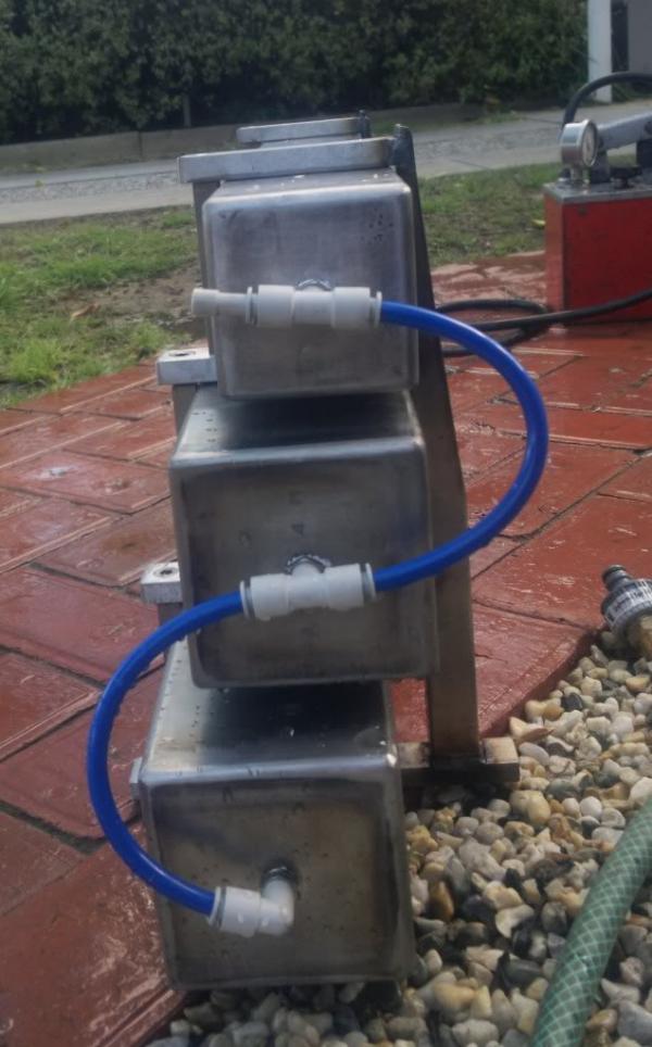

        • Those tanks are awesome! Definitely something I haven't seen before. Good work for trying something new. Now watch lots of people copy you trying to be original and different.
          • Loving your work dude! I love the square tanks!
            I've been running my 8 gallon (30lt) tank with the air lifts amand I go all down and then all up to 80psi and the tank is already down to 110 psi and the compressors kick off again! Are you going to run another tank too?
              Thanks mate,I'm happy as with the way its turned out... NEVER again thoe HA.
              And Yes is very hard to be unique these days people will copy but I think alot will fail
              Thanks Stu, Exactly what I needed to hear,I Will be ordering the Wheel well (pancake) tank once I get home,
              The american Dollar is Sooo good atm !
              I was worried about the compressors coming on all the time and I knew I had bugger all air capacity this should help.
              so all up ill have around 29ltrs.

                    Big chunk of aluminium for a nice straight cut.
                    SO if it happens the pancake tank will fit in the wheel well.

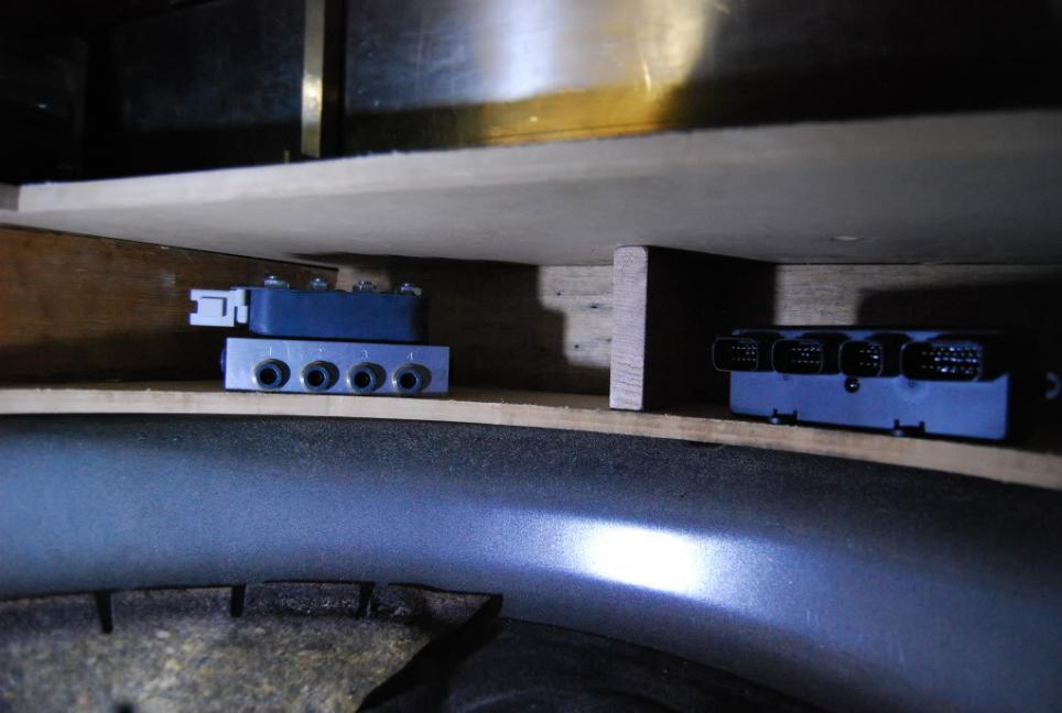

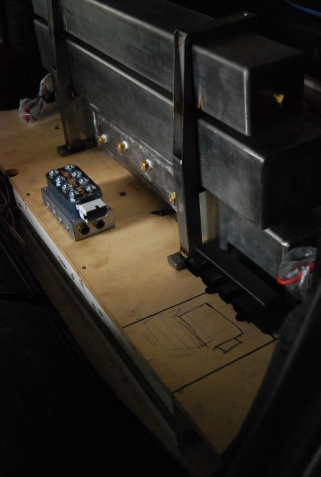

                    • I have two options for the wire air line set ups.
                      Both options have there good & bad under may be very tight if I get the pancake airtank but can stil be done.
                      Behind may be a little messy but you wont see it from the front.

                              • Takes 33 seconds to fill a 30lt tank from 110 to 145. I would run a flat panel over that wheel well dude you will get quite a lot of air in there! lines are easy to run where ever
                                Best bet is to run the rear air lines through the top of the strut tower... the fronts run them above the fuel tank and into the boot be careful not to but holes in structural stuff!
