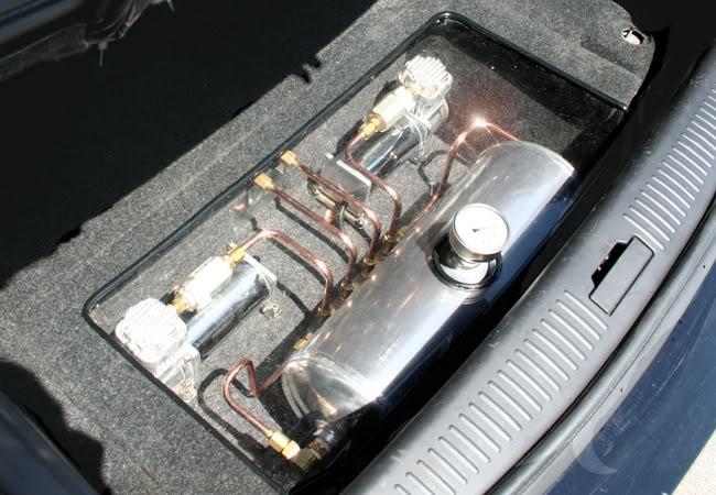

    Im giving myself 2-3 weeks on this install as im going for a very unique show finish boot install,running copper hardlines so on.
    like this.
    This doesnt mean mine will look anything like that.

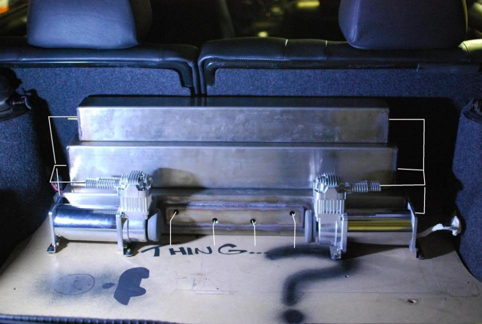

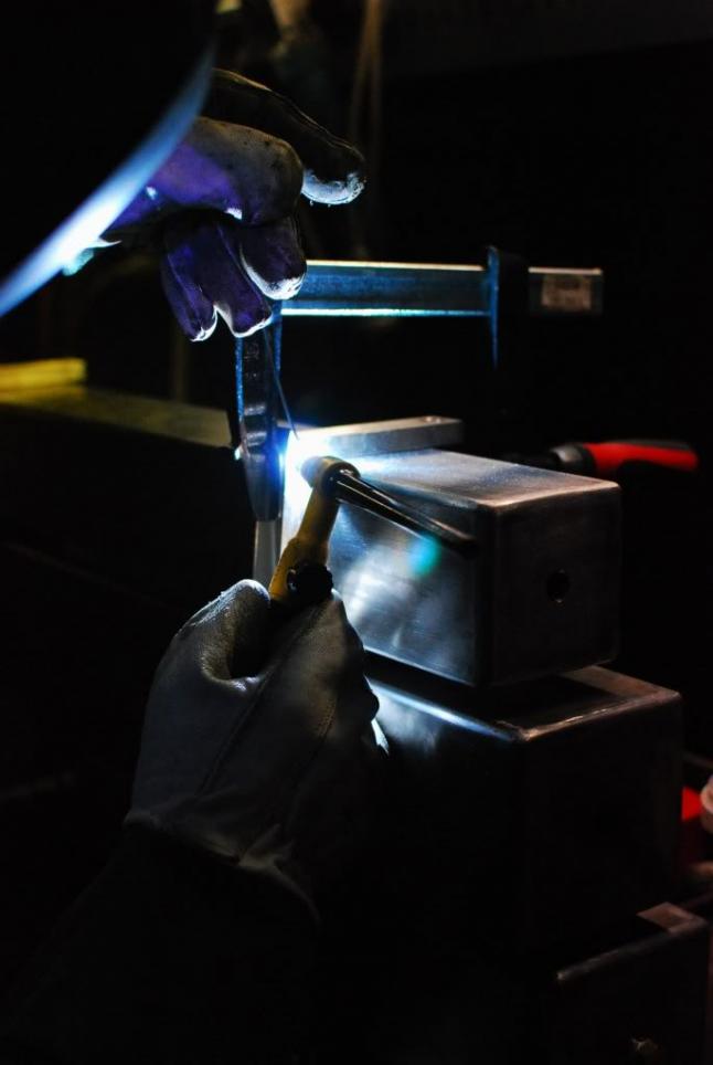

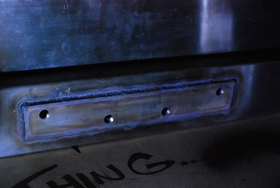

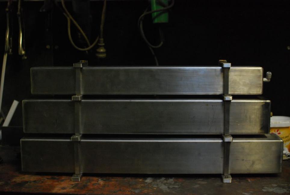

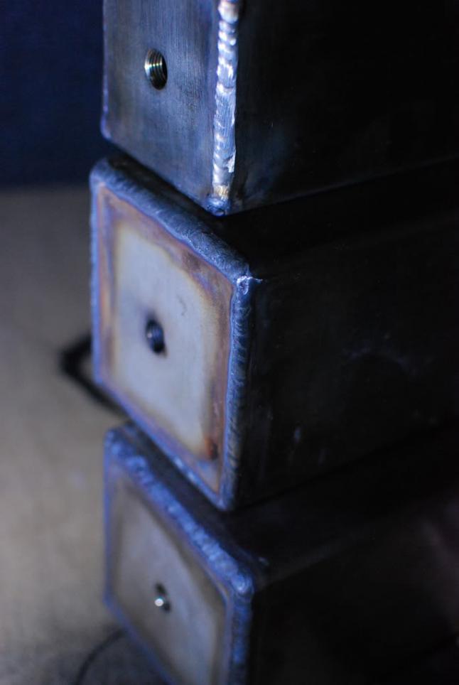

    • Tanks are all done.
      couple of pics.
      Something likes this
      Up next hardline Im going steel now not copper.

      • Nice dude!!! Good to see more bags going in mk3s!!!!

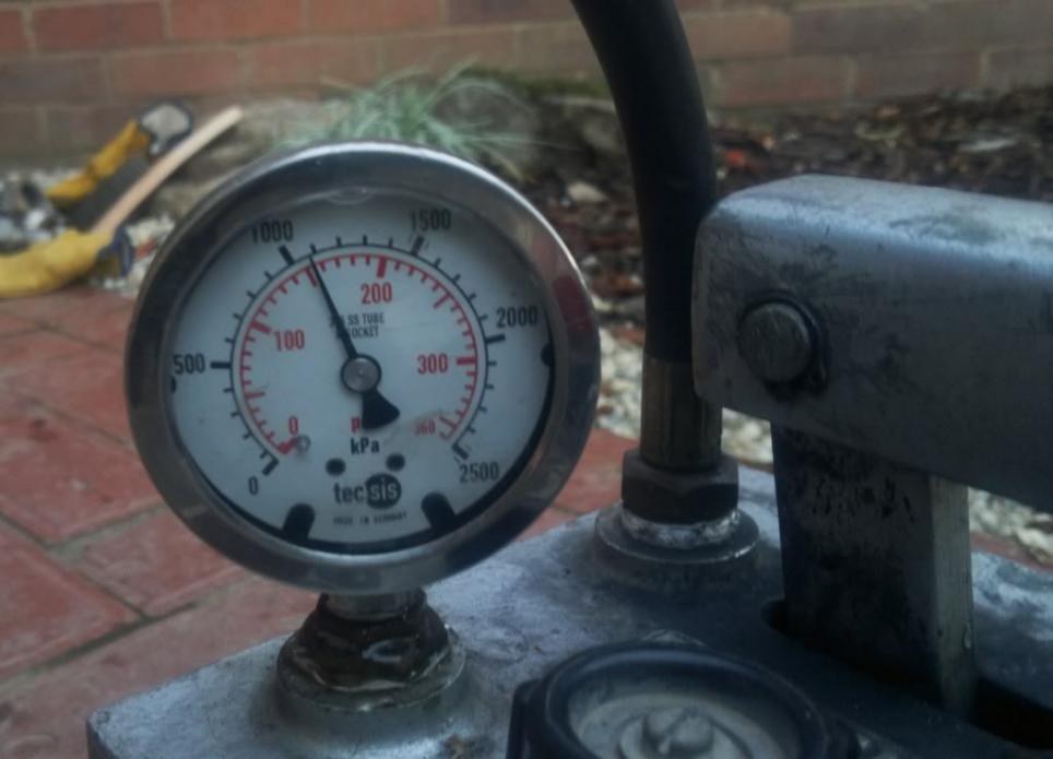

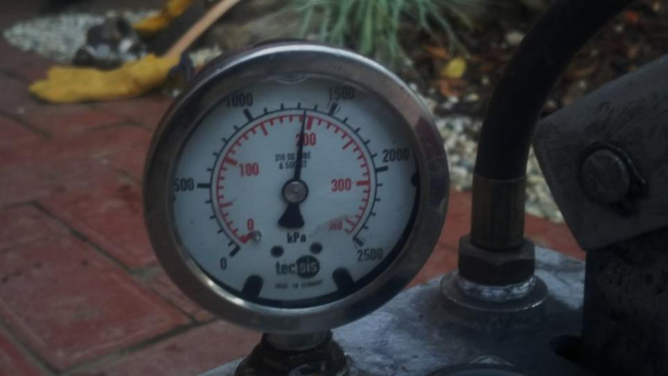

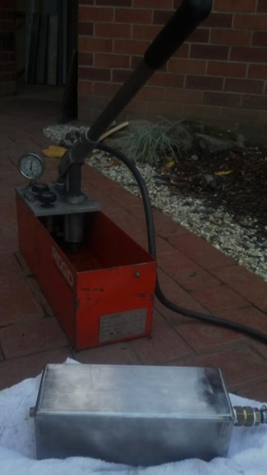

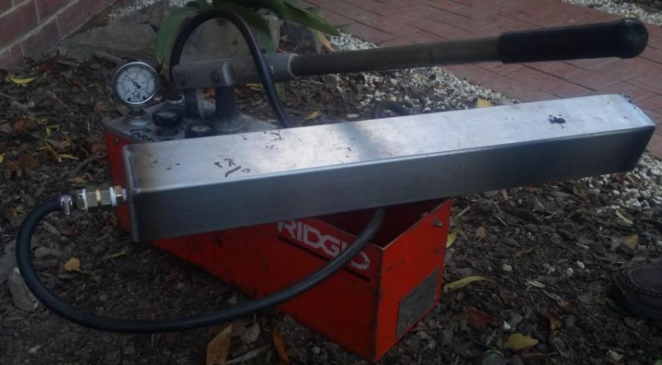

            Because Im making custom Air Tanks, They HAVE to be pressure tested for the obvious reason.
            Tanks will hold 150psi which is huge !
            Me & the old man hydrostatic tested them the propa way to test them really.
            Pics.
            150psi
            190psi (just to make sure)

              • ooo more bags! love the custom work on the tanks, good to see people thinking outside the box!

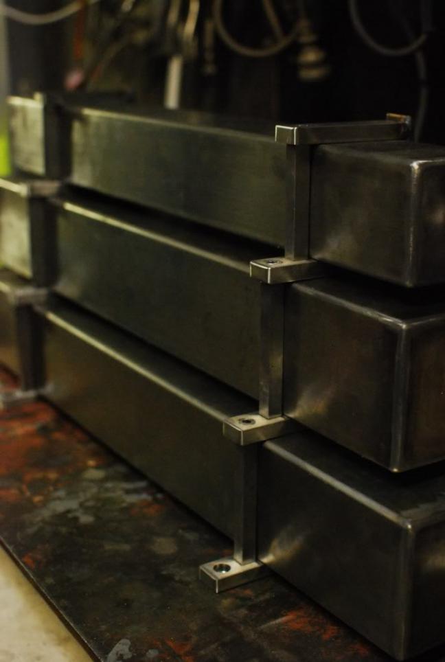

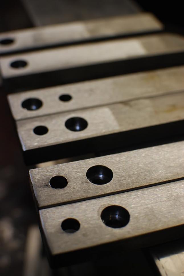

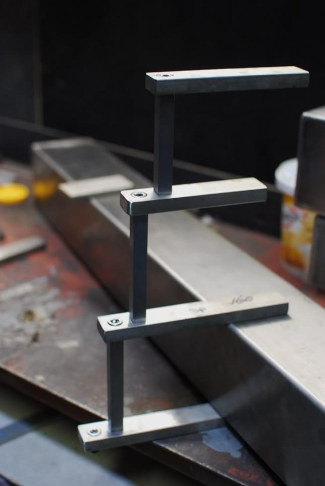

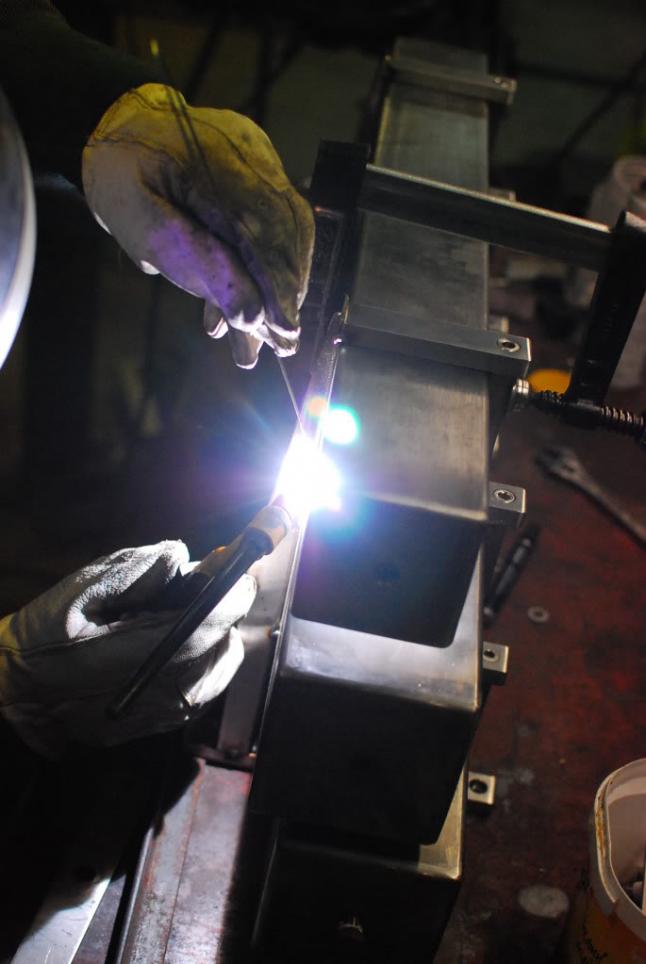

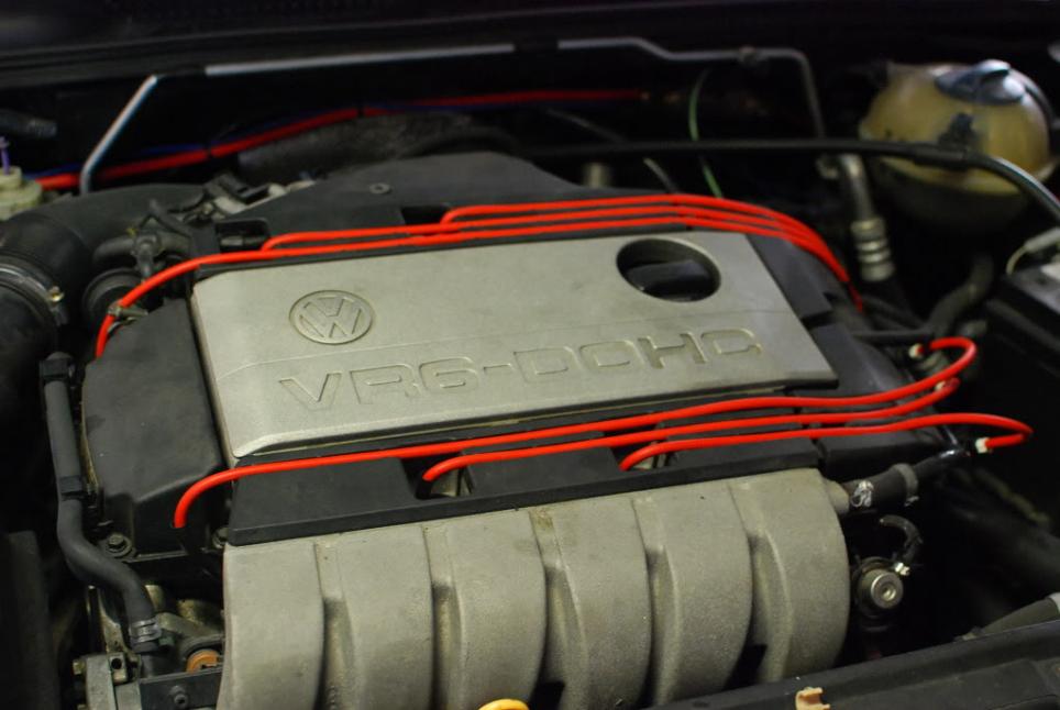

                      • Finished the tank holders 25+hrs of labour so far..
                        In other News Ive brought new plugs & leads
                        ... My car was running crappy..And still is ! Its driving like a leads still loose,I put the foot down and the car really struggles ?? anyone else had this It putters sounds like its about to die..

                        • check all vacuum hoses and check coil pack see if its sparking

                            With the air tanks though, how's the compression testing going? I always thought air tanks were meant to be cylindrical as there were less weak spots (edges?) in it compared with others.
                              Ok will do, cheers Dark.
                              Your spot on Ray, Air tanks ideally should be Round Cylindrical, Theres almost no weak points.
                              I was looking at hundreds of boot installs to get ideas when I thought to my self almost No ones done Square tanks for the obvious reasons,So I thought lets give it a go.
                              You wouldnt go much larger then my tanks as im sure they would bulge
                              If you look on page 11 you can see the Air tanks were all pressure tested

                              • Top shots man !!
                                Every time I look at it, I see more an more detail !
                                As for ur engine problem, maybe it's time for a quick refresh !
                                Put new gaskets clean out the intake, throttle body wipe any grime an soot off the piston heads, chamber heads, ports etc
                                Put new filters alround + new oil. After all shiit u'll be shootin 110killer wasps hopefully
                                Actually put a mk4 metal head gasket, it's suppose to give another 5-8kw !
                                An that coolant bottle's lookin sad in corner there ! Your doin all this work at the back, might as well do something at the front. Shiny inlet mani & new coolant bottle ?
                                Complete package FTW !!!
