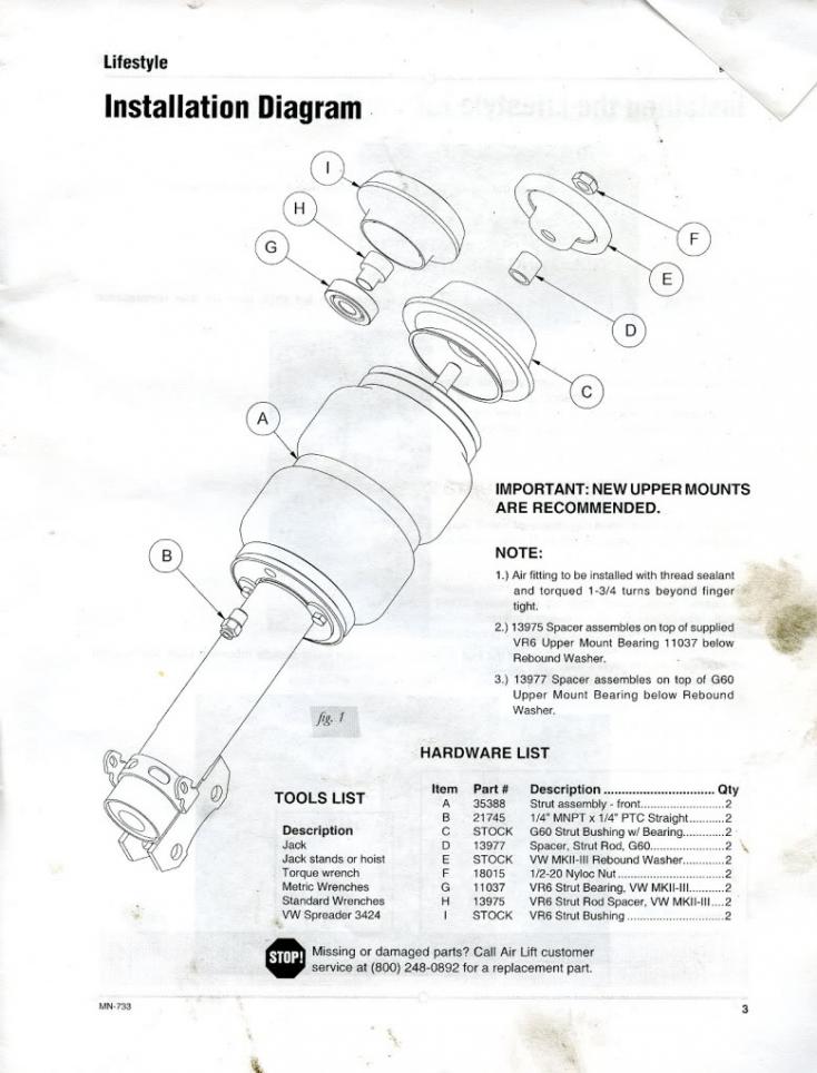

  • Hope the parts are all alright, wasnt sure which little circle clip thing you were after as I just have them all in a box so put a few different sized ones in, so hopefully one of them is right haha.
    I didn't get any pics when I put them in but I just assmebled it the way it has it in this diagram. Did you get these instructions?
    The scans lost some quality from emailing it from one computer to the other and then uploading it to photobucket, but yeah, hope its of some help
    Edit: I did it with the left set of parts, as thats for the vr6. Come to think of it it had specific instructions to make it work for vr6 and something in the mount had to be trimmed or something, I just put them in with some old vr6 mounts I had lying around which I changed out of the old car becuase they were shagged. Will be putting fresh ones in soon, but they dont seem to be too bad. I didnt have to trim anything though like it said I would have to.

      Ok I did have this diagram Stuffed if I can find it again. I used G, H, I, E, F.
      Did you use 'C' aswell becuase I dont have that part and with it all together I recal it not fitting anyway.
      For some reason 'E' doesnt sit flash into 'I' and when its all together bags full of Air theres a nasty gap

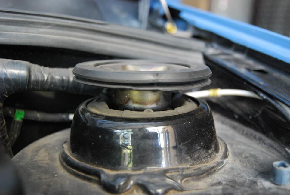

      Heres a Picture... This is not normal ?
      Why else would my bag twist 180 ??? The right side air bag turns with ease now & the left bags nice & tight...
      I have a feeling Ive missed something so easy & feel so stupid about it lol..

                      • Why is is sitting so damn high?
                        Have you got the bearing underneath the rubber?
                        In mine it goes strut>bearing and spacer>rubber top> through the strut top amount> then the metal top goes on and a nut...that's it

                        • I've seen this before on somebody's coilover install. I believe something was put in the wrong spot or upside down? Sorry about being so vague about it, but that was years ago.
                          Hope this helps at least a tiny bit
                          • on the strut itself is the bag screwed onto a spring perch or something? I'm just spitballing here but maybe go over the other strut and just compare the two to make sure everything is the same.
                            That strut might actually just be faulty. got warranty?

                              • Originally posted by thestu View Post
                                Exactly How I have mine to mate,Ive been told my bushes are flogged so Im trying to chase a new set...
                                Cheers man its all help.
                                I best have a warranty as there only 4 months old if that...Ive contacted Airlift see what they have to say...
                                Call me dude and ill talk you through it
                                04 21 647 6 9 7
                                Thanks will just try something tonight & over the weekend I think my front bag is Faulty...
