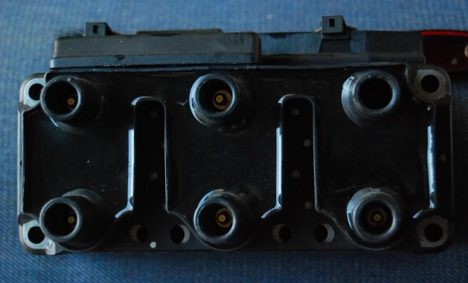

      • Ok so its not the Air sensor.
        Now the VR6 Coil pack ( Im looking for cracks )
        none.

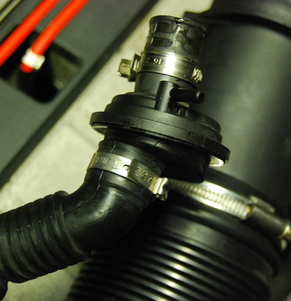

          • Its not your pcv valve diaphragm is it? When mine exploded it took me ages to figure out what was up with it, till i noticed the shattered remains of it under the car. Ran rough as hell and wouldnt idle properly, basically because unmetered air was getting sucked into it!
            http://downloweuro.tumblr.com/
            • Looks fine to me . no cracks or leaks ( I do hope this is the part your talking about ? )

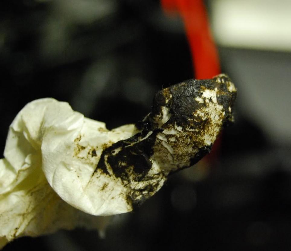

              But I did get this
              Its very Dirty is that expected ?
              And what exactly is in here, Can I clean it ? Doesnt look to hard to take out.

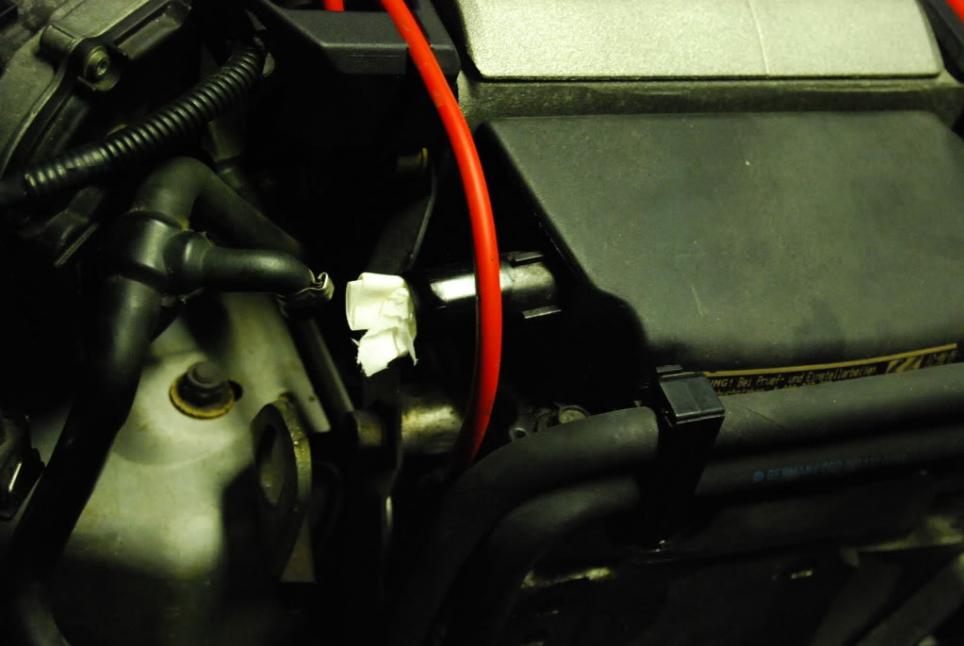

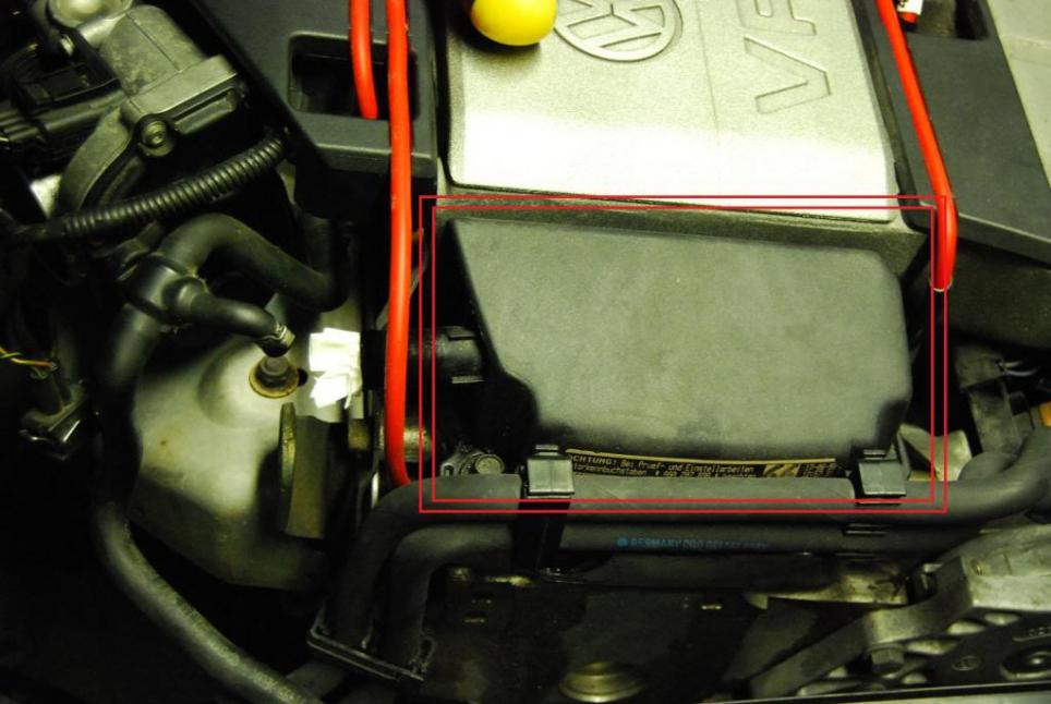

              • actually the thing I meant is this
                Its actually the air baffle for the idle control valve, it's located on the rear of the engine to the right slightly (between the firewall and the engine) can easily be seen from above. It may possibly just be cracked as well. It has sponge stuff inside which captures oil in the air flow. When mine blew it was just a nub of plastic where the hoses connected and a piece of sponge left!

                • Ive googled many pages for PCV valve breather diaphragm And its showing my picture more then the one you posted ?
                  plus I cant find it anywhere ? Tried googling PCV Valve Diaphragm location, no help at all.
                  No doubt its right in front of my face....will keep looking.
