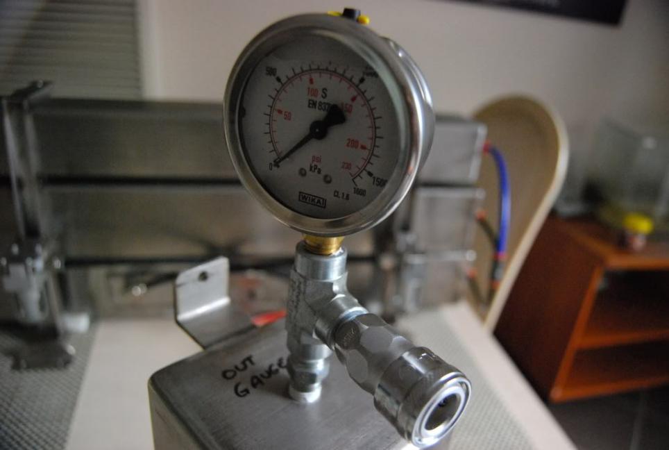

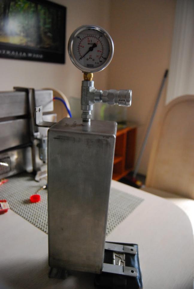

    Heres my little Tank with pressure Gauge and Air fitting to use for Air powerd tools.
    I HATE HOW YOU CAN SEE THAT MUCH THREAD STILL BUT IT CANT BE HELPED.

    • Can you cut the thread down or something? Not that its that noticable.
      This set up is going to be all kinds of cool! One of a kind for sure. Absolutely loving it. Keep it up!
      • I could but its not recommended,Its not that bad I guess,The Last thing I need to do is strip the thread.

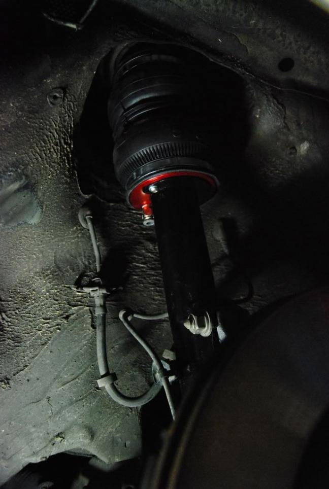

                As requested photos bits N bobs really.
                Final touches
                Mini Air gun

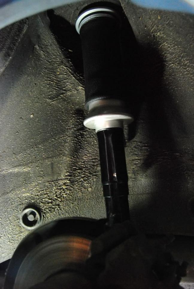

                Front bags in.
                Back bags in.

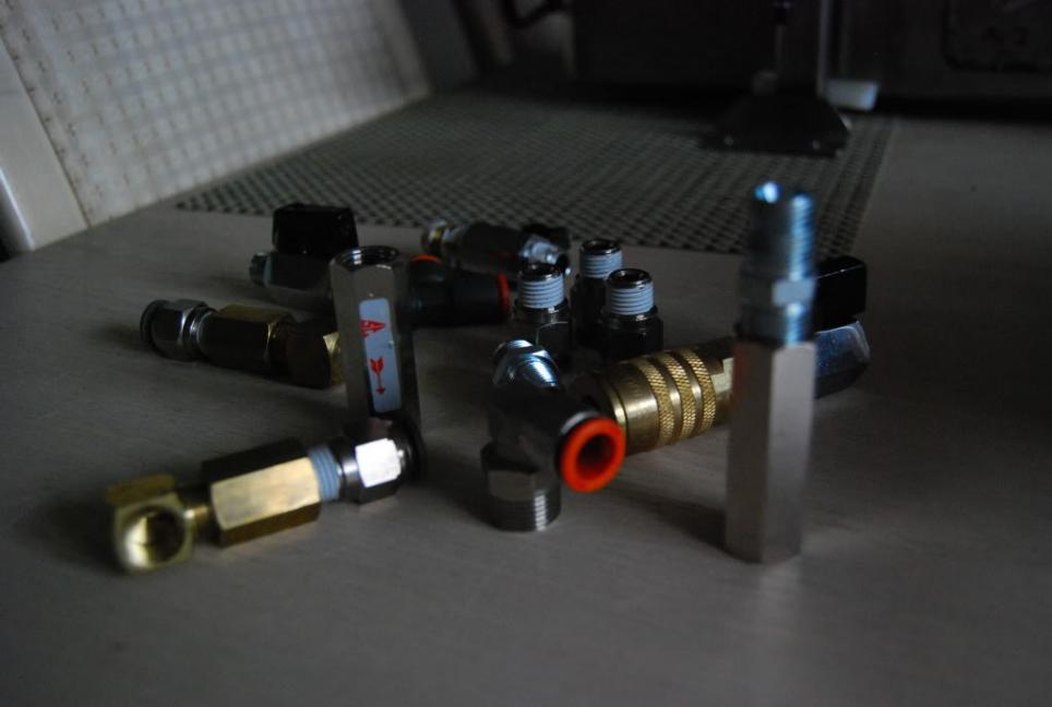

                Quality Fittings.
                So many different fittings.
                They done there job well.

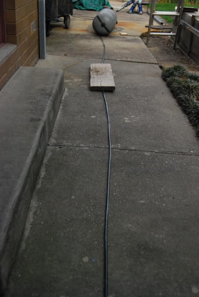

                Straightening Air line.

                          Cheers Stu Got a Question for you, how much thread could you see on your front bags on top,mines level with the nut was hoping to get atleast 2-3 threads more ? again the car isnt on the ground yet so maybe ill try then.

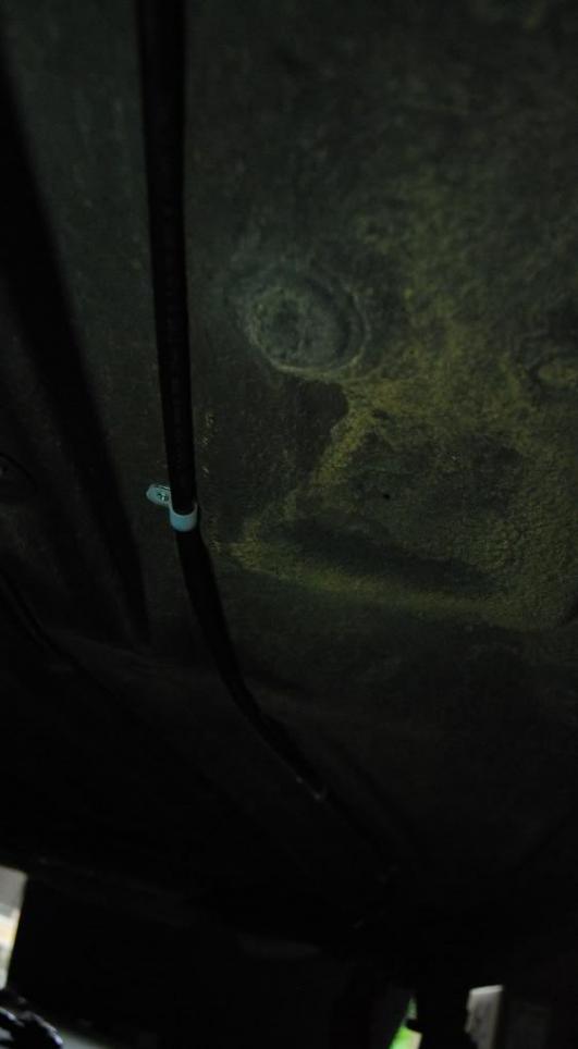

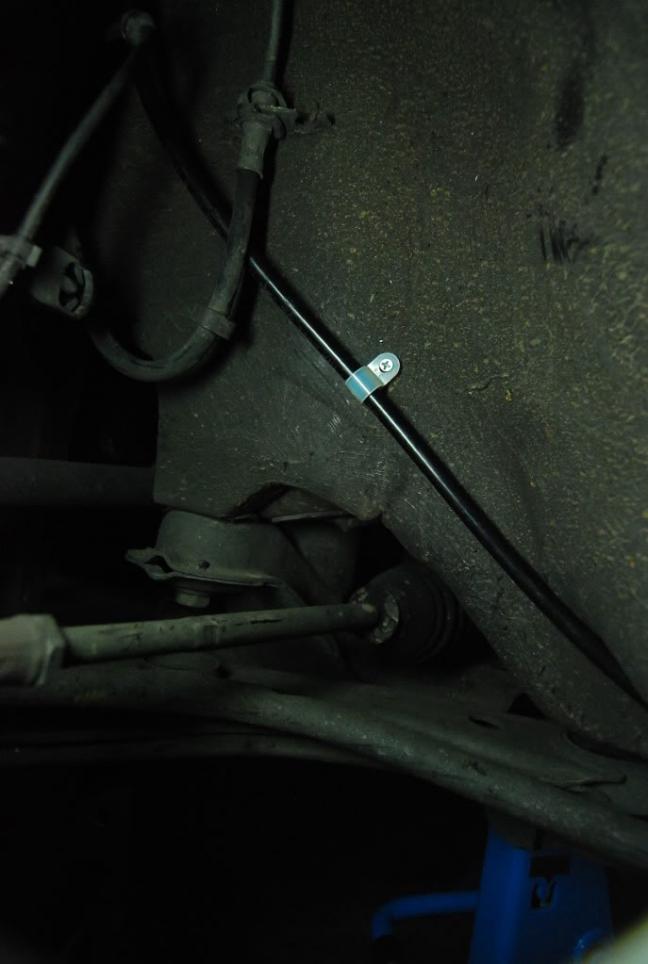

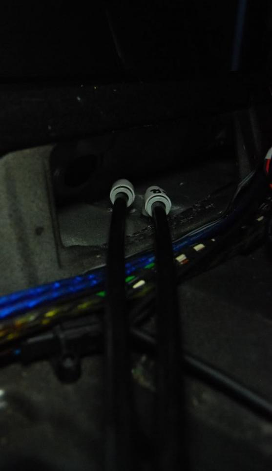

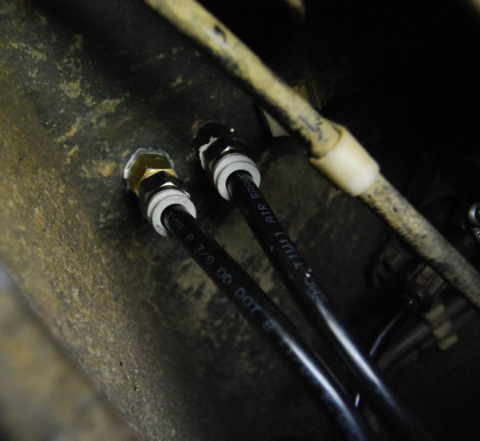

                          Air lines are done, I ran all lines Under the car,not a very popular way to do it.
                          Ill also have another hose going over the Air lines for extra protection.
                          Couple pictures.

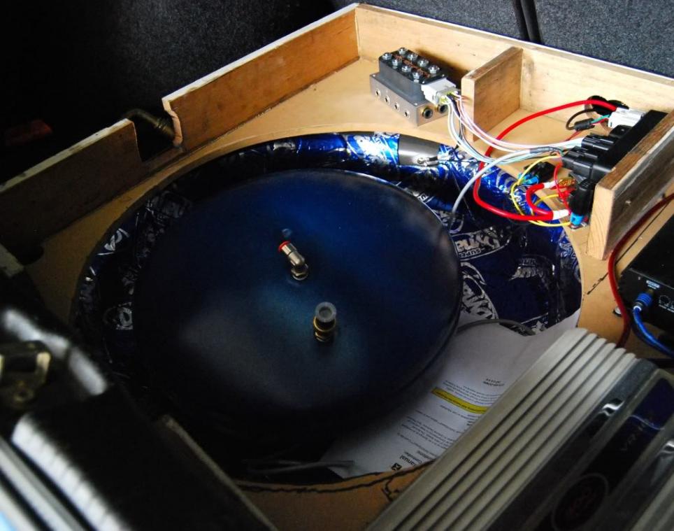

                          UNDER CAR .
                          UNDER BACK SEATS.

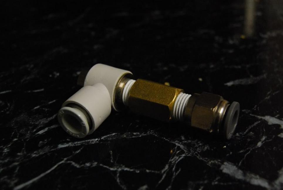

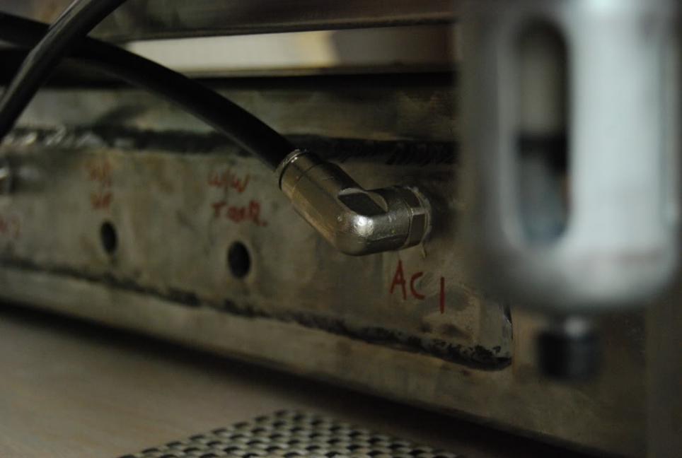

                          • Looking good. I don't quite understand the first picture...please explain
                            Tighten until its firm with loctite 407 (I think) then do 1 and 1/4 turns...thats all it needs. Its a tapered thread! If it is leaking you can go a further 1/4 turn without taking it apart...if its leaking you will need to take it apart, re apply and then tighten again to 1 3/4 turns past finger tight

                              • First picture is this.
                                Just a long Elbo basically,so the brass and straight fitting are under the car then the elbos above the car (under back seats)
