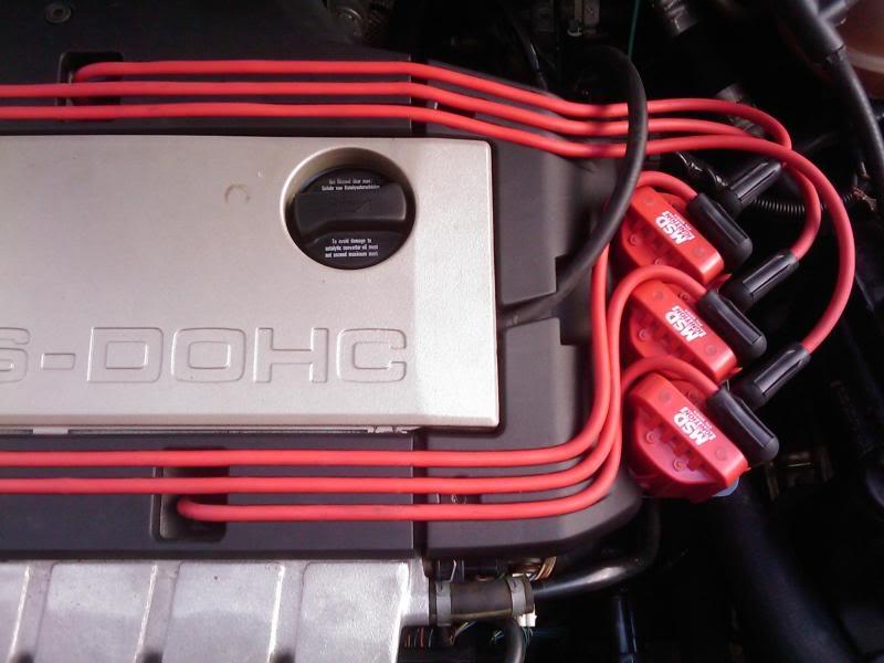

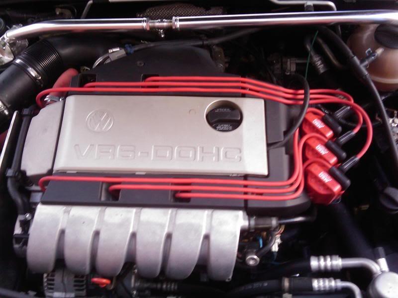

        thanks for the replies guys its really not too complicated when you think about it
        i just went to extra lengths to make sure nothing goes wrong
        from what i have gathered the only reason you need a resister is to protect the coils from earthing to the car
        the coils on a normal car switches on via the positive terminals
        on vws they switch via the negative
        if they are earthed to the car that means they are constantly on
        so they will just overheat and blow up
        i didnt end up using one because my icm was good
        for those who would like to know if you decide to use one you need a 1ohms resister rated at 225 watts
        the reason why people have trouble with blown coils is they have a bad icm
        (ignition control module)
        basically whether or not earth is leaking through to the contact points on the icm (each coil 16 34 25)
        the only way to tell if your icm is good is to use a multi meter that can read in solid state
        my mates an electrician so he tested it for me
        heres my finished job

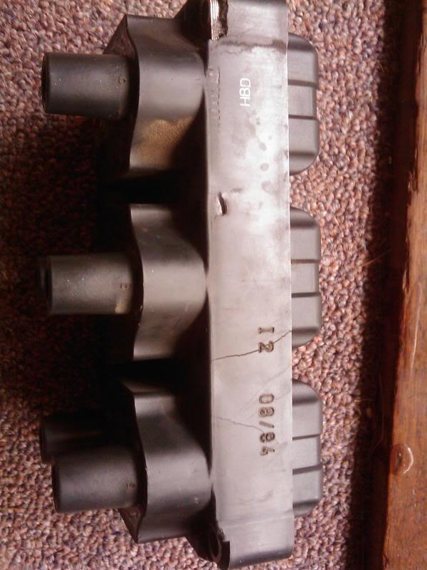

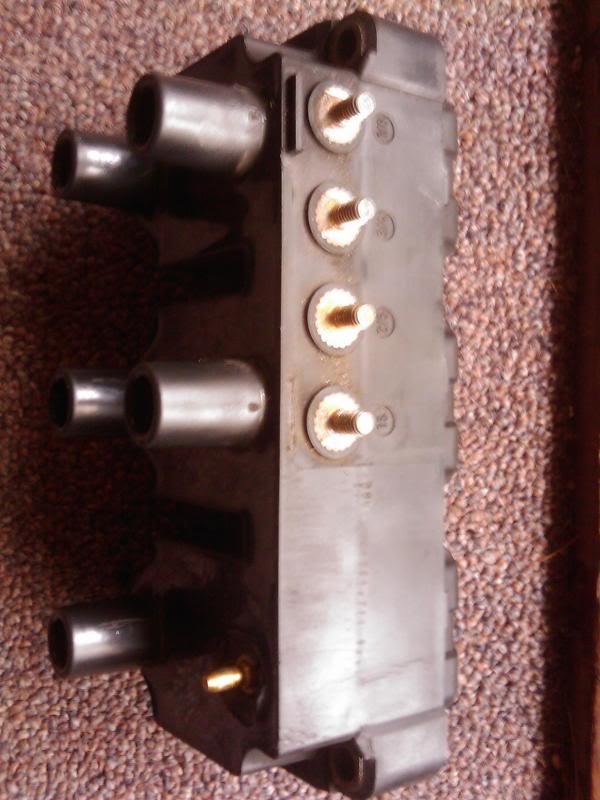

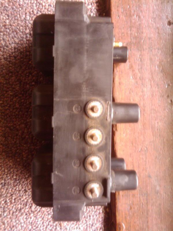

        and my old coil pack

            so far no worries yet guys
            my car actually has some balls now
            anyway highly recommended upgrade especially if you need to replace the standard one
