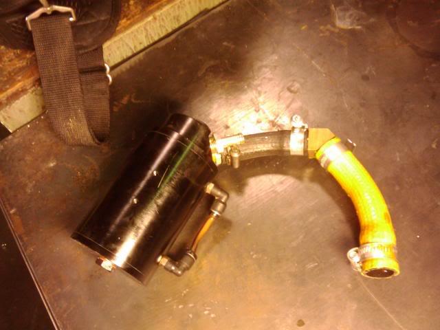

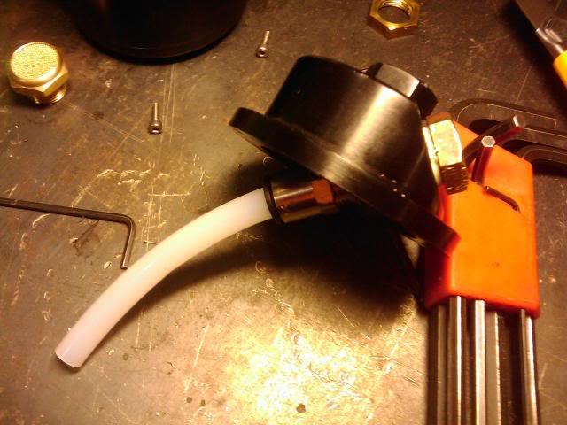

      i did some modifying to my catchcan after reading on from this link
      heres my abomination i slapped together at home from lots of different things
      i bought the can from supercheap

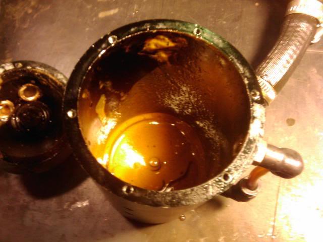

      gunk left inside after emptying it
      nice and clean

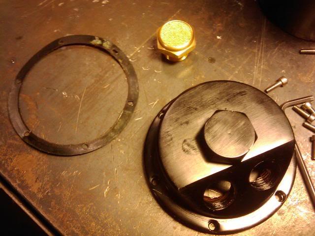

      here is the top, it already had 3/8 bspt (tapered thread)threads
      although i had to tap it out more with a 3/8 bsp (parallel thread)tap so i could screw a double ended fitting through it
      purpose of this was so i didnt have to weld anything

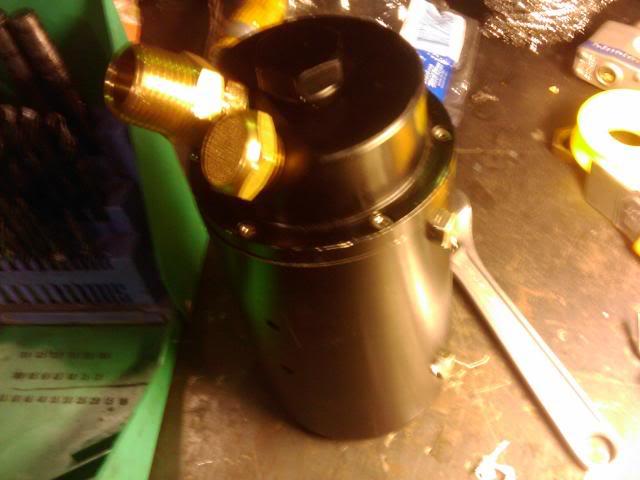

      this is the top finished, i joined the hose to the top i screwed in using standard pneumatic fittings
      thus extending the inlet to the bottom of the can
      for the breather i used an exhaust silencer commonly found on pneumatic machinery
      the can with the stainless steel wool inside acting as a filter
      finished

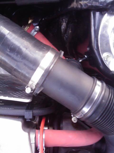

      in the car hiding next to the intake
      i used 3/4 inch steam hose its the only stuff i could find that fitted the hose barb on the car

            nice work but im not sure u would really want to put steel wool in there. i know it might be a long shot but you wouldnt want any fibres to be sucked into the motor if u know what i mean. its also gonna lower the capacity to store oil so u have to change it more often. just a thought.
            • #21
              i cant say that it would ever enter the engine it wouldn't be possible
              the reason iv done it so it lowers the fumes,
              before it didn't smell too good
              i hardly ever emptied it anyway i think it took 3 months and it only filled about a quarter
