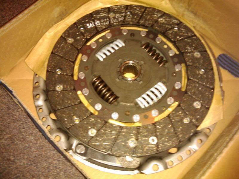

    as you may or may not know i will soon be getting the following work done
    gearbox rebuild..... ring and pinion set (shorter final drive), peloquin diff
    also longer fifth gear for highway driving
    stage2 sachs clutch kit along with DIY lightened flywheel

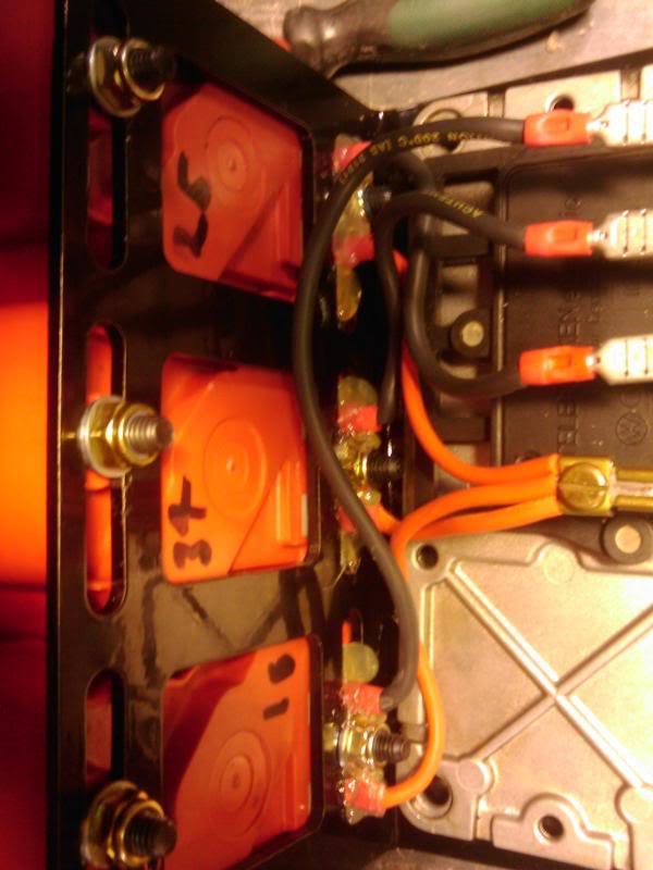

                      • #56
                        ok here are some pics for now sorry bout the bad quality

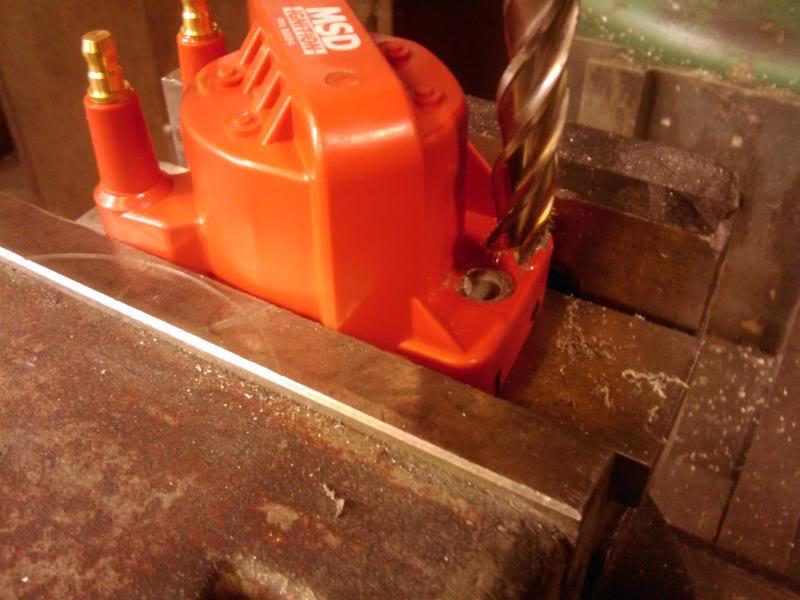

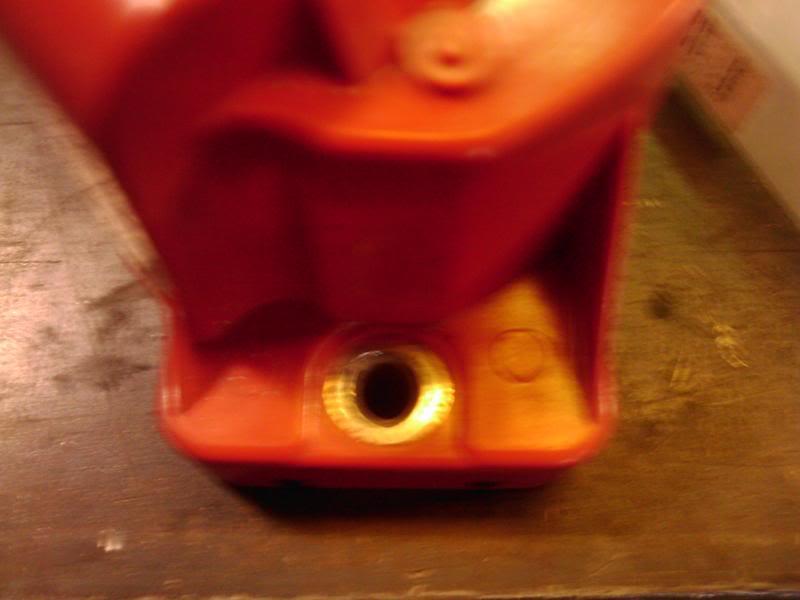

                        pic of coilpack with the grounding washer on due to grounding issues they need to be removed only as a precorsionary
                        heres me milling them out

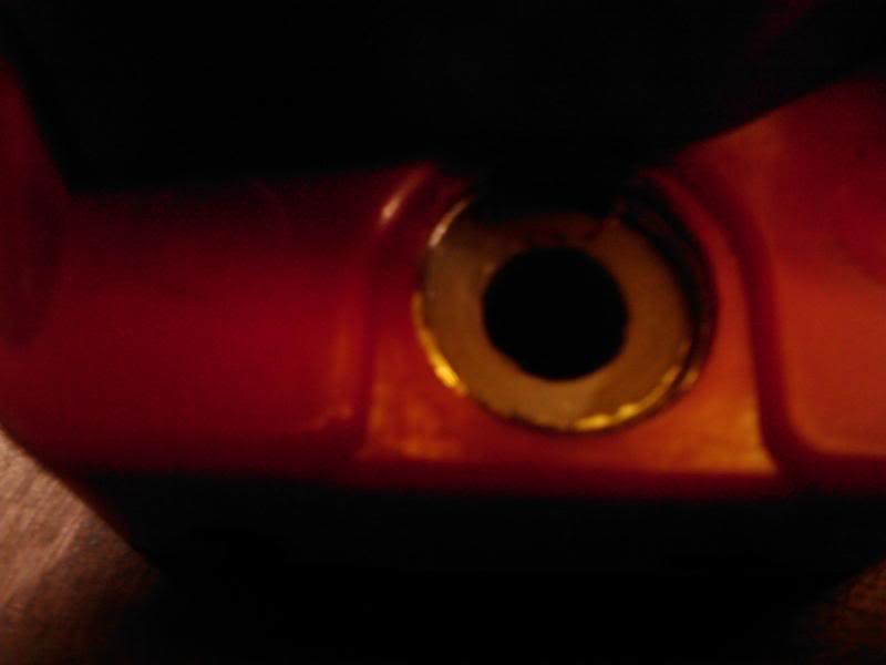

                        washer removed

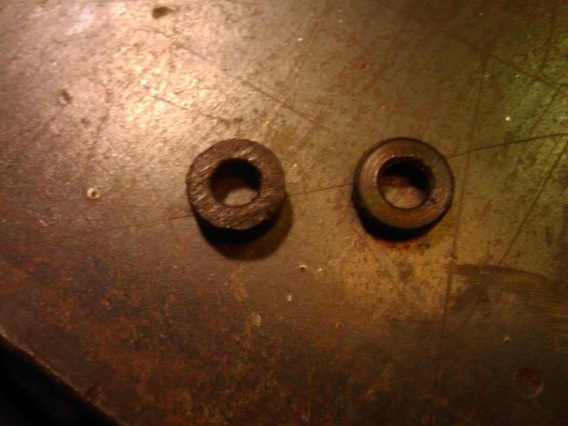

                        i made some nylon washers in the lathe just in case any more metal could of made contact
                        only needed three nylon washers as there is only one side of the coil with the grounding washer

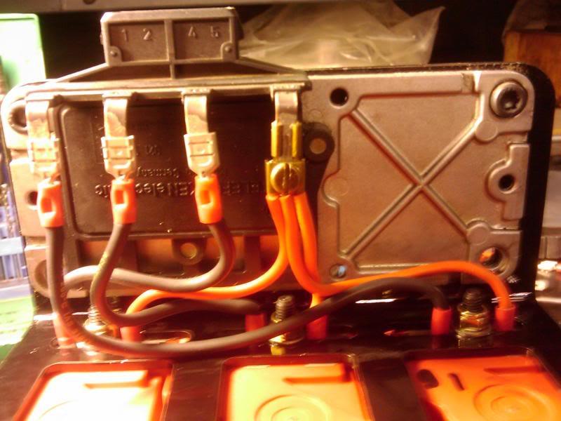

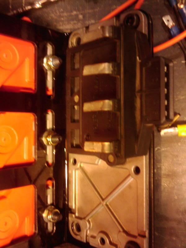

                        pic of the icm with the tabs folded over so they dont point out
                        and so they dont get damaged
                        finished wiring
                        also used hot melt inbetween the tabs to further prevent any grounding issues

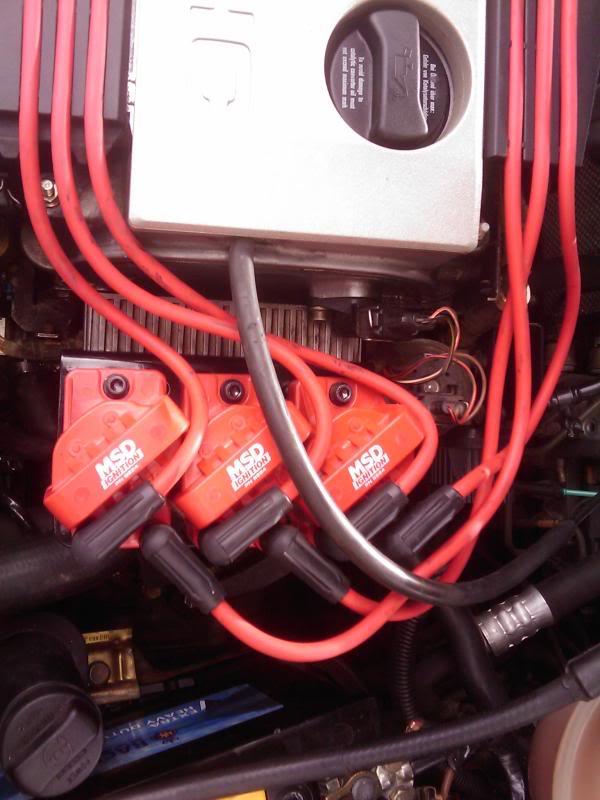

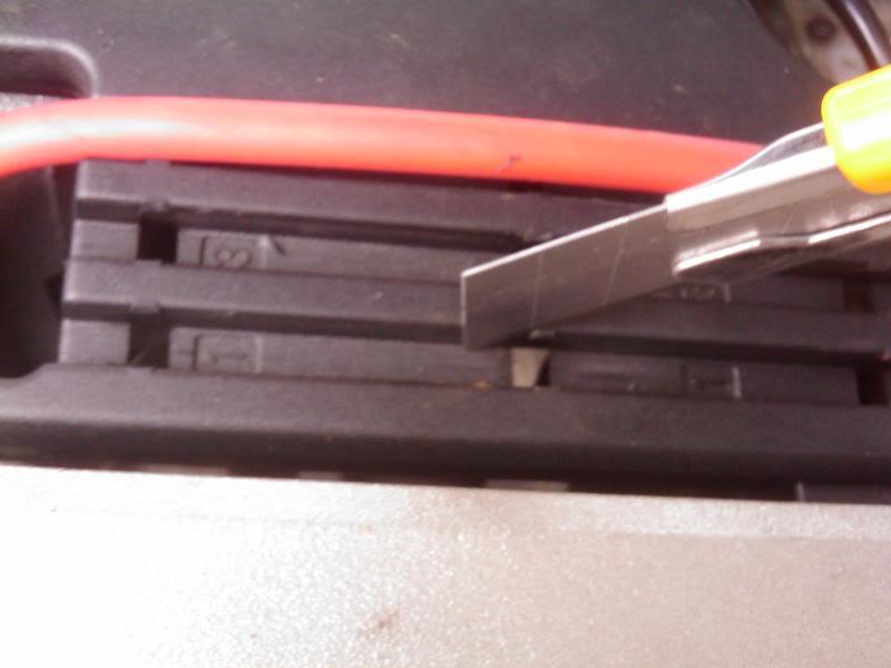

                        • #57

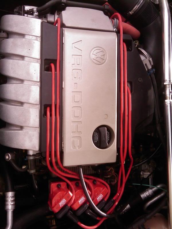

                          a few pics roughed in for now
                          msd leads are slightly thicker than the oem so i had to nip the tabs off
                          i just used a sharp blade

                            That looks awesome Pete, well done.
                            Wish I had the cash and expertise to attempt it myself. Knowing my luck i'd do it and the coil packs would blow up
                            • #59
                              If i tried all that i'd set fire to my car!! Well done pete!
                              • #60
                                That's quite an extensive approach to what I thought wouldn't have taken so much work. Hat goes off to you dude, you've done a very good job and I would bet money that it will run perfectly because of your methods!
