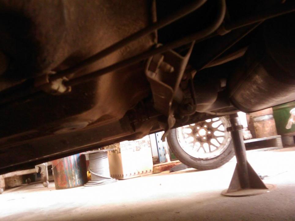

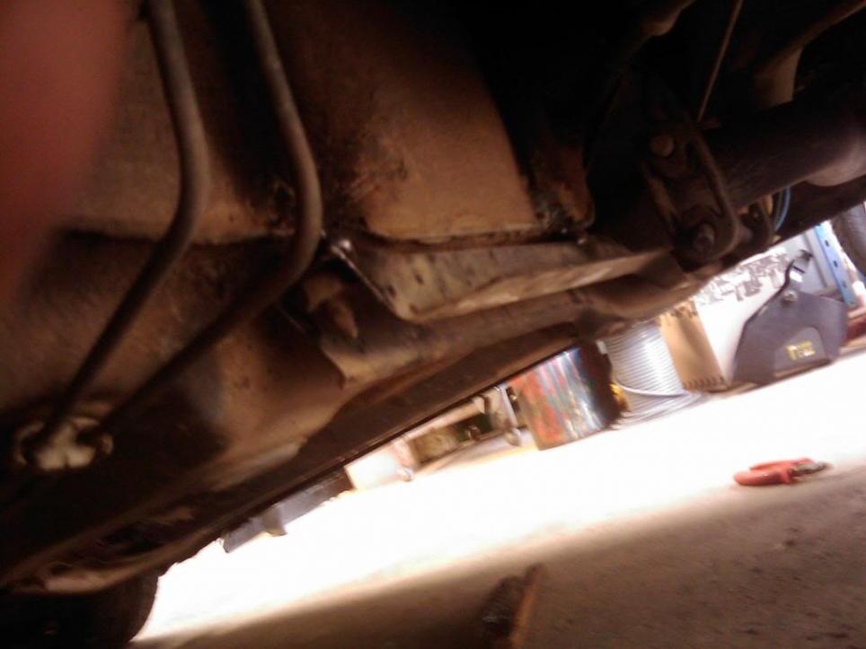

      i stupidly drove strait over the middle of one of the these last week
      it made a large noise
      the damage!!!!!!!!!!!!! it broke the studs right off
      i fixed it after dodgely welding on just temporary until i get it on a hoist

        Pardon my ignorance but what was that stud thing for in the first place?
        • #79
          Looks like one of the middle exhaust braces. I wouldnt worry about that too much since its the rubbers that hold the exhaust up, they are only there if ur rubbers fail and the exhaust droops too much.
