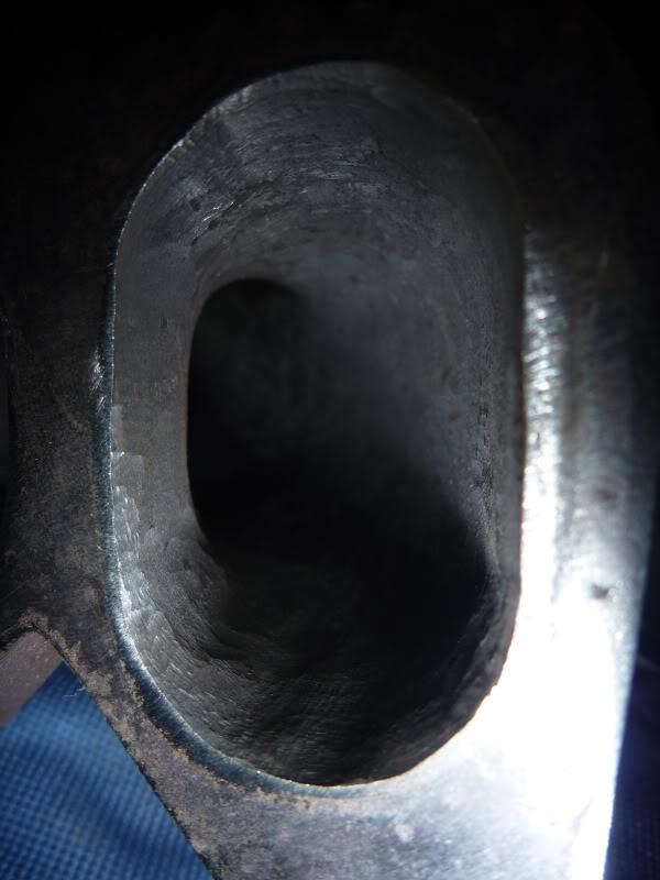

    • a bit of an update, been busy with a spare exhaust manifold and downpipe i bought off loon
      i was inspired from this link
      VWVortex.com - DIY: VR6 Exhaust Manifold and Downpipe Porting (Pic Intensive)
      dont have pics from my exhaust mani before but you can see the difference in the link

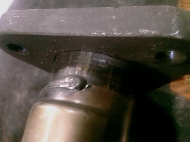

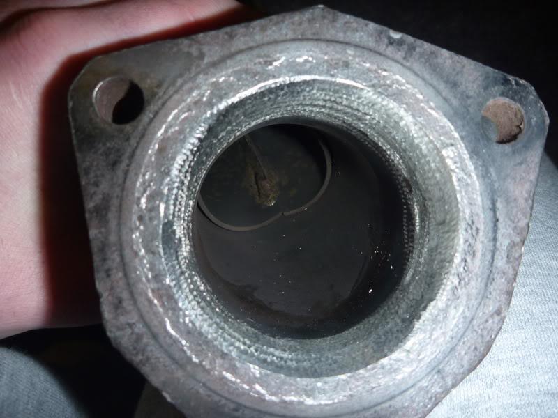

      downpipe cat end before

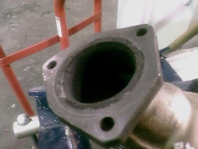

      down pipe cat end after

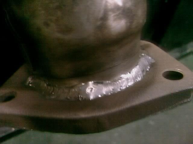

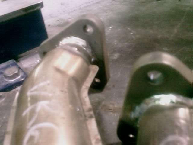

      back welded

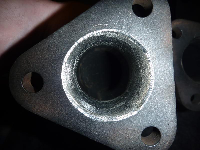

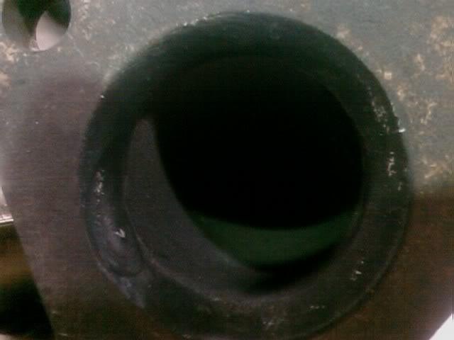

      manifold end before
      back welded

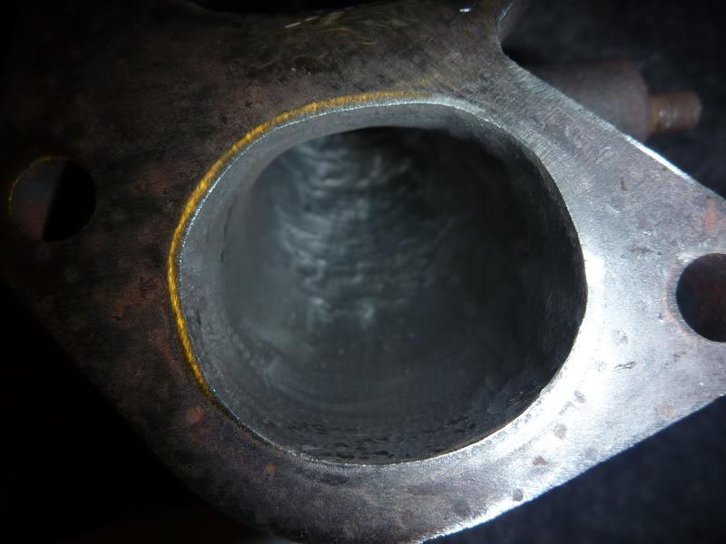

      manifold end after
      bit rough but good enough for me

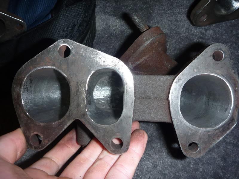

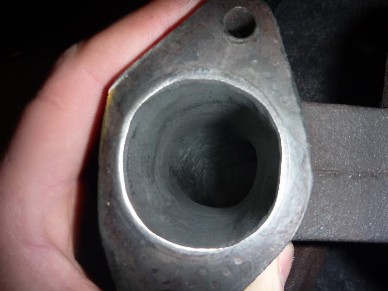

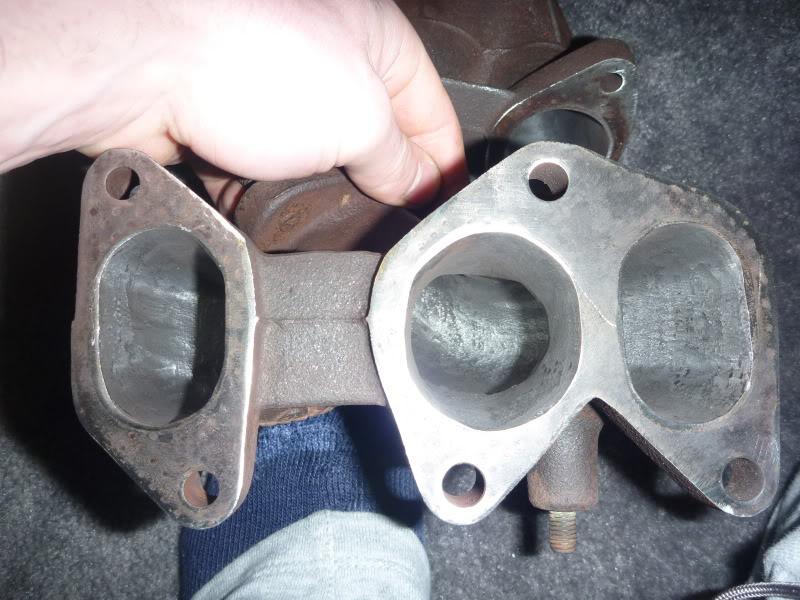

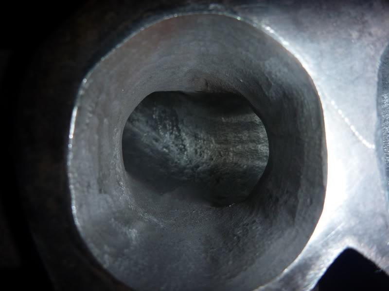

      • all after shots of my manifolds 6 hours of intensive die grinding!!!!

        • Forgive me for the n00bness, but what exactly did you do to the cat pipe? I'm assuming porting but yeah haha....nice job doing ti yourself though! I'd love to get into it
          • Originally posted by Mrk_Mickey View Post
            nothing just the cat end of the downpipe.

            • Nice work Pete, but any improvement?
              • Originally posted by DubSteve View Post
                well see from the butt dyno once i put them on!!!
                only finished them the other day
                im predicting that il be losing some bottom end but gaining alot up top, which is what im lacking in

                  Yeah cool, but your cams with the GIAC tune is what you should be getting top end
                  • i have heaps of acceleration from the 3.94 r and p and my 268 cam profile is good for mid range but top end is a bit flat
                    opening up the exhaust i think will give me more flow at higher revs, hopefully should work out ok
                    just hope i havent taken too much off.
