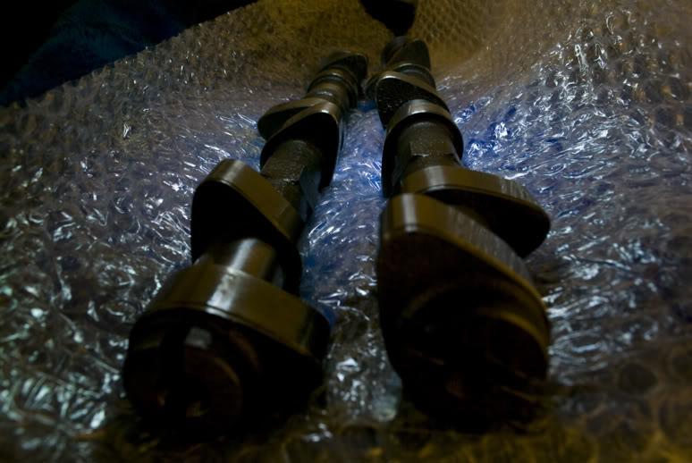

      At last the cams have arrived, I think Cat Cams mill them up per order as it took quite a while for the distributer to get them So now the head is complete! I'll try and get pics tomorrow of the head in all it's glory . . .
      anyway, pic for clicks Yes I tried gettin arty on yo ass's

                          Pretty intense looking lift on those cams man
                          • Mike, i've wanted to spray up that bonnet for a loooooooooooong time man, just never got round to it will do though, i reeeeaaaaaaally need to lose the JDM theme yo
                            Alex! lol, yeh the specs are:
                            Duration : [.1mm+cl] 290deg and [1mm+cl] 249deg
                            Peak angle : 112deg intake and 108deg exhaust
                            Valve lift : 12mm intake and exhaust
                            Lift at tdc : 2.6mm intake and 3.15mm exhaust
                            It is the most extreme we could go without changing to a mechanical vlave train . . .
