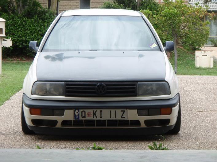

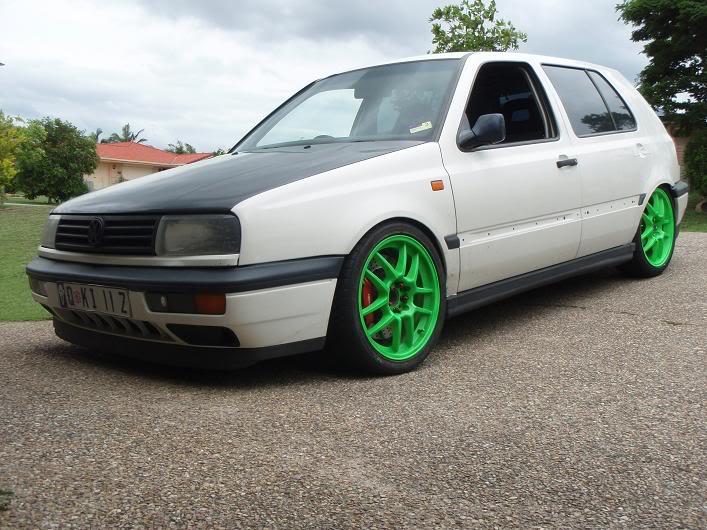

ive been really slack of late as we've been moving house and everything has been a frikin mess up! However! For those who dont know, i own a 94 Golf VR6, white in colour and will be using it for track work
yew!
Things i've done to date issss:
the Vento Front end conversion (off a black vento, hence the black bonnet)
Standard modified stubby mirrors
Hella all red tails
joey modded vento lights
Kamei lower ducts
Hella Fogs

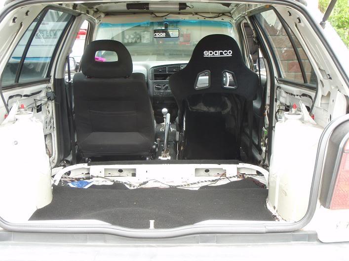

stripped interior, mod plated as a 2seater

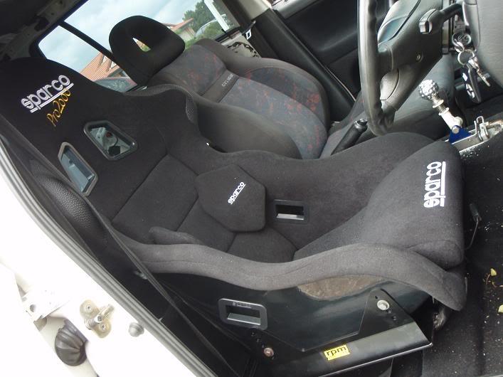

Sparco Pro2000 fixed bucket seat
Willans 6point harness (waiting on the half(full?) cage to be built)
removed flares, arial, rear wiper, badge, side trims and waiting on smoothing and respray

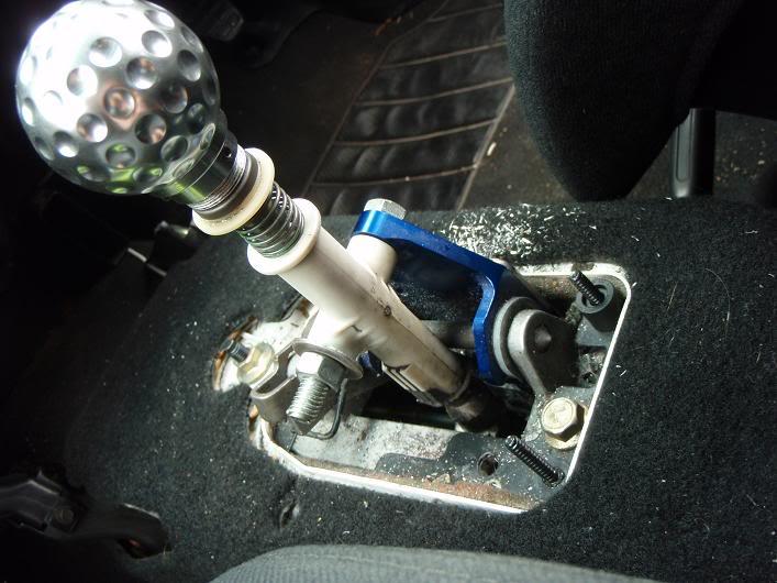

B&M shifter, which had recently fallen apart on me so i had to bolt it (pic attached)

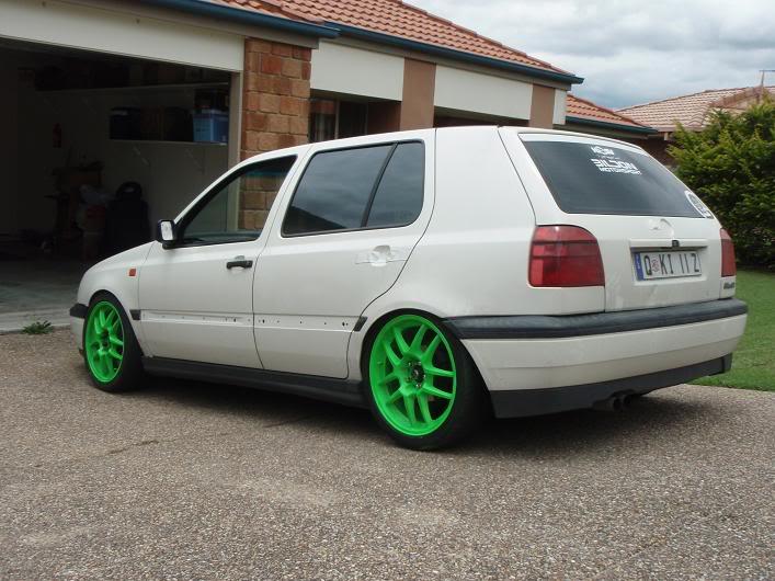

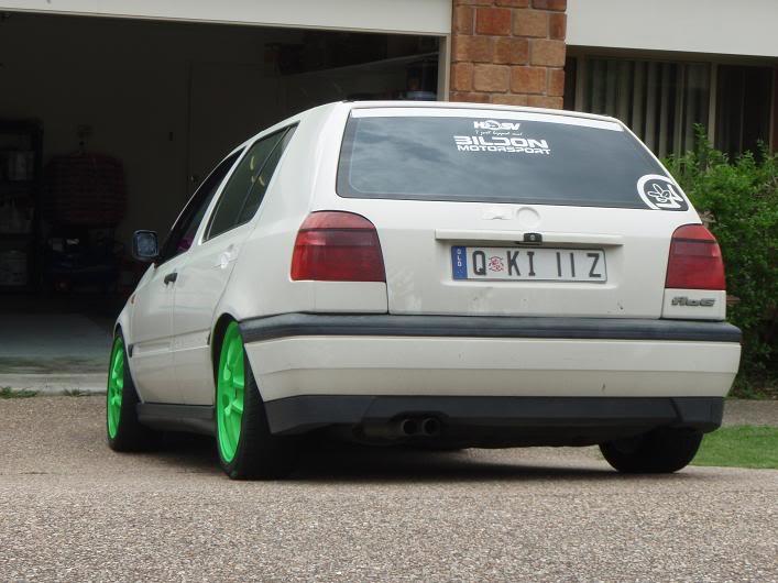

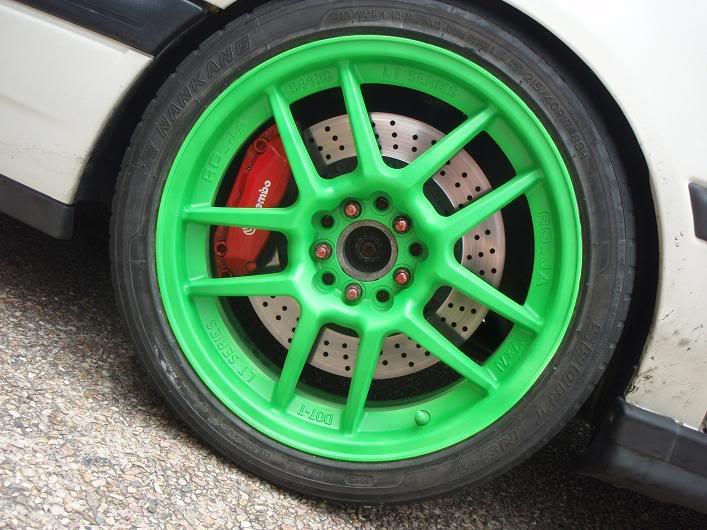

so it was either fluro green or orange
after accidently drifting round a corner i've now softened the rear up fully and set the fronts to half will squirt round to the idustrial estate soonz to try it
