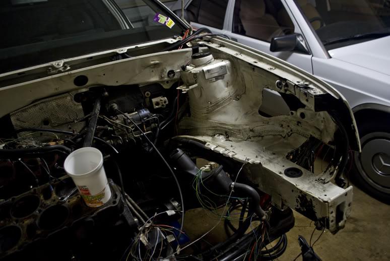

Lot of work going on there, should turn out well though. Remember to give the engine bay a detail before it all goes back in!

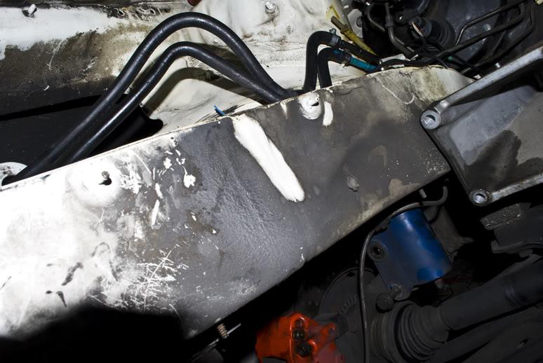

I'd love to have the bay smoothed! but i'm just not sure i want to tackle that either haha, oooooohwee, i might get jack of looking at all that stupid sealant they use and scrape it all off i hope i dont though; I am however thinking i may paint the bay the same colour as my interior? . . . . it'll at least get a clean . . .

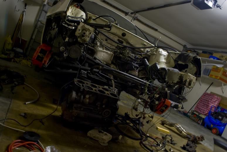

I've also just dropped the bottom end and have handed it over to the shop to strip and then will discuss where to go with that. I've expressed to him that I want to bore out to a 3L with a bump in compression to around 11. But that will all be confirmed later.

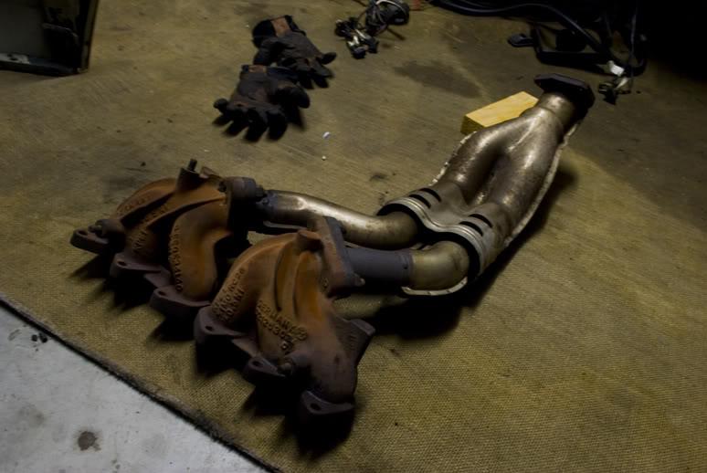

be careful with the extractors matey, the stock ones are said to work best because of the short, long, short, long style of the ports the guy i chatted to recons some people actualy LOST power by going extractors!
apart from the porn factor, your prob better off just doing a downpipe back exhaust!!!! (VR nuts correct me if i'm wrong here, but this is what i picked up from well known local tuner)
