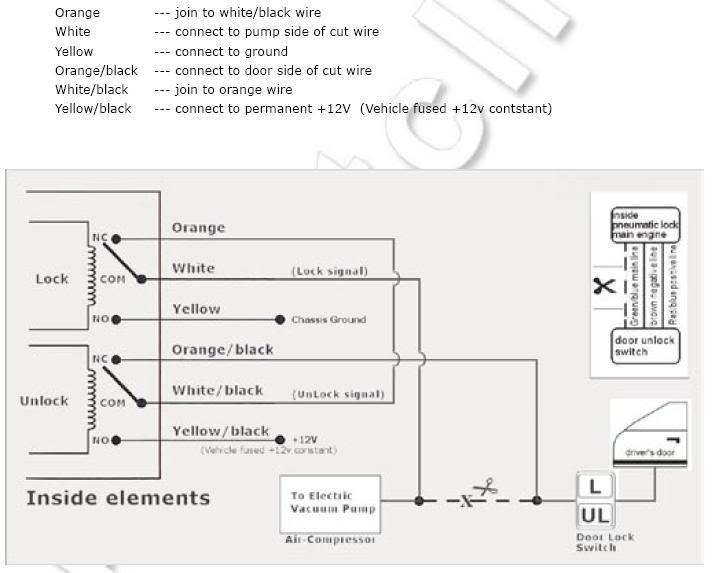

                    stevenYM - welcome to the forums! I bought the same kit (Omega REC43T) as in your link at first, thinking I can follow the instructions straight off and get a fully functioning keyless remote and window closure/opening. I tried wiring it in as shown in the diagrams and I got no response whatsoever. I could've tried more wiring connections to see if I can get it sussed out but at the time I was lacking enough knowledge in electrical schematics (as well as our Mk3 locks), and ended up returning the product.
                    What I have wired in right now is according to this diagram, using the RightClick unit (KE60):
                    The white wire was connected to the black/red wire that leads to the central locking motor in the hatch, whereas the orange/black wire was connected to the black/red wire that leads to the doors.
                    The green wire (12V- 30 second signal) was connected to a relay system to reverse the polarity to 12V+. This was then connected to the grey wire (the lock wire for our cars, as pointed out in other instructions) leading to the doors, while the grey wire leading to the pump was insulated as it was no longer required.
                    Having all that wired in provided me with central lock with window closure and central unlock.
                    So now that I'm thinking back, maybe using the lock/unlock wires in the same fashion as the above schematic could've provided me with a working keyless entry unit, and with the jumper set in the "live pulse for duration of depressed remote button" and the wires tapped into the grey/green lock/unlock wires of the car, I could possibly have total control over window close/open when locking/unlocking the car... but silly me had to return it for a little bit of money back
