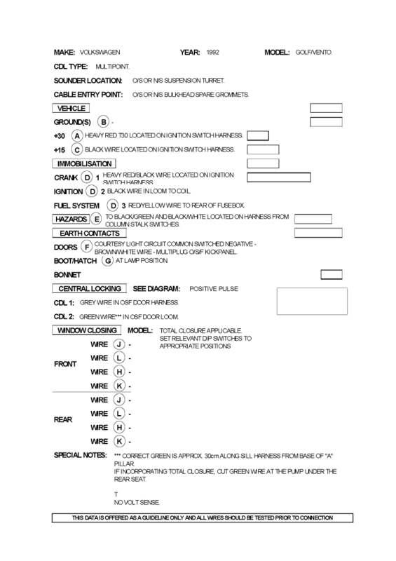

      Hmmm this does sound interesting, i can delete all the stupid door locks and be done with the eccentrics. Let us know how it goes hawk/ray, the wiring looks stupidly easy.
      • #18
        The one I got works, just without the window closing thing. I've got extra pair or rear handles and gonna make them look nice and black before I chuck them on.
        Thanks for the attachment Gavin, though I don't really understand the window closing part of it...
              The total closure needs to be a feature of the standard car. You would just extend the locking pulse of the locking unit.
              You can buy window closers but you would need to wire into to each window motor separately.

                          Got the kit today and I can tell you the fobs looks pretty cheap, the rubber buttons just fall out, mind you that could be by design since it comes with both balck and white parts so a drop of glue and it will be alright. Not as nice as the original, but not bad.
                          The internals looks like that can be made to fit the stock fob, but it will require some trimming/cutting of the ciruit board and the fob itself.
                          But to the fun part. The instructions are vague as very best.
                          I have worked out that the blue and green wires put out +12 and -12 to open and close the doors, but on opening, the doors lock again straight afterwards, not sure why this is happening since there doesn't appear to be a second signal from the remote unit, seems it's the car that wants to stay locked.
                          Does anyone happen to know what the go here is?
                          • #28
                            If you lock your MK3 from the outside and then someone inside the car tries to unlock the car using one of the door pins, the car will unlock but lock again almost immediately. I think this is a security feature of the Mk3... I only found this out when I jokingly locked my son into my car. lol...
                            You could try and find another trigger wire inside the door. I haven't done this but I'm guessing you should be able to use the one connected to the external lock cylinder switch.
                            • #29
                              Problem solved, it's not that red/black wire as in the first post (at least not for me).
                              You can run power from the air pump's plug Pin 1 is 12V pin 3 is ground.
                              Then I hooked up pin 7 and 10 to the +12 and -12v lines I was using earlier. Works a charm, open and close. To be honest I don't know if I could be bothered hooking up the flashing lights thing, the windows I will work on, but it's not on the priority list.
