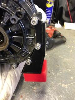

    No bracket mounting points
    [ATTACH=CONFIG]19124[/ATTACH

    I'm confused. You've got 6 bolts there that can be used to hold a bracket so why do you need a different gearbox?
    Any machine shop or decent backyard mechanic could build a bracket to suit in an hour or two. You're not building a race car where weight is important so a strong bracket that's over engineered would be real easy to make.

        I did originally think I would use the bolts and make a bracket but I just assumed using those bolts may interfere with the integrity of the seal, my 020 ended up leaking from the gasket twice so last thing I wanted to do was to play with them and end up with a leak.
        Creating a bracket is not a issue, What the hell, I'll give it a blast and tackle issues it they arise
        Cheers Paul

                This is the bracket you need to make.
                  VR6 gearbox has a different bellhousing to the 02A used on a 4 Cylinder.
                  You cannot bolt a VR6 box to a 4cylinder engine.
                  You can pull the Vr6 box apart for the gears and put it in another 4 cylinder case. Or make a bracket.

                      Thanks for the bracket photo
