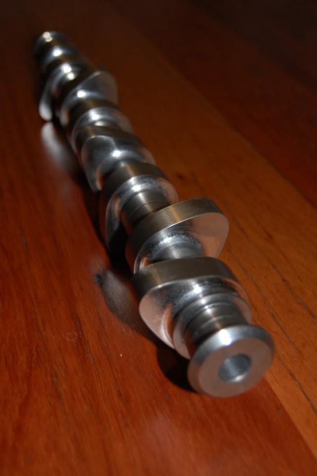

        Billet hollow cam anyone?

          Where did you get that? What grind is it?
          • #95
            The toilet store.

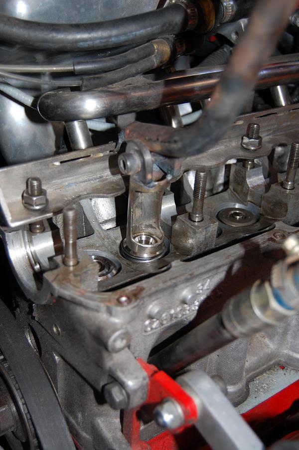

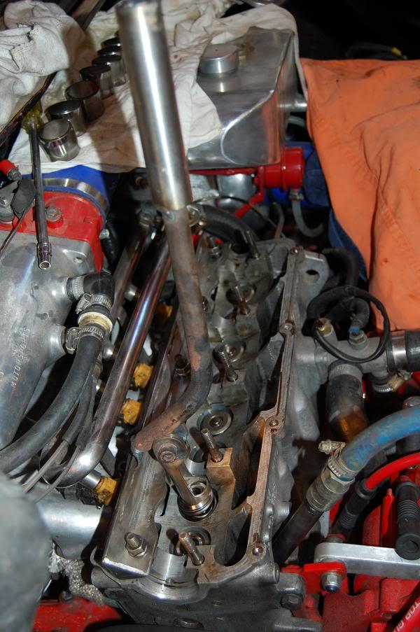

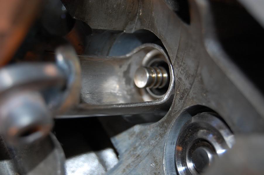

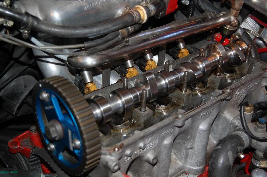

                I made a valve spring compression tool along with a fitting to attach my compressors hose so i could hold the valves up with 150psi and change my spring retainers for titanium ones without the need to remove the head and i also fitted the cam from the toilet store. The air fitting is long enough to do 16v or 20v heads aswell.

                  You didn't need to make a fitting for the compressor. Take out the spark plug and feed in nylon rope until you can't fit in any more. Works just as well.
                  Cheers
                  Paul
                  PS. bloody nice spring compressor though.
