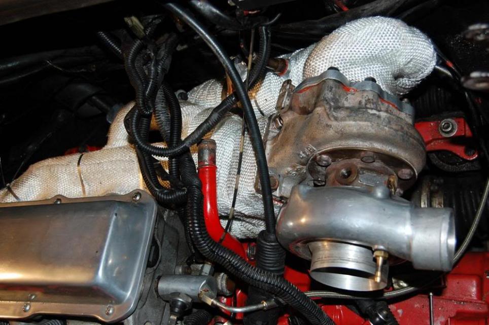

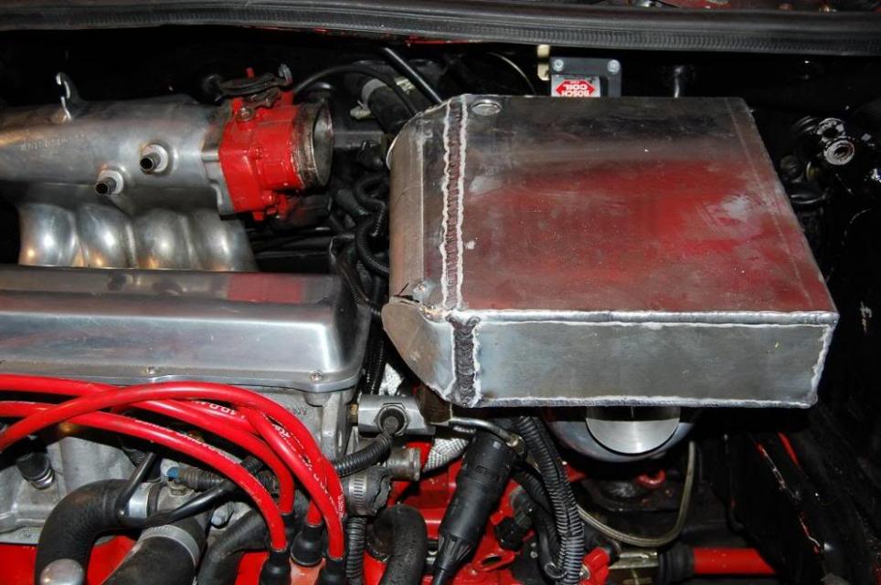

With the turbo in place and onto plumbing the intercooler i cant help but think that replacing the air to air intercooler and plumbing with a water to air intercooler mounted directly above the turbo and striaght into the throttle body is going to be far more efficient.
Not only top end power but also drivabilty and turbo lag would all improve with such a setup....
Even coolant temps would drop without the air flow restriction in front of the radiator. So im going to design and manufacture a water to air intercooler setup.
Pics to follow shortly..
