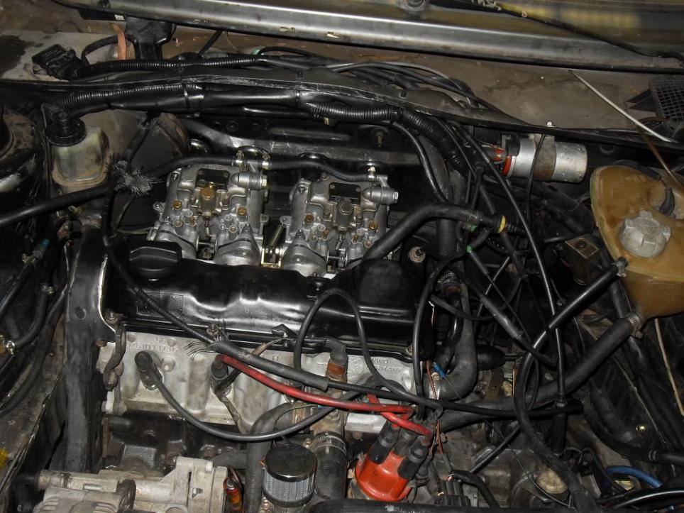

This weeks progress.
Much fettling to get it to fit.
Had to wind down the pressure from the pump, but he kjet pump was still proving too strong.
Now the car is running a Mk3 fuel tank with a CL pump and the pressure is somewhat more manageable.
Tuning this week.sigpic Camden GTI Performance. VW / AUDI Specialists

Re: the fuel pumps. (i'm sure you probably know already but anyways) You may find you need a carby specific fuel pump, as EFI fuel pumps tend to pump more pressure than volume, where as the carbs need more volume than pressure. Like the carbs might only need around 5-10psi (I woudln't imagine it'd need anymore than 10) & the EFI pump would be pumping well over that (unless you've got an adjust regulator) You also might find it'll be more reliable and easier to tune with a proper fuel supply from a carby pump.
HTH
Actually carbies only need about 3 psi, Jarred. They only need enough pressure and volume to fill the float bowl and nothing more.
Looking good, guys.. Cold backfiring and cranky idle here we come! haha.
well there you go, I thought 10psi was probably too much! cheers PreenyOriginally posted by Preen59 View PostActually carbies only need about 3 psi, Jarred. They only need enough pressure and volume to fill the float bowl and nothing more.
Yup, but the 68PSI generated by the kjet pump was a little too much.
The EFI Golf 3 2L pump would have probably been ok to be dialled down by the regulator, but the singlepoint cars, like cordobas and golf cls run an even weaker pump, which is the way we went.sigpic Camden GTI Performance. VW / AUDI Specialists
