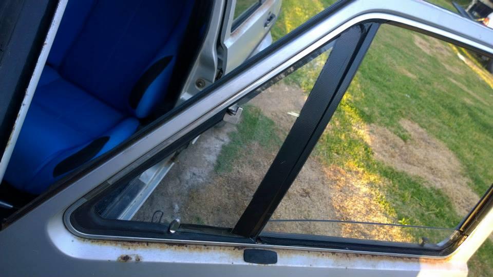

    yesterday was small things... small annoying things... Dad drove it back into town ready for blue slip, the port windows fell out again...
    Tried to glue them up with the rear view type 2 part glue, it failed on all accounts, I dunno what it is with the metal and glass combination, but who knows how the got it to work 40 years ago...
    So some gaffa tape and some wedges will get it thru rego.

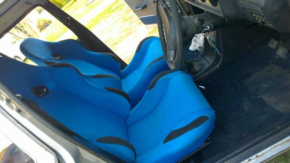

    And the seats are in... Dad is 6ft, and I'm about 6'2" and the bolts on the rails clashed, so we decided to shave them down a bit... well I did 7 of the 8 bolts... dad did 1... and went too far so we couldnt tighten it up, and in his attempts to tighten it, cross threaded it too...
    so he spent the next 2 hrs trying to find a matching bolt, and a matching thread die to clean up his mess...
    *Sigh* parents hey?

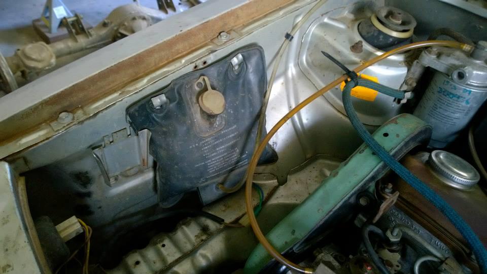

    But can't complain too much, because our washer bottle was leaky and the pump was busted, so he took the bag and pump off our old '76 civic wagon paddock basher and it works!

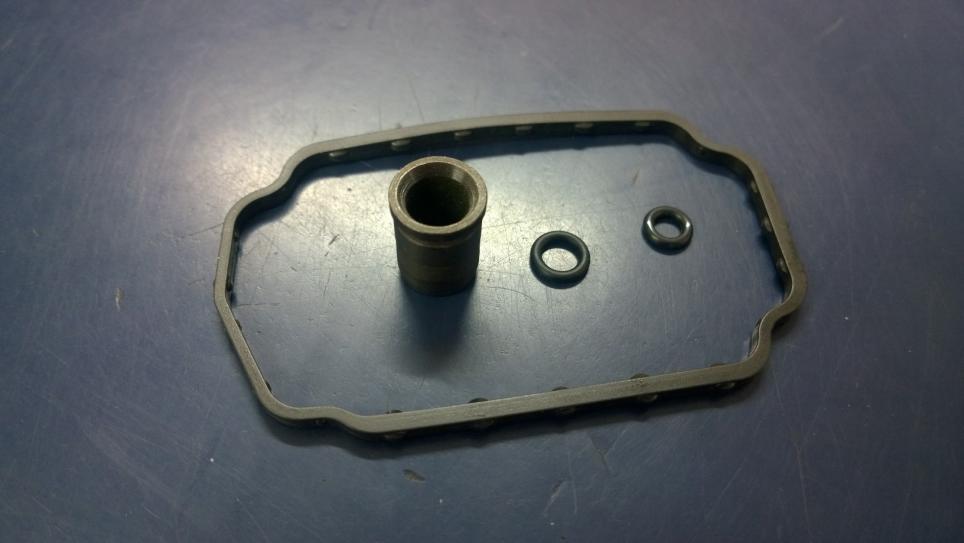

                    Always great when your local deisel place has pump parts in stock!
                    Gotta sort a leak on the throttle shaft...
