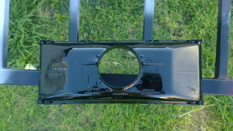

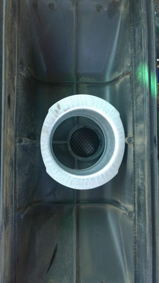

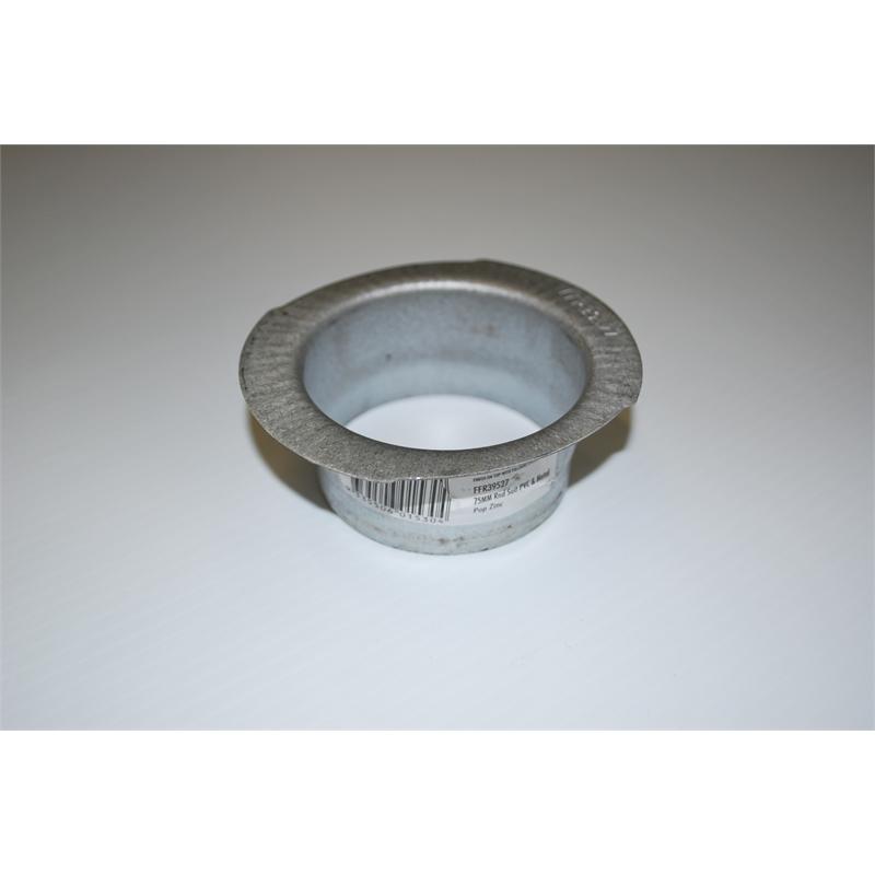

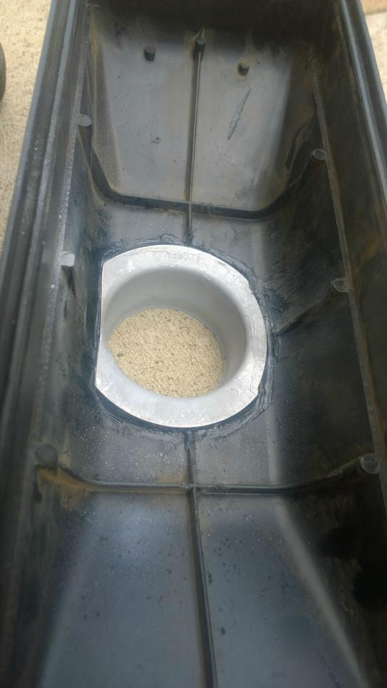

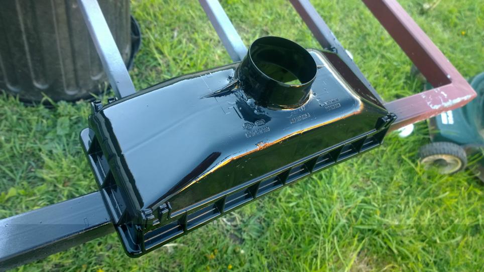

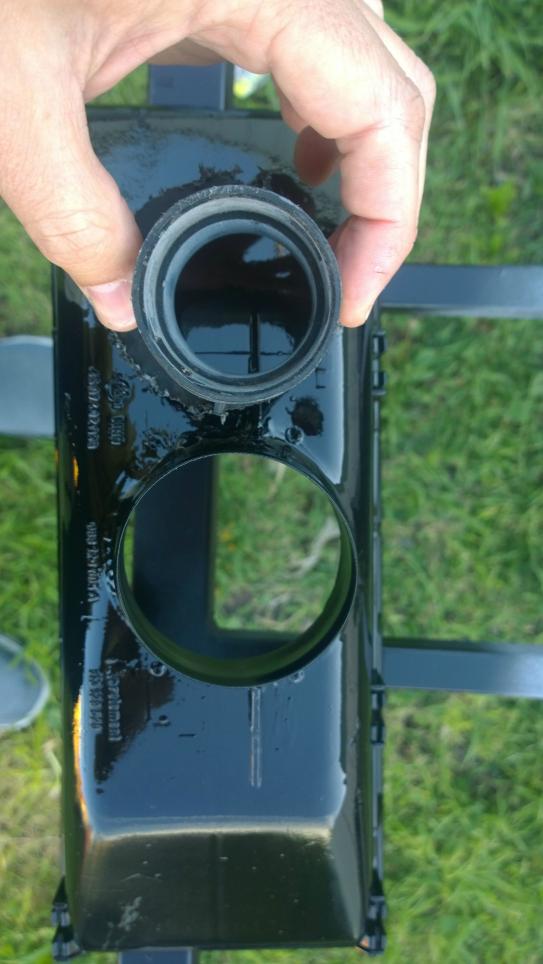

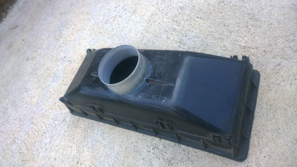

                          Mucked around with upping the size of the intake on the original airbox lid today...
                          75mm gutter flashing from bunnings - $2.50
                          5 mins with a drill, a few mins sanding and cleaning up, a smear of silicone, some pop rivets for added security, and a lick of satin black (still wet in pics) and the intake is ready for some sort of modded breather hose.
                          now for some kind of snorkel...

                            • #44
                              back in the day I plumbed 90mm PVC from the airbox down the just behind the grill. Might have got me another 0.3hp I reckon too . It does make a really loud and beasty sounding intake noise with a big pipe on there though.

                              • #45
                                I slapped it on and it just clears the tappet cover, probably just have to shorten up the pipe a bit more, we're probably going to run it to the passenger side rain tray, with a small pod tucked in there - it will act as an initial filter for the heftier stuff on dirt roads, and mean that if we do a water crossing that's a bit deep, we should be safe from water.
